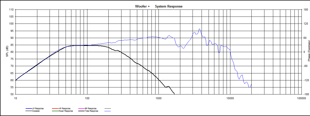

A passive filter solution would have looked like this for a single woofer and a PR. I have observed it from the pictures and it looks as it was a Dayton Audio SD 270 so I've simulated it tuned to Fb=30 Hz (22 g additional weight) in a 55 lit box and added an RCL to smooth the impedance peak of the woofer with a simple 2nd order LP. The end result is F3/F6/F10 43/33/26 Hz. That is as good as it gets with this combination. Impedance is steady at 5 ohms.

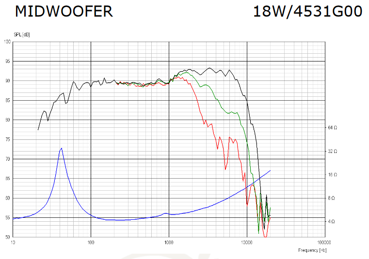

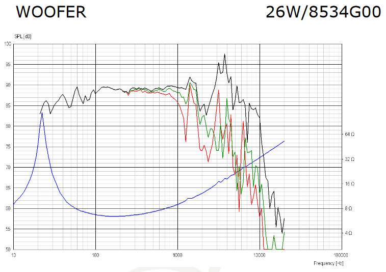

This apparently is what we have:
Scanspeak
R2904-700000 tweeter-4
18W/4531G00 midrange-4
26W/8534G00-8

Let's get focussed here. A Qts=0.40 bass driver looks OK in 55L closed box to me.
The 90dB Le 0.9mH 10" bass is actually something I wouldn't touch with a bargepole. A metal driver. All that breakup to deal with! You can see it!
The 90dB Le 0.3mH 6-7" mid is quite flat and gentle in response. If it was 8 ohms I would love it.
Tweeter, as I said, is not ideal here for the necessary low crossover with 6-7" mid around 2.5-2.8kHz.
Unless we see the crossover, there is no point of departure here to rescue this speaker. IMO, half the skill of a good speaker is selecting drive units that play nicely together. I do think a gutsier tweeter like a SB acoustics that can dig low might let everything fall into place here.

Your first mistake was getting a 6" 4 ohm midrange, which will cause some severe low impedance issues.
@system7: How does that happen? I have read it before, but don't understand why. I want to do the same thing to match sensitivity of 8R woofer and 4R tweeter. Thank you, Rich
Steve is usually not given to hyperbole, but in this case he has left me scratching my head too. I have that 6.5" driver. Minimum impedance was 4 Ohms. That's fine.
The 4 Ohm mid-woofer is 3 dB more sensitive than the 8 Ohm counterpart so you'll probably have to pad the tweeter down less than you would otherwise. This is overall a good thing, but of course, this is a three way..... so at the end of the day all 3 drivers must match in terms of sensitivity.
There's no reason to match impedance of your drivers so long as your final result is an amplifier friendly load. The 18W/4531 is fine.

The 6.5" is a head scratcher, but not killer. I'm pretty confident I could make it work well! But I wouldn't have started with it, as it requires more of the tweet.

Just FYI, I have a couple of designs with the mid-woofer, 18W/4531 and some pretty pricey tweets.
One real, one virtual as I relied on a vendor's tweeter data but never built it.
I was able to cross this over up to around 1.8kHz fairly easily. With a notch filter it could probably go up to 2 kHz.
