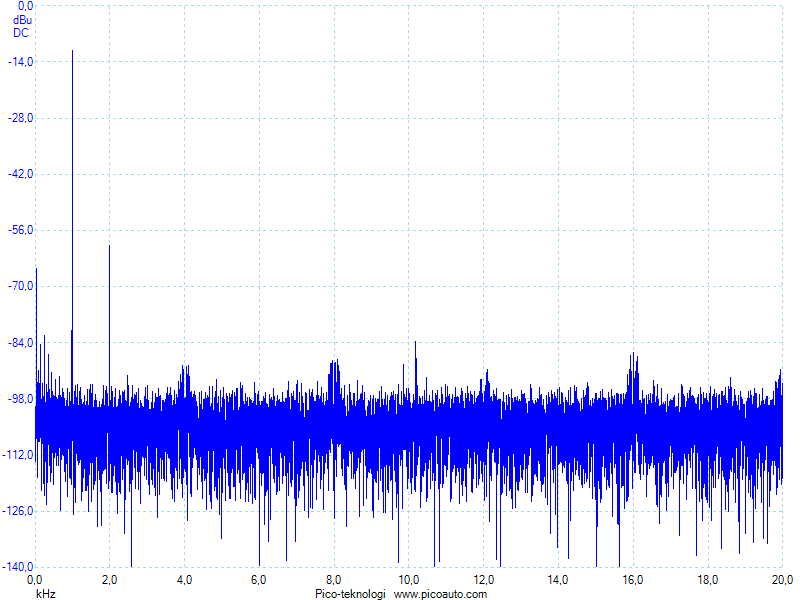

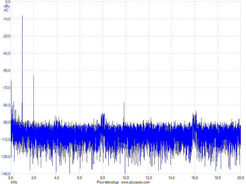

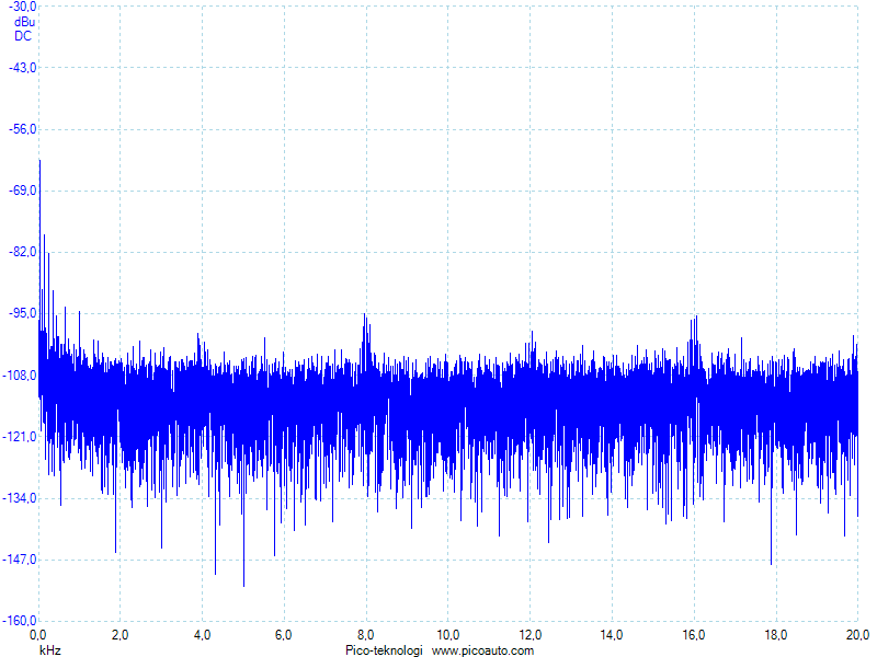

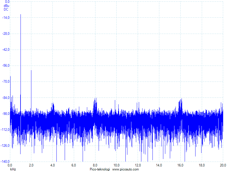

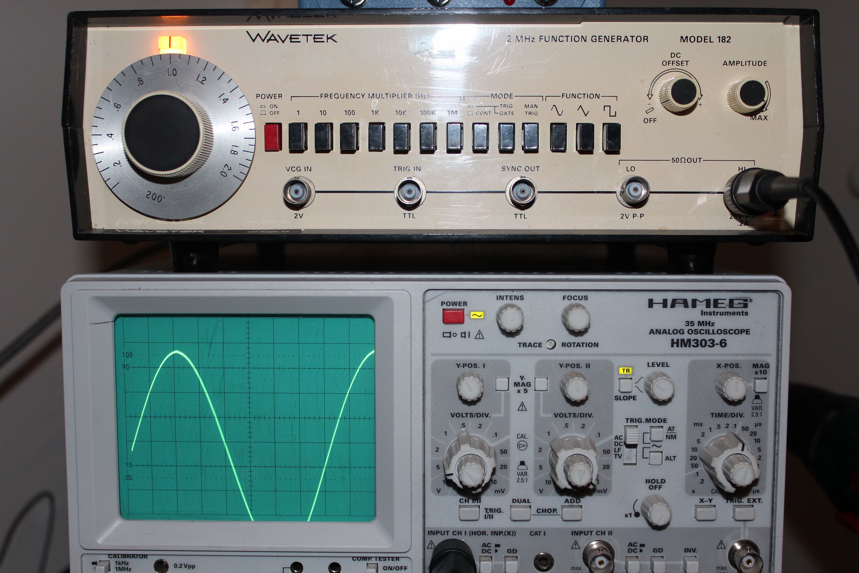

and heres a pic to:)

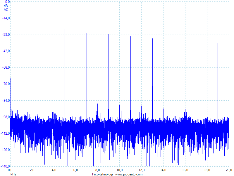

Joined 2011

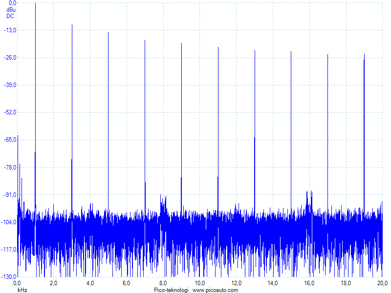

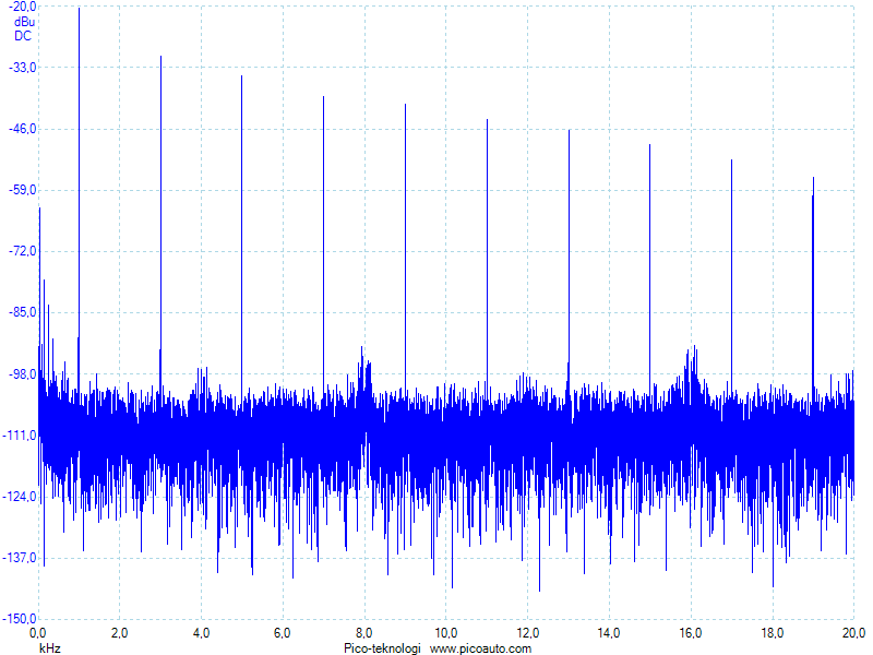

Here is gen probe on RCA in and measuring probe on 100k load. Zero pot, half pot and full pot. 1 kHz start frequency, 1 V in. I guess that the repeats at 3, 5, 7 etc are harmonics. DMM reads 0,003 V, 0,066V and 0,812 V over those.
