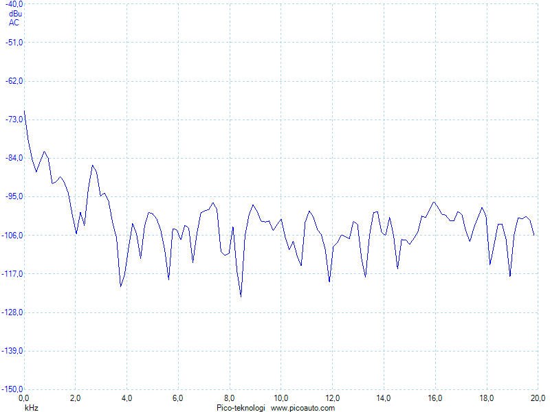

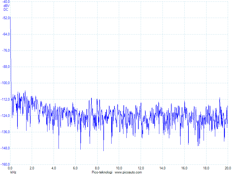

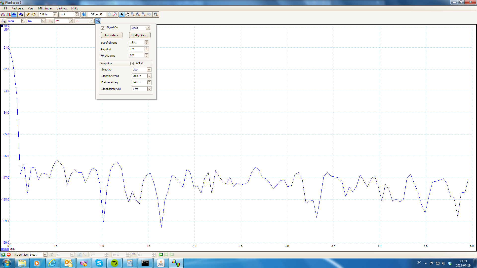

New spectrum measures over 100k load.

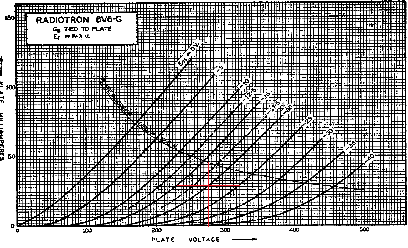

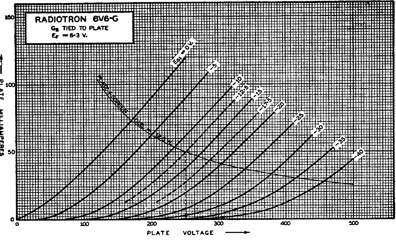

Radiotron has a somewhat better paper then RCA with bigger curves (accuracy I have no clue). I printscreened them and did some plots in my tubes working. They run 20,1 bias at 274 V. Heres my loadline, almost superlinear (100 pixels in each direction +/- 5 v)
Ill post an empty one to if you guys are up to paint and loadlines:p

Elvis is asleep so tell me if you want me to do some other measures. The Mighty One asked for some clipping level. How do I measure that with my excellent tools?:)
You drive out of the Wavetek a sinewave (1kHz is OK, probe 1x) to pre in and you scope the pre's output on the Hameg. You start low on the Wavetek output knob and you wind it up until you see the sinewave start chopping off to flat top. Then you back down just a hair before the clipping. You read the screen divisions times the V/div switch. Then you state to Zen Mod "That X voltage is my max VPP".
