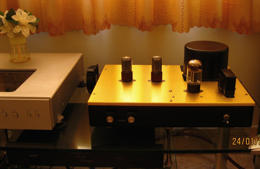

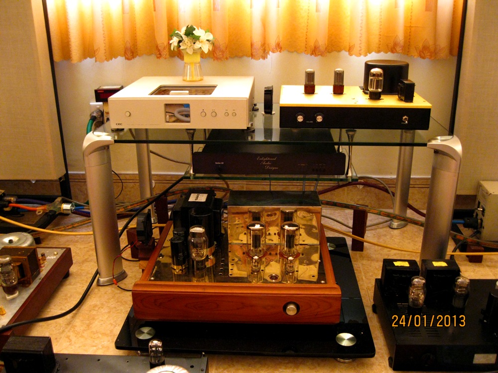

Hi all,
I've just built 6V6 pre for my friend. Here are some pics. Sound is very good on mid, bass and rich tone.
My schema is based on Salas' one, but I use AC filament with hang of 40Vdc. PSU is with 5V4 tube, CLCRCLC for separate chanel. No hum AC, but I have some hizz on one chanel. I think it's tube noise.

Good looks. Did you take any anti microphonic measures? Its the common cathode 15dB gain circuit yes?

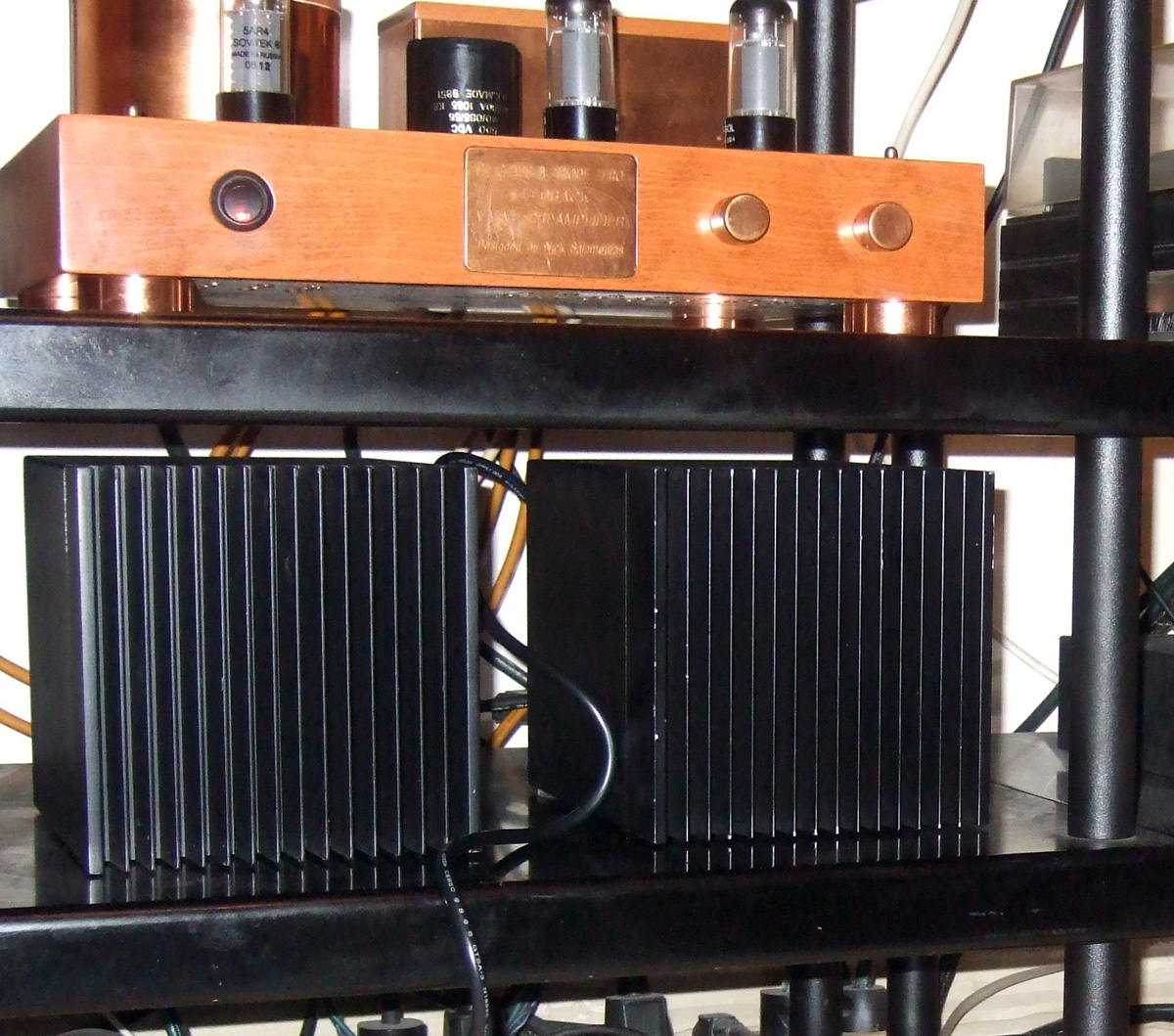

Nice Salas. I had kids here today so it was more Minecrafting then soldering but I made those:
The hawkeyed can see that it has the same screwhole placement as SSHV2, so I can interchange them. The cap-thingy will become an R-C then.
I also did some quick voltage measurement and I ended up between 245 and 310 V B+ with 2,2-6,6 k as last R. That puts the bias to between 16,6 to 21 V which might put me in a strange little corner on the curves. Maybe a 680 DCR LL1660 would be more suitable.
Then I'm stuck with a strange groundnoice. I rewired stargrounding without results. DC-filaments and more smoothing C dont affect it.
Well, one's got to save some for the day after...
Staffan
Joined 2011
Is there a possibility something oscillates there? What does the scope show?
Thats possible. Usually that takes us to motorboating but i can easily swap the filterchoke to a resistor and see if it there. I could also rig the scope. Its downhill skiing on the agenda tomorrow so lets see what it brings.
I changed last RC and also second C a couple of times so it shouldnt be there . And its overkill 1 k carbons on the grids. But you never know with chokes and capacitors.
