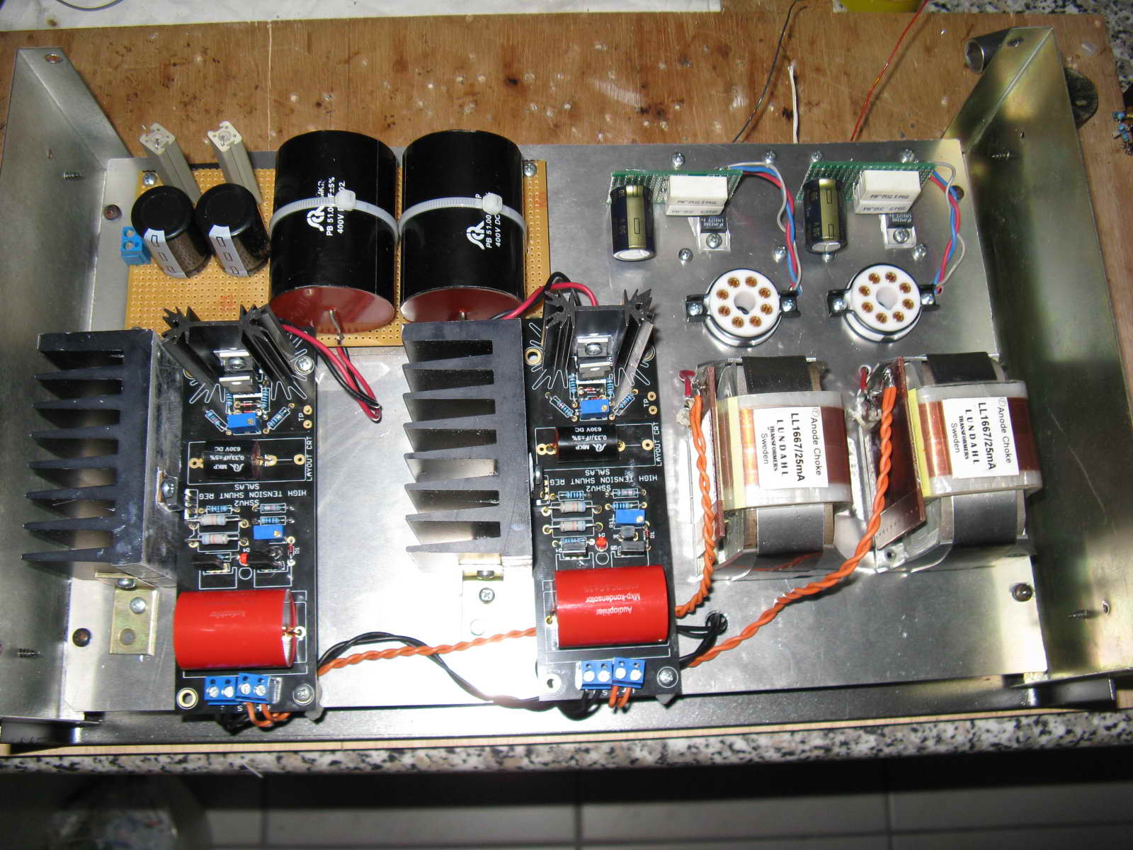

Just a quick update here. I whined over hum last time which was pretty childish of since I obviously cant build a proper PSU. I just putted something together that looks like any other preamp PSU i have done b4. I forgot to put in the fact that this pre takes more then 5 times more current that a normal one. As I had the scope up is measured almost 350 mV ripple on B+. The waves was exactly 20 ms (50 Hz) so there was not much to say. Unsufficient filtering.
So I got violent and squeezed in 2 old tube radio OPTs instead of the former 6K8 resistor.
Theyr about 11-12 H each on the primary and serves one channel each.
Ripple went down to around 2 mV which I can hear on my 99 dB speakers, but then I have to have ny ear in the cone. Otherwise I dared to play half a song and it rocked. I didnt want to shockride it to much since I had some 360 volts on the anodes.
So, there is hope.
And then I spoke to mr Per Lundahl today and he is more then happy to make me some http://www.lundahl.se/pdf/1667_68.pdf special gapped to 50 mA. I think a DCR of 680 is to prefer over my Hinchleys almost 1 k.
I will tweak on and listen some more before I decide.

Don't be so quick to blame it on the psu. 50Hz/60Hz hum can be the result of wiring or component location (near transformer) or transformer orientation. The grounding scheme makes a huge difference as well.
Your right Iko. I was refering to that I thought it was oscillation between the chokes and the output caps, wich would have been more irritating.
The measure above is from spagetti cabling, everything unshielded and with iron tweaked in here and there as you see. I can clearly just get better with some proper layout work.
best regards
Staffan
