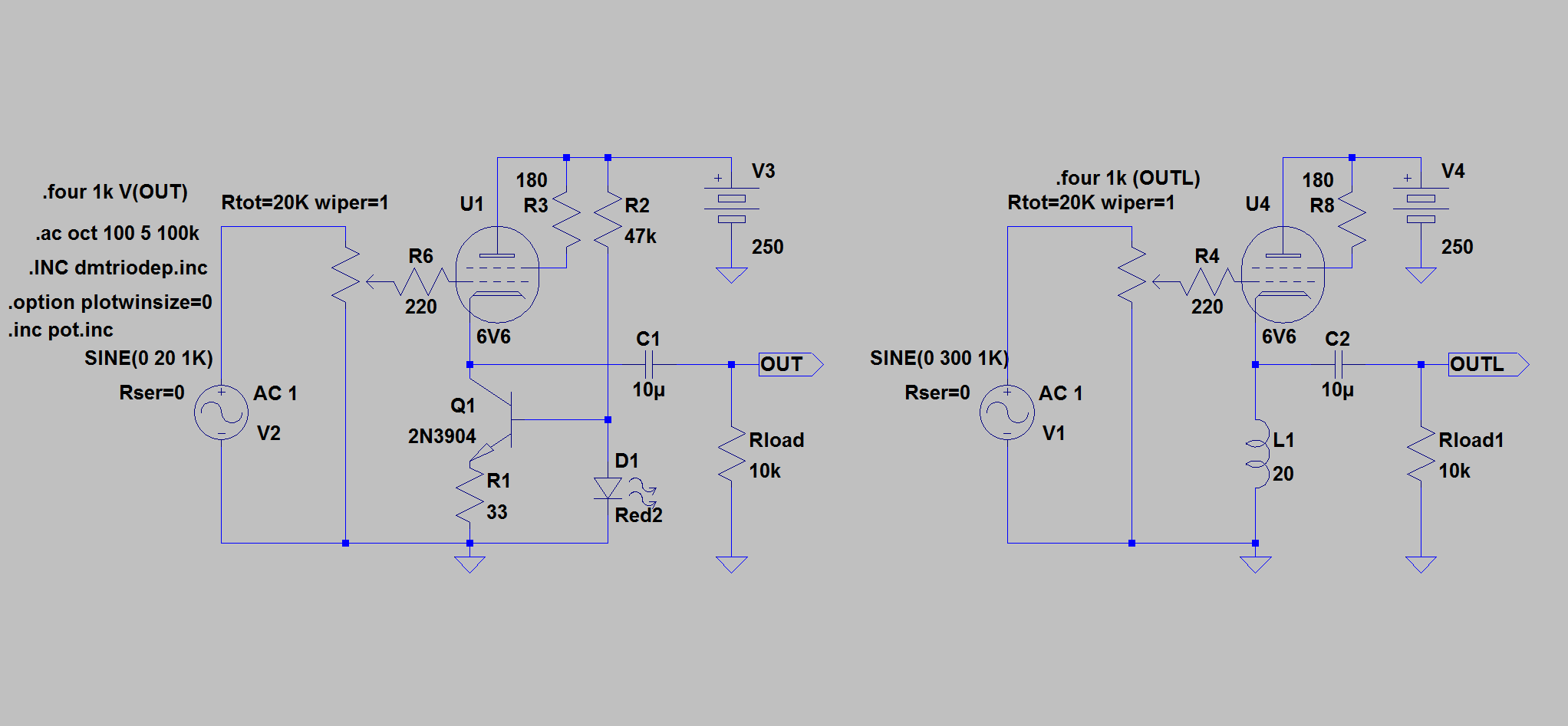

Hey Salas,
Why make such a unecessary overpopulated design with yet another sound-degrading cap at the input.
As Ug is high a CCS is enough with grid related to ground. If more swing is need, as the CCS-version clips at the negative side at maybe 10Vrms, a choke with suitable DCR should be used. If no standard choke is available, I guess Dave Slagle will easily build one. If one have a choke with lower DCR than needed only a small, added series-resistor is needed.
In my example Ia is 30mA and choke DCR 500ohm. 20H gives -3dB at 5Hz. I would go for 50H.

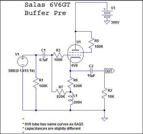

I like the non BJT aided bootstrap subjectively, with Teflon cap I could not feel it bit more opaque.

For practical reasons I use pot_lin. Do you also need asy´s?
Off course you should avoid the sand-version! But not everyone can afford a good choke.
Still bootstrap with input cap has no meaning at all with the correct choke. Overpopulated ;-)!

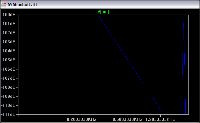

About distortion noone need to worry as 2nd will be in the ballpark -90dB at a realistic 2Vrms input/output.

Well I choosed to make a "livingroom proto" instead since I have kids running around. I'm always nervous mounting touchable HV stuff in the livingroom. I made it like a AZ1 - 30 uF motorrun - 10H - 50 uF motorrun common chassie and then I made some plates to fit for different configs.
First out is the 6V6 chokeloaded CF. It sticks a 2,2R and double 47 uF for each channel. Abour 255 on the anode.
It playes right now and it has a clearly stiffer bass then my former passive. Nice voices too but still a hum and some other disturbances. 99 dB speakers is not nice to me. I will clear up the hum and get back to you with some measurements once I get sober. It will happen any month now.
Best
Staffan
