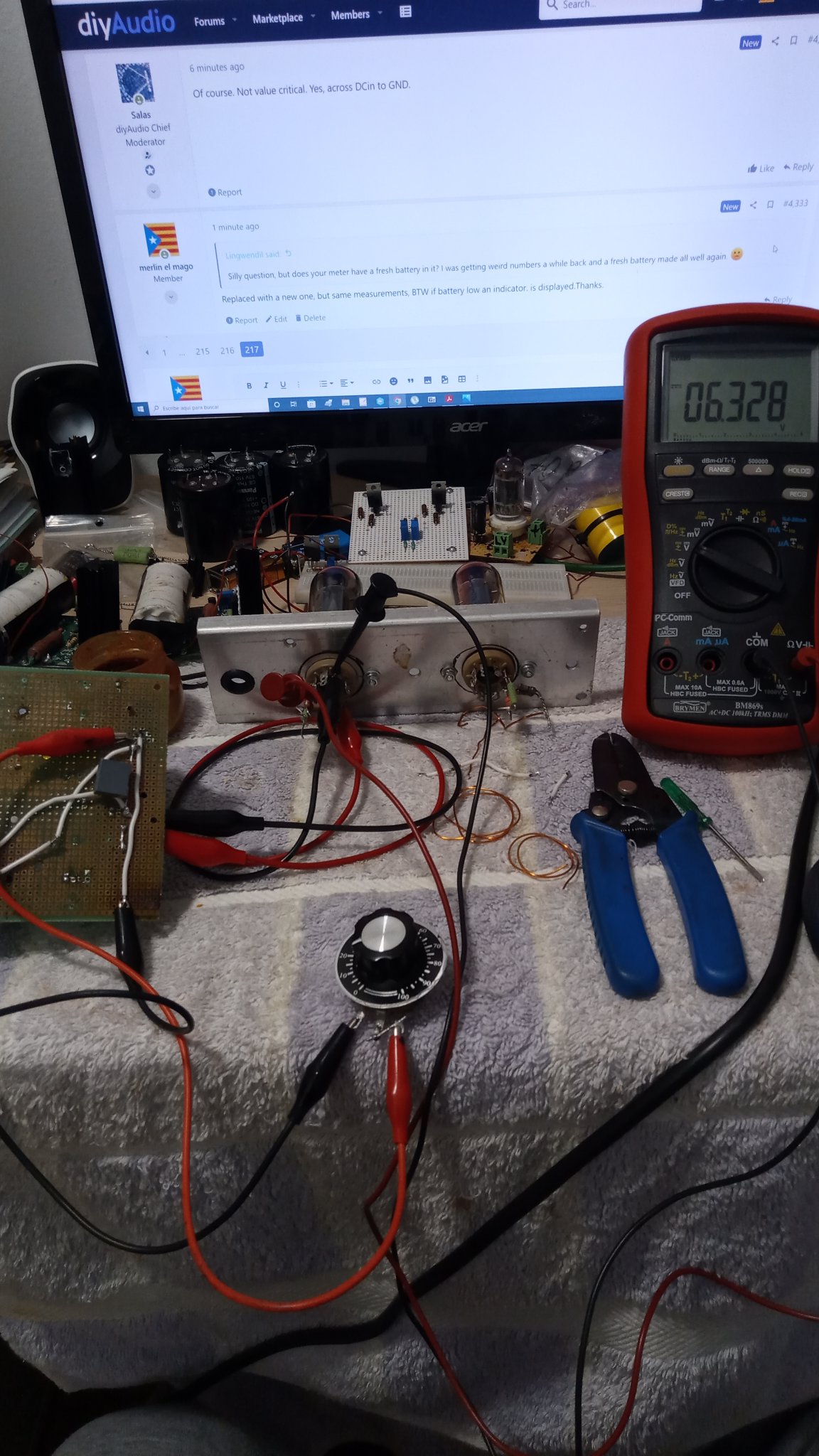

I see 3.3R // 22R // 100R for Rset in mine, so 2.79R fine tune. You could put 2.8R 5W or your 3R high power rheostat. But is it connected as it should, and is its wiper OK?
