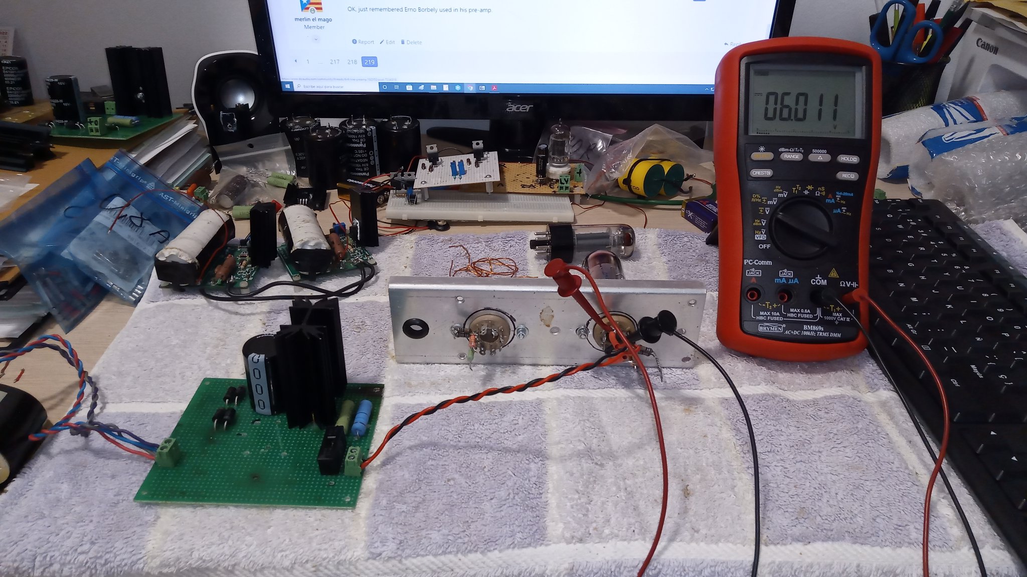

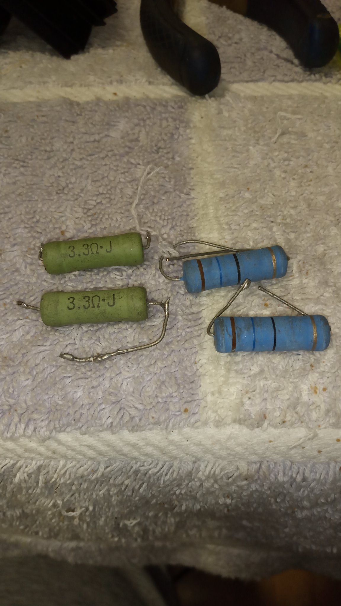

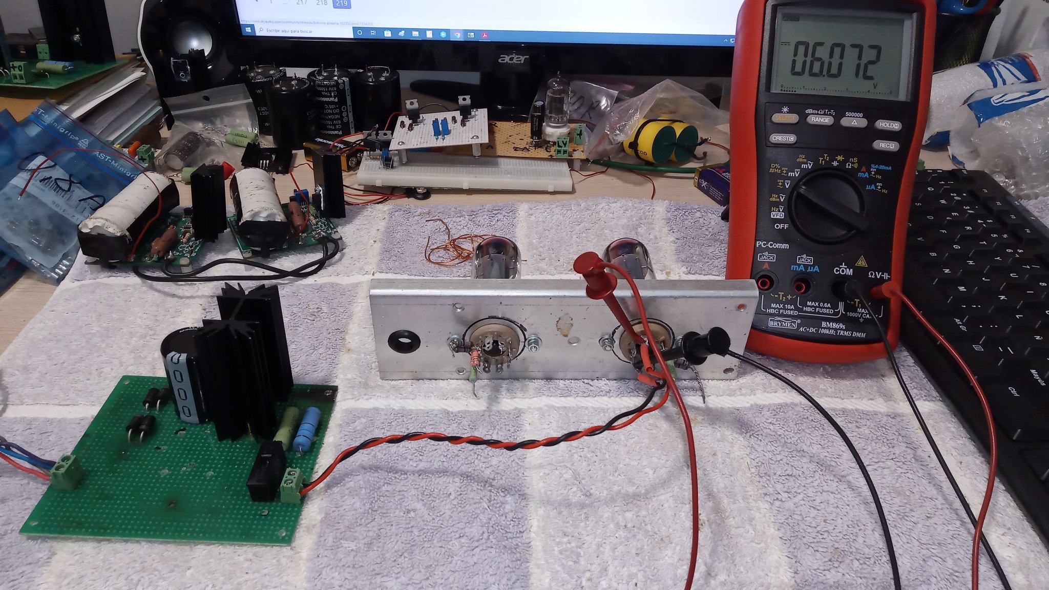

I have 5W each

During this time you don't have the power amp on because the 6V6 stage is stabilizing. And you turn off the power amp first during system shut down. Alternatively you use 1 minute or more on time delay / fast off 6V6 line signal output relay system.
