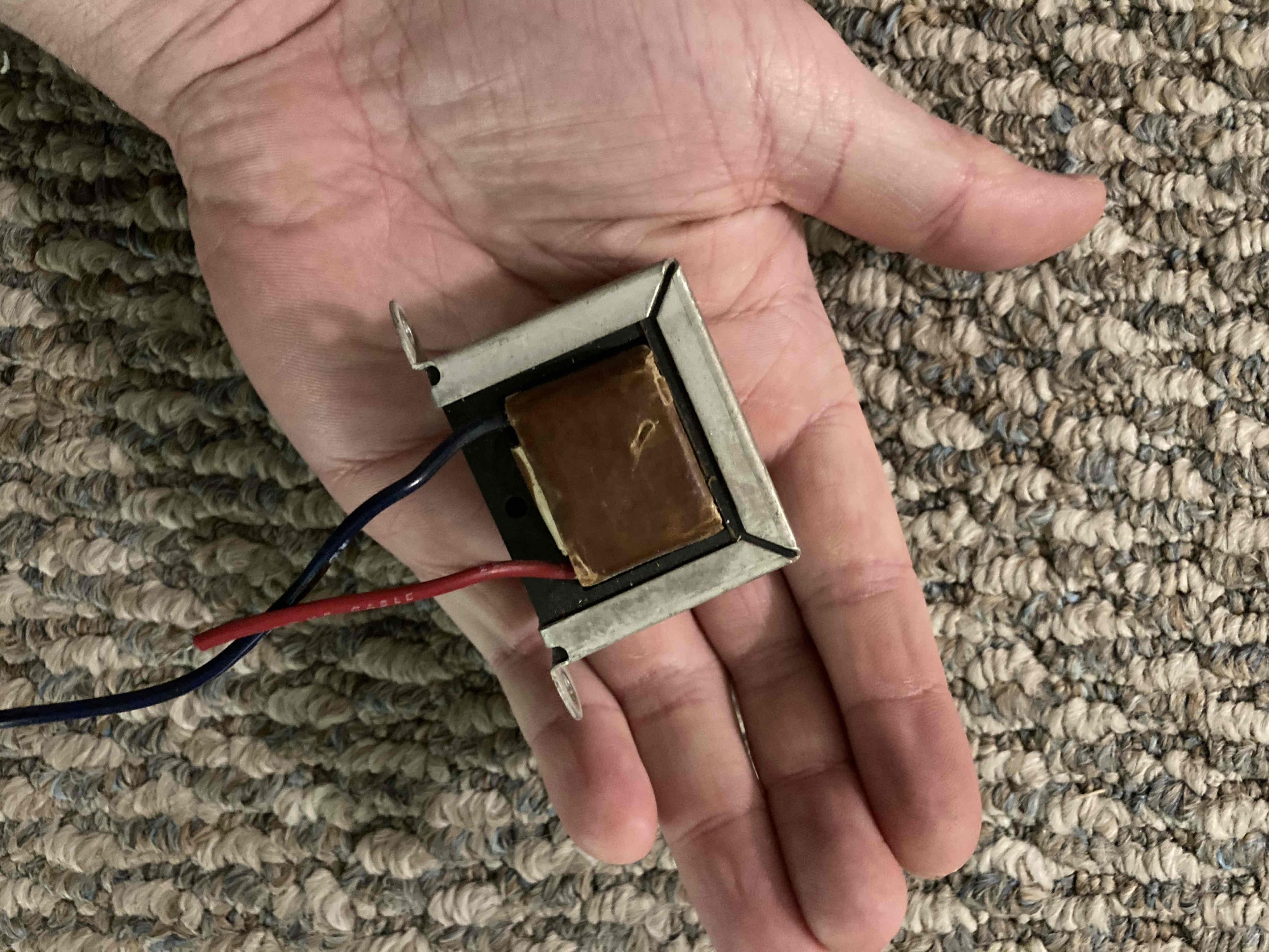

So taking all the parts out of the closet and do some research I found that there were some variations of L-100. The choke is 500r and kinda small in my case. I have no idea how to check the inductance and max current...
The power transformer is 330-0-330 with no load. So that should be fine. Also I have the PSU board from the Aikido seating around with regulated separate filament supplies and Mida HV section. So basically only thing is holding me are tubes and figuring if the choke I have works. Any ideas how I can check it?
Doesn't have a type number to look it up? It takes an LCR meter to know the inductance. At 500Ω it does not seem to be a heavy current part for a big amp but for a preamp it should suffice.
Only LCR meeter I have is the driver tester DATS and it doesn't go that high, who would think, google helped! Thank you hehe.
AO-24159-0 549-6621: 10H - 75mA - 500 ohm Should be ok in terms of max current, right?

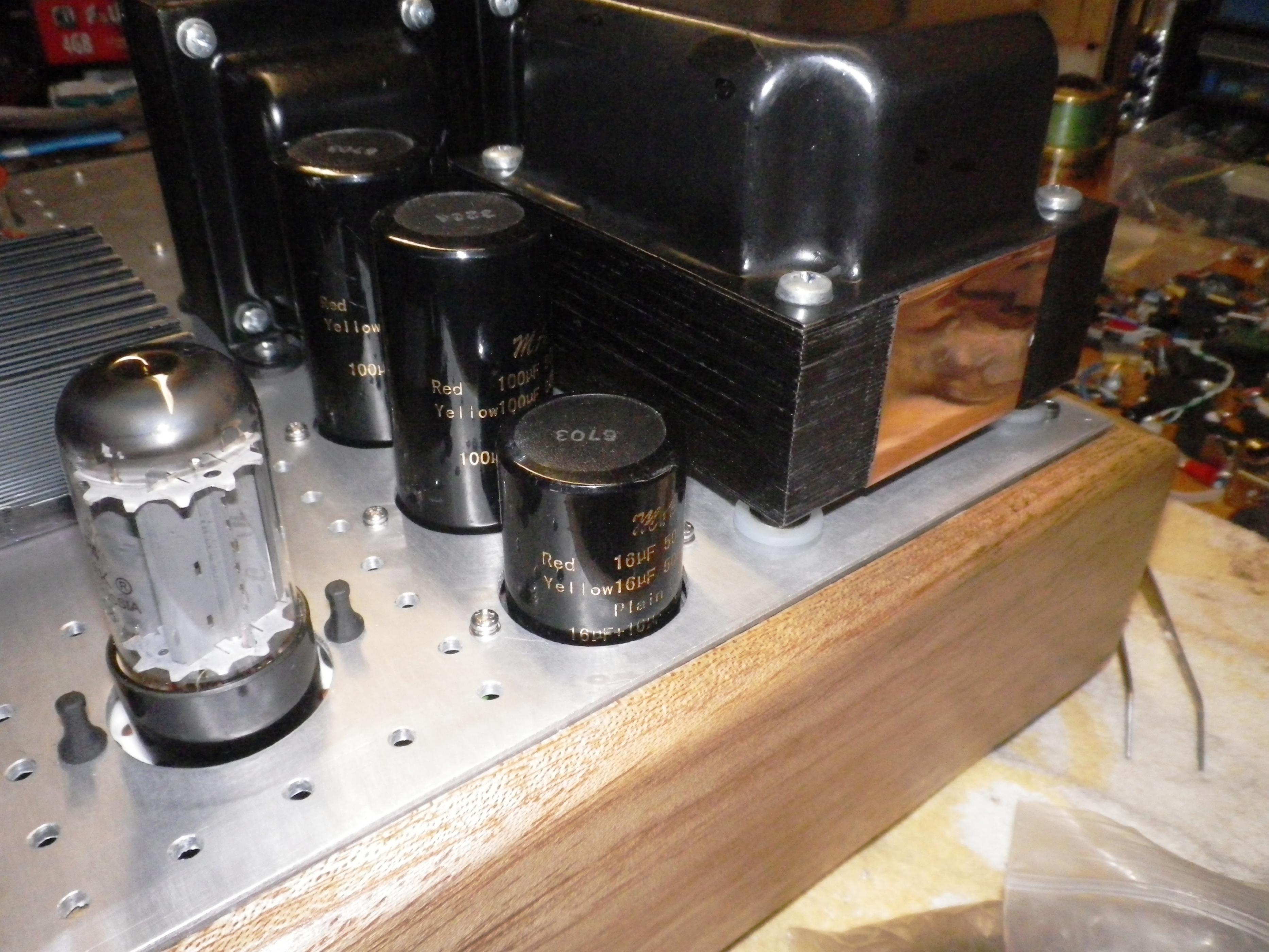

I've already got some rubber decoupling mounts installed on the sockets, so just eeking out some incremental improvements, and some curiosity driving.
Just ordered a pair of metal 6V6's- not terribly expensive so worth a try. Will report back!

look how i reduce microphonic with fan elastic mounting
6V6 line preamp
Your schematics suggests 220R in total, and arrangement should be RCLC, will CLC with 500R work, or I still will need to add a resistor before the first cap?
The mA rating is enough. About total R you will see in combination with your transformer and rectifier tube. If the whole thing goes unnecessarily high for rectified DC under load you may add extra R.
Hi nikosokey, thanks for the link. Looks great! I actually already have the mechanical isolators installed that I linked to and they work great. I can hammer on the chassis, and no sound in the speakers
Your solution looks like it works well too.
