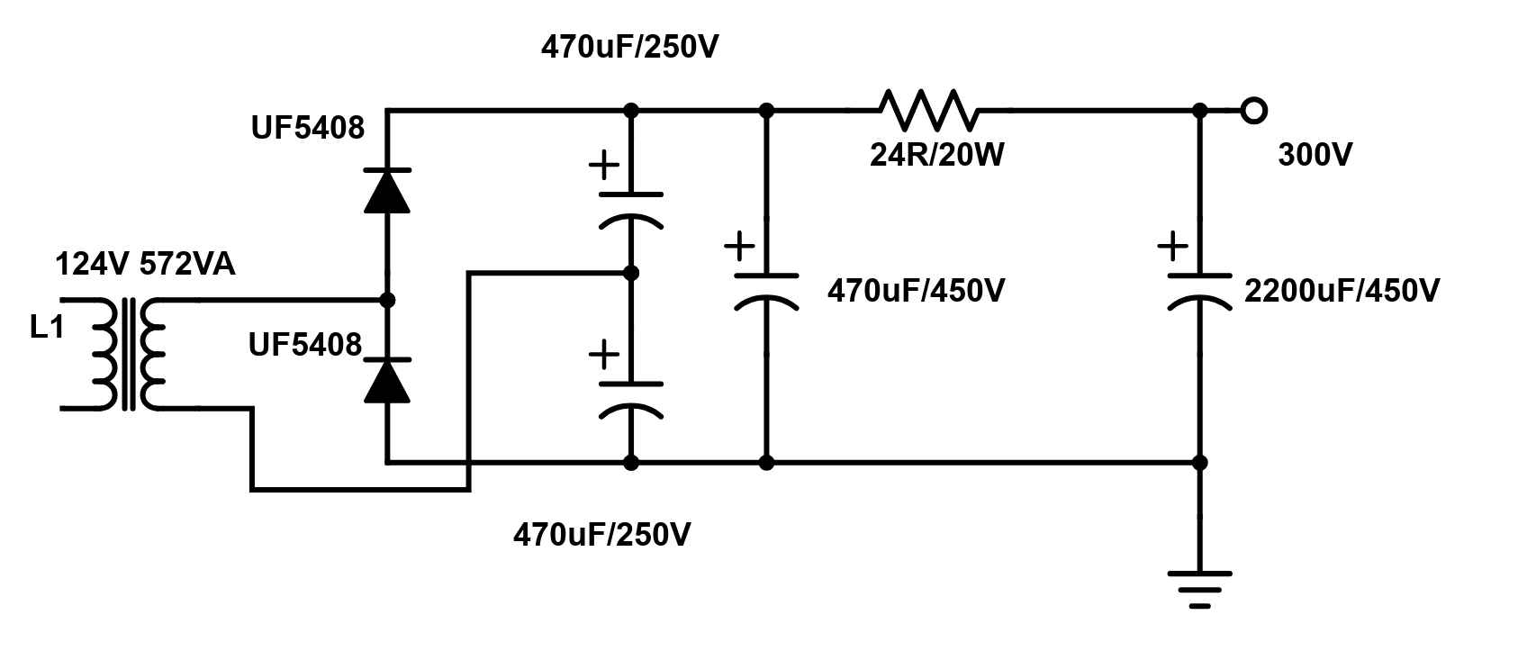

Rongon: If you want 325V - use a 120V isolation transformer and a Delon doubler.
Here's an example - replace the 24R resistor with your choke, and use smaller capacitors - This was designed for a power amplifier...
The N-68X from Triad is a cheap option for the transformer.
N-68X Triad Magnetics | Mouser Canada
I use 1000u/330R on the cathodes of the input tube in my power amplifiers...

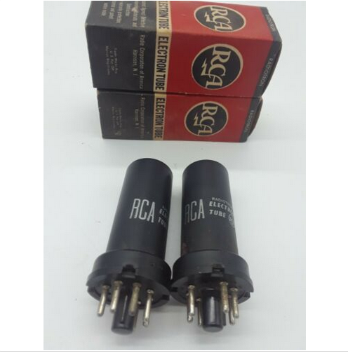

metal 6v6's
Enjoying this amp a lot, and also exploring and experimenting a bit.
Are metal can 6v6's like in the pic below less microphonic, especially in the gain stage? I would think so, but I don't quite understand the mechanism in causing microphony just yet.
Bigger elements and bottle of power tubes vs Noval preamp tubes makes them prone to mechanical feedback when not used as intended i.e. using them for line level instead of power output as we heretically do here. Thus the elastic mounting and hand picking measures we took in gain mode.
The output transformer in a power amp divides their gain by its ratio so they behave well.
Metal ones I haven't had any to test in this preamp so I can't give you a reliable opinion.
