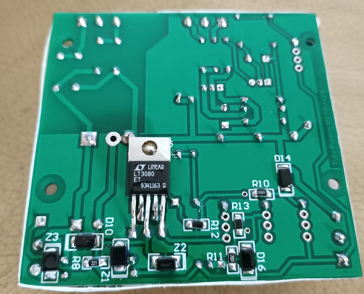

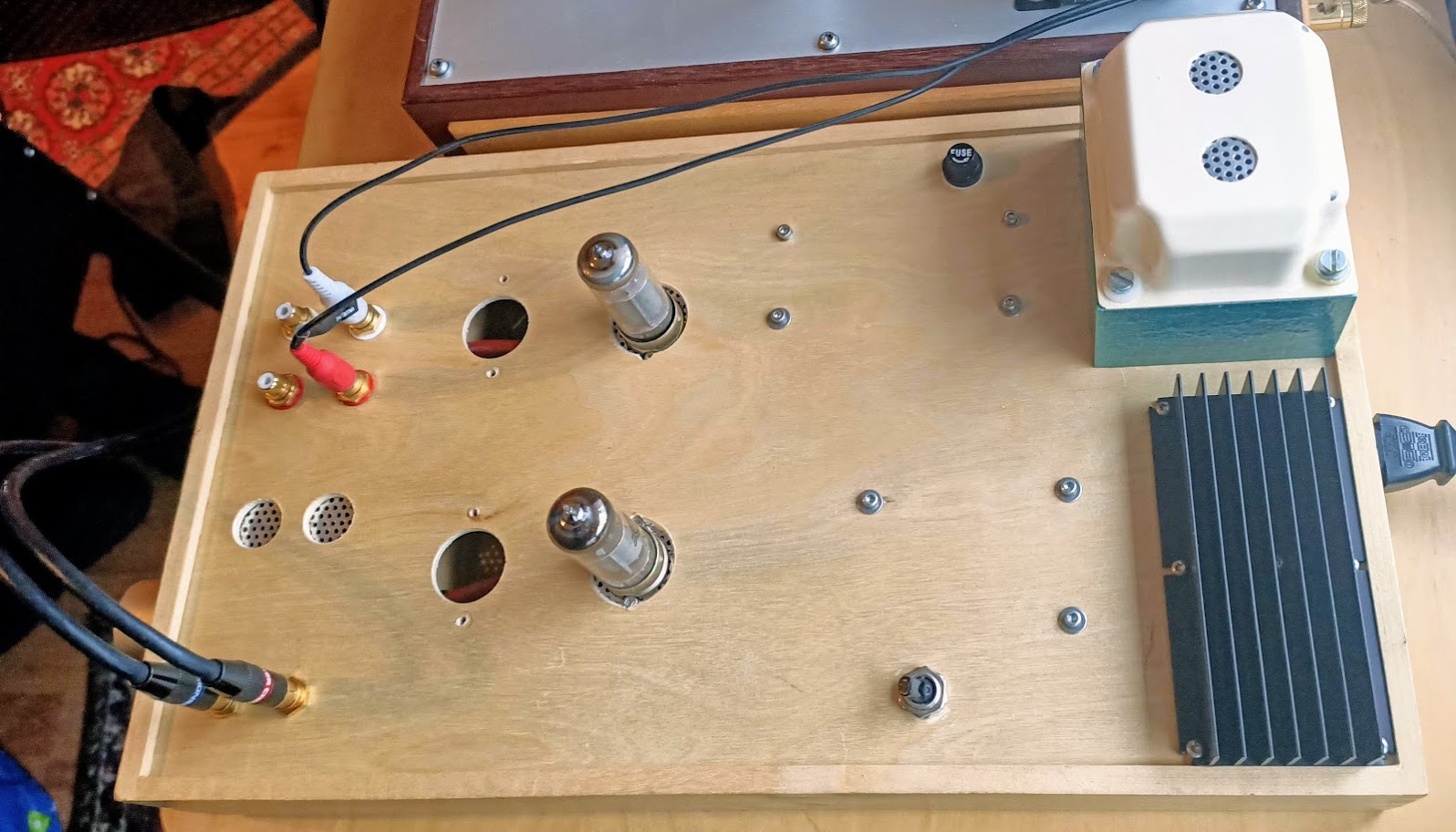

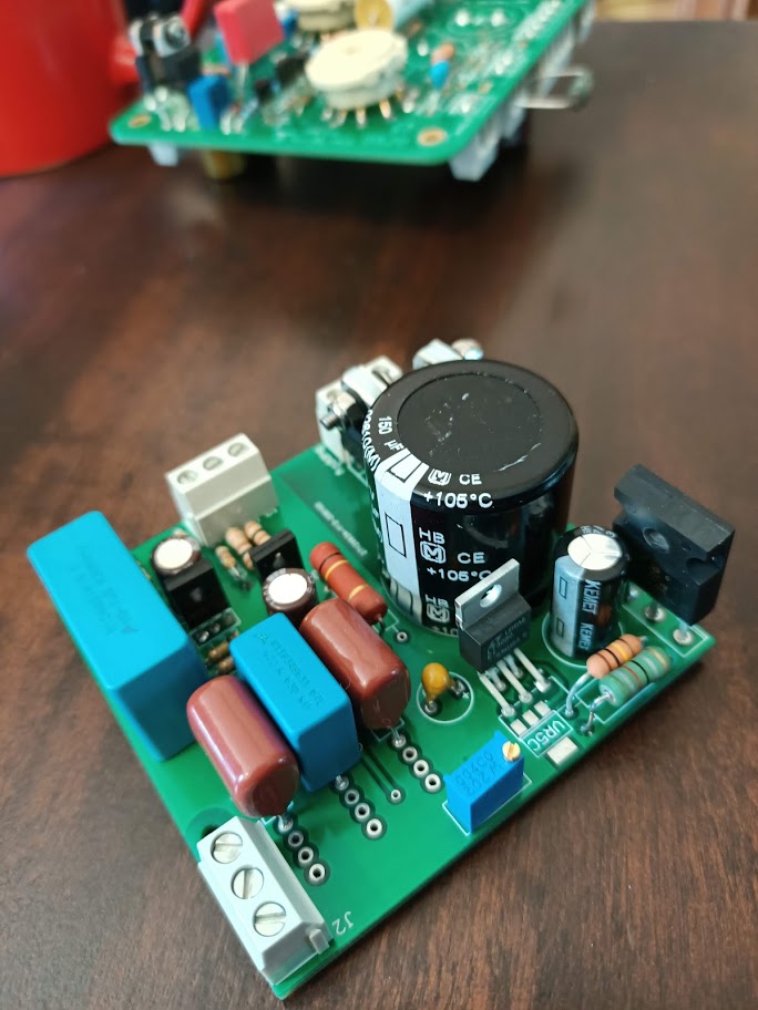

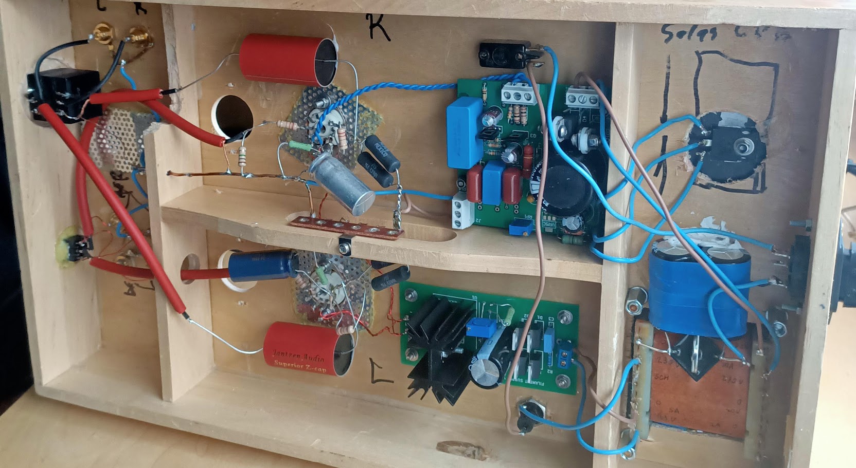

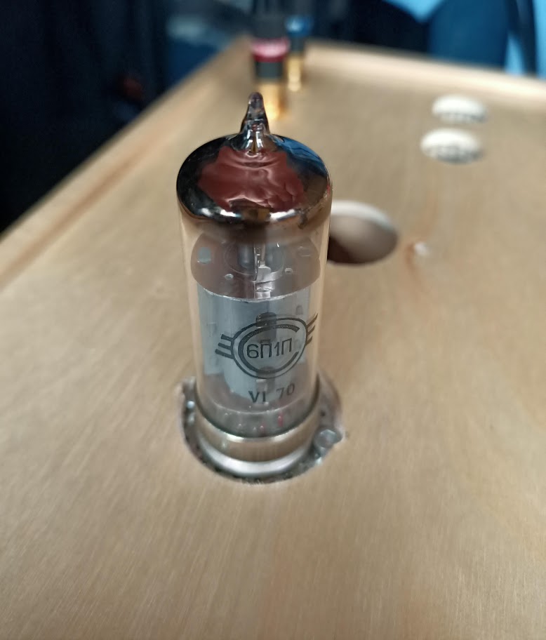

Another instance of the Salas 6v6. This time with 6p1p-ev. And 21st century Maida based regulator. Currently running trials in my kid's bedroom system. Slightly lower than the recommended b+340V. 305VDC. Power switch and fuse rather clumsily set up...but whatever...it works.
DC heaters. Heater elevated to around 65VDC with the 'thingy' by Morgan Jones (Was on the board so I decided to use it despite its detractors who claim it has not advantages over a voltage divider.)
Interesting alternative equivalent tube. Maybe good in microphonics. Because noval. Do I see the edge of a Svetlana original wing?
Yes on all counts. I'll know for sure, once I have it in my main system (re microphonics). (It is a non-issue in my son's system) ps the 40 odd mA it draws is peanuts for the regulator. Heat sink not getting warm at all.
