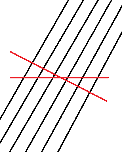

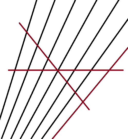

Sometime ago I tried a regular triode gain stage with resistive and CCS ( mosfet I think ) load . The resistive load sims with higher distortion of course but the resistive load sounds better !
Did anyone check this ? Maybe because of the high 2nd order distortion ? More distorted but sounds better !

An active CCS load is a horizontal load line when a resistor is a slant load line. In high enough swing there are obvious differences to be had in THD and its profile. Usually there are subjectives involved in choosing that depending on the designer's approach. But in very low swing for very low input signal applications a CCS is put there more for the PSRR benefit it brings. Someone can use a Cascoded JFET for that, in a J113s small number will be easy to have samples between 15-25mA for instance. Or a low Rbb' NPN. DMOS maybe is more noisy in a critical application as this and it would not work well if less than 20mA is needed for a number of starved noval tubes. Also if using individual same current CCSs for each plate relaxes the tubes matching adventure hunt and allows to be focusing in low grid leak current samples primarily. In the end you put the total mousetrap through the high bit FFT where the best audio band noise floor and 1/F behavior combination wins. THD is plenty low in such diminutive swings anyway.

May be because there were different anode voltages with CCS and a resistor, so load line with a resistor was going through more actually linear regime? I never saw anybody who really liked more distortions, despite of their beliefs.
If we have curves going pretty much parallel in the area of operation there is not that big of a difference between a current source forced loadline and a common resistor loaded line. If on the other hand we have a region where the Vgk curves looks more like a sun feather in the choosen region and choose a resistor as load that also goes steep we can see how the non linearity kicks in.

Yes the difference may not have primarily due to the CCS alone. It wasn't a focused test. It was just 'noticed' while doing many other things. Could have been due to something else. However I think I'll try it again just to make sure and get it off my mind. Thanks for the comments.
