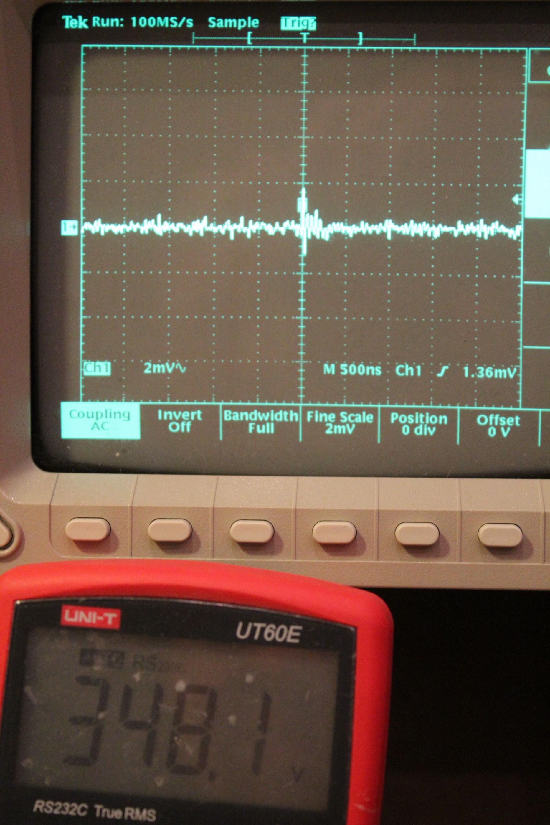

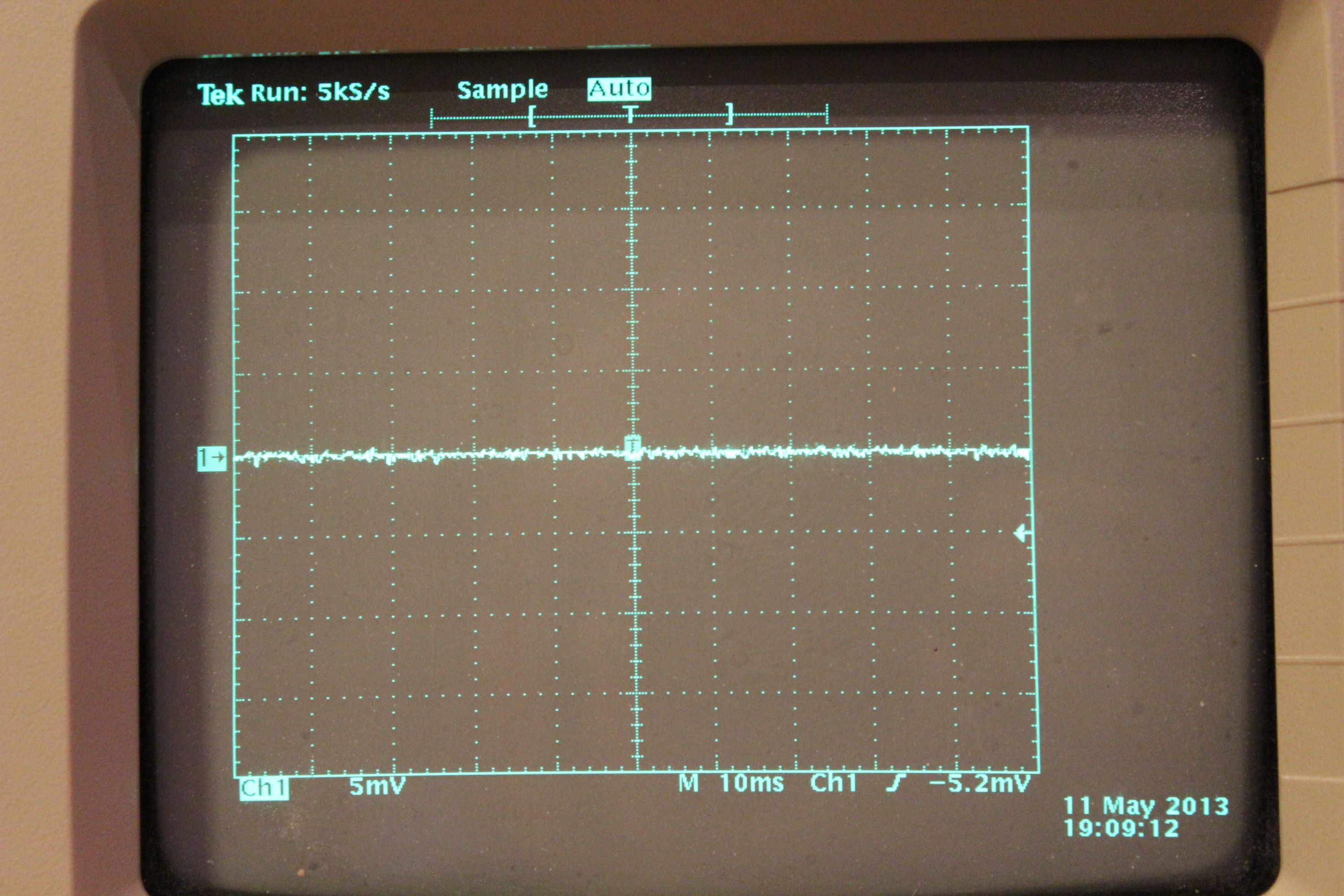

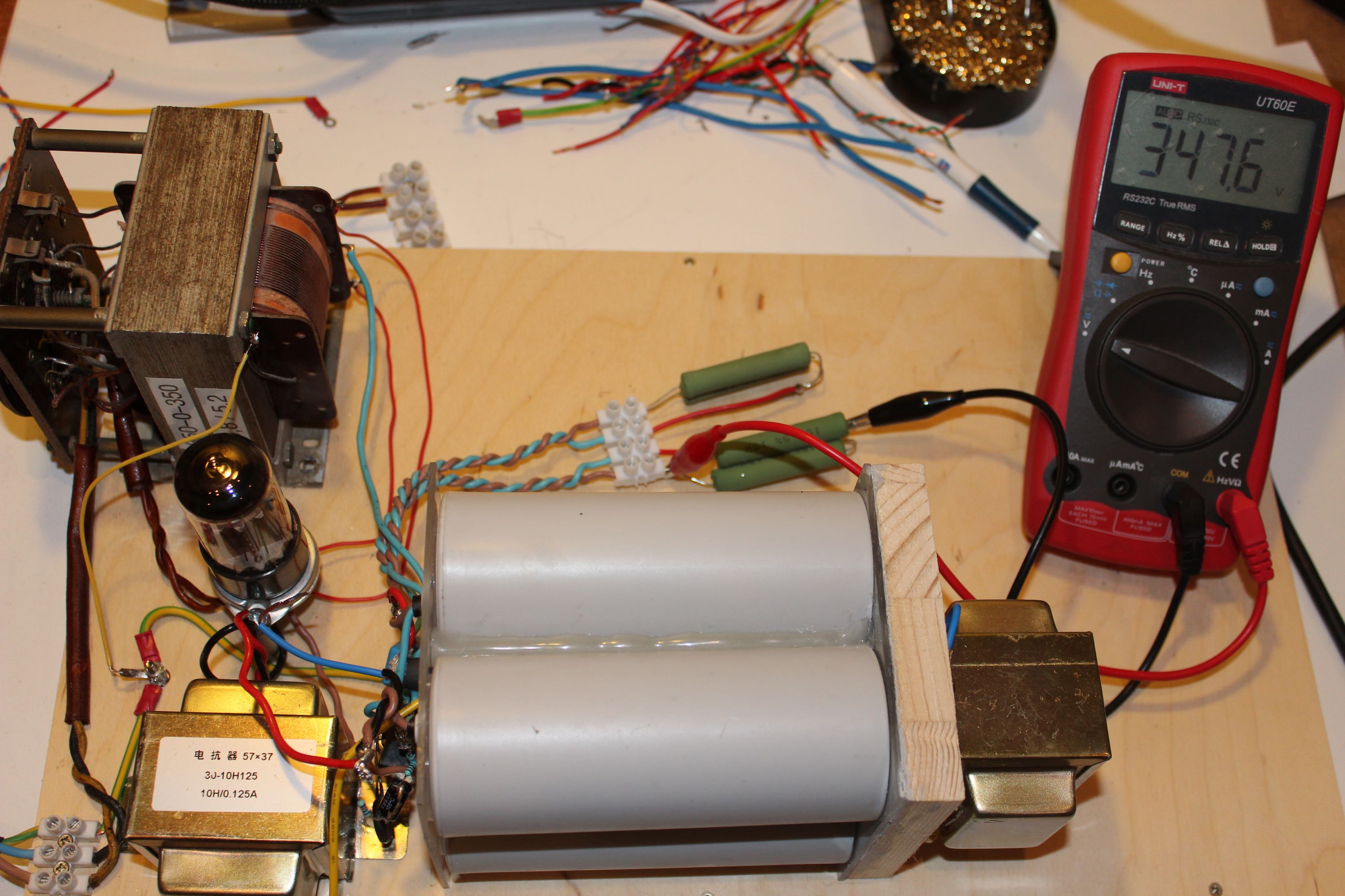

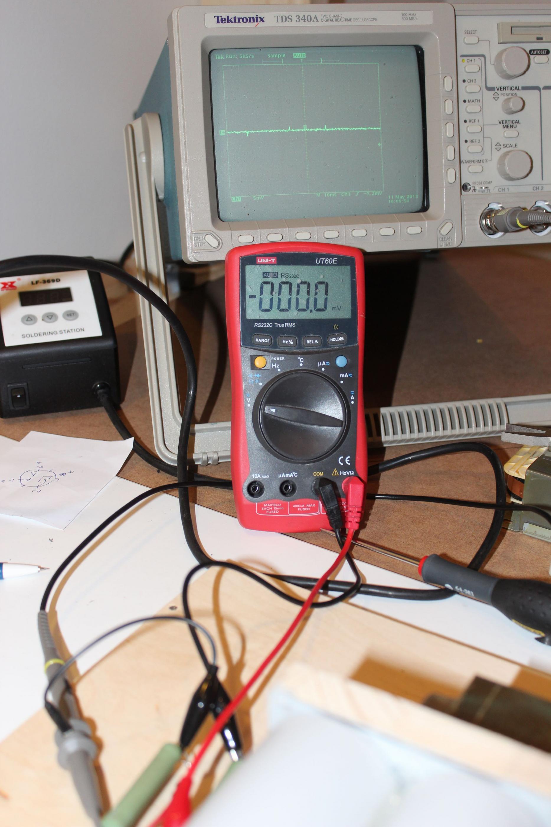

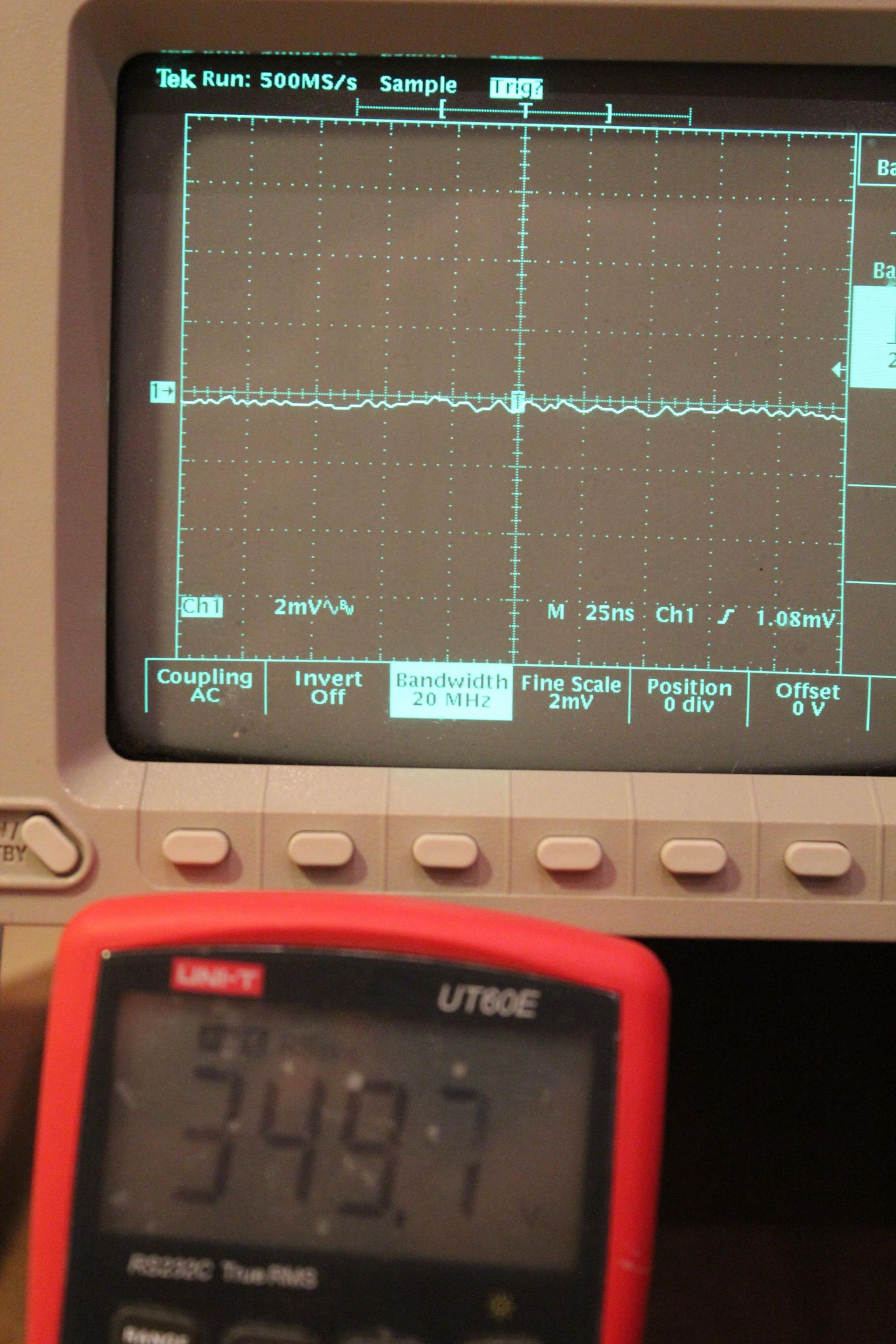

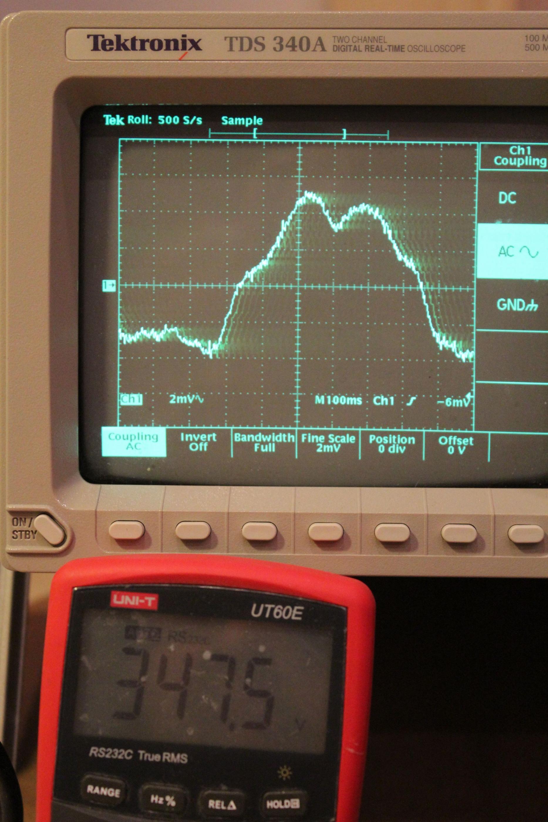

Ok, heres my new CLCLC. Pic one no voltage probes on, pic 2 same closeup, pic 3 full B+ at 2*7500 k load, about 93 mA. Pic 4 mains variations, slower time/div. 10X probe 200 MHz (thank you Siberia) calibrated for the scope. I guess I could run this with neat results on a normal resistor AF.
The step now is just to rule PSU out of the picture if I get strange results on circuits later tho. Seems ok.

And yes. The PSU chokes are now completely floating. I measured big differences last time on how I connected them. They can be separately connected between shell, with screws to chassie, which made huge differences if or if not last time. There is also a core grounding, which now floats. I will alter this and see what differences it makes. On line chokes it might even be worth to try tie it to filament level. Never know...
At this point I think its pretty perfect for an other split LC, I think I have some at 12ish H 50 mH style. Tho no filaments is plugged in the circuit yet, exept fpt the GZ34, so it might bring down B+ a few volts. Maybe enough for some 310 after dual SSHVs, a bit to low tho for resistor AF. This tranny is super for maybe 150+105 glowtubes and 115 H/930 anode loads.
