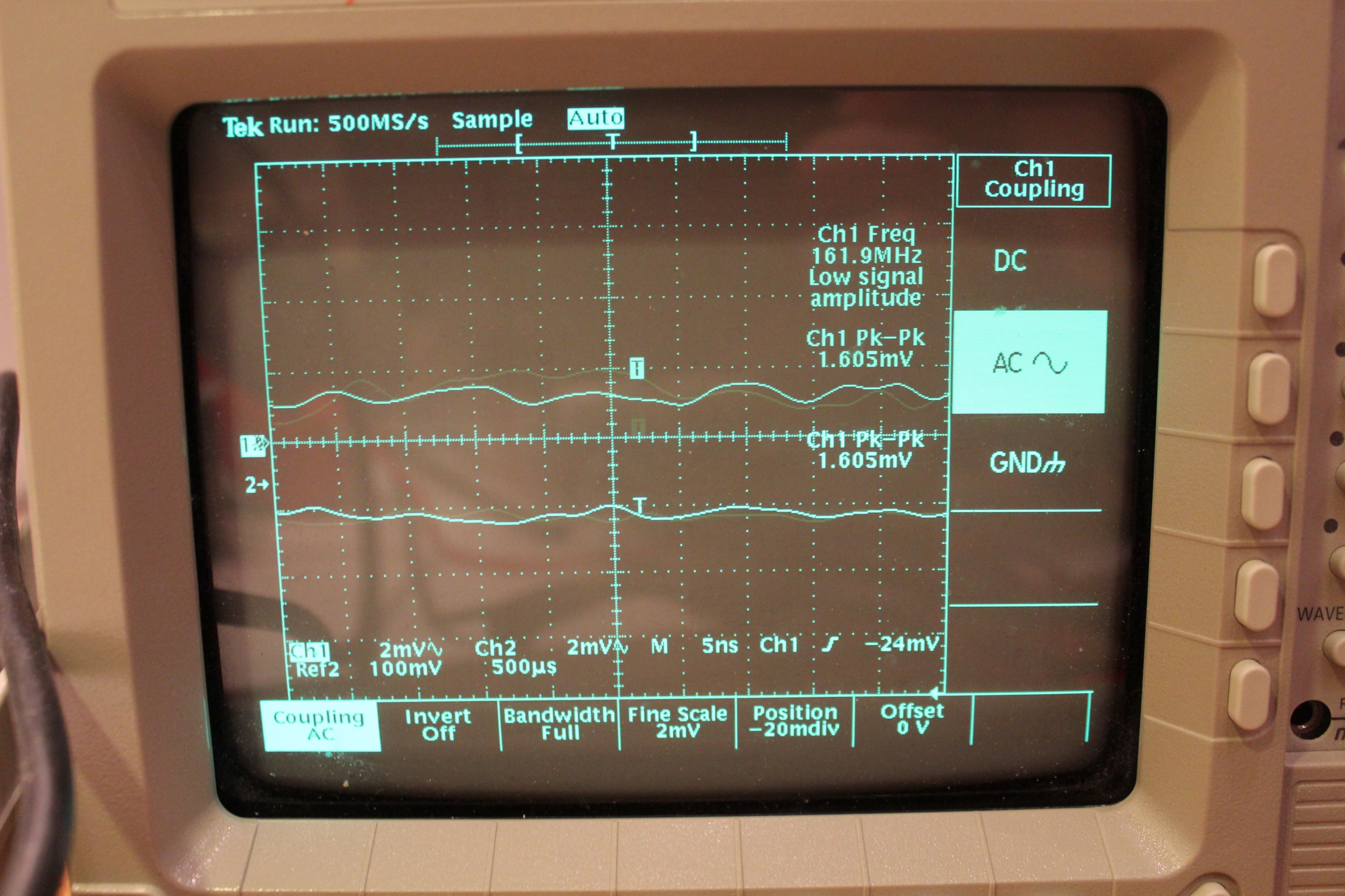

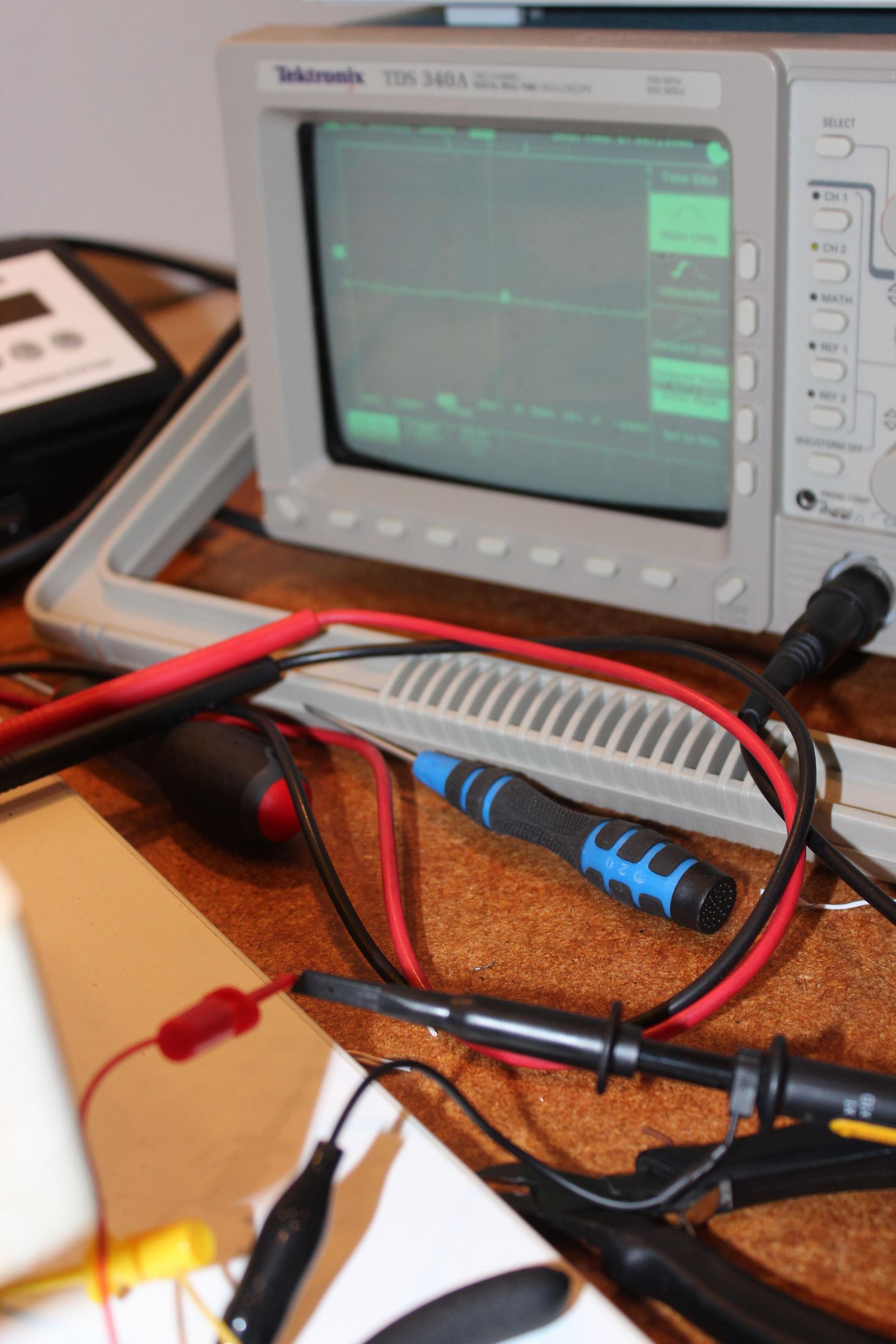

And, as you say it. As a flash from a clear blue sky heres shiny new wiring (be gone, cracky ethernet TPs) (pic 1)

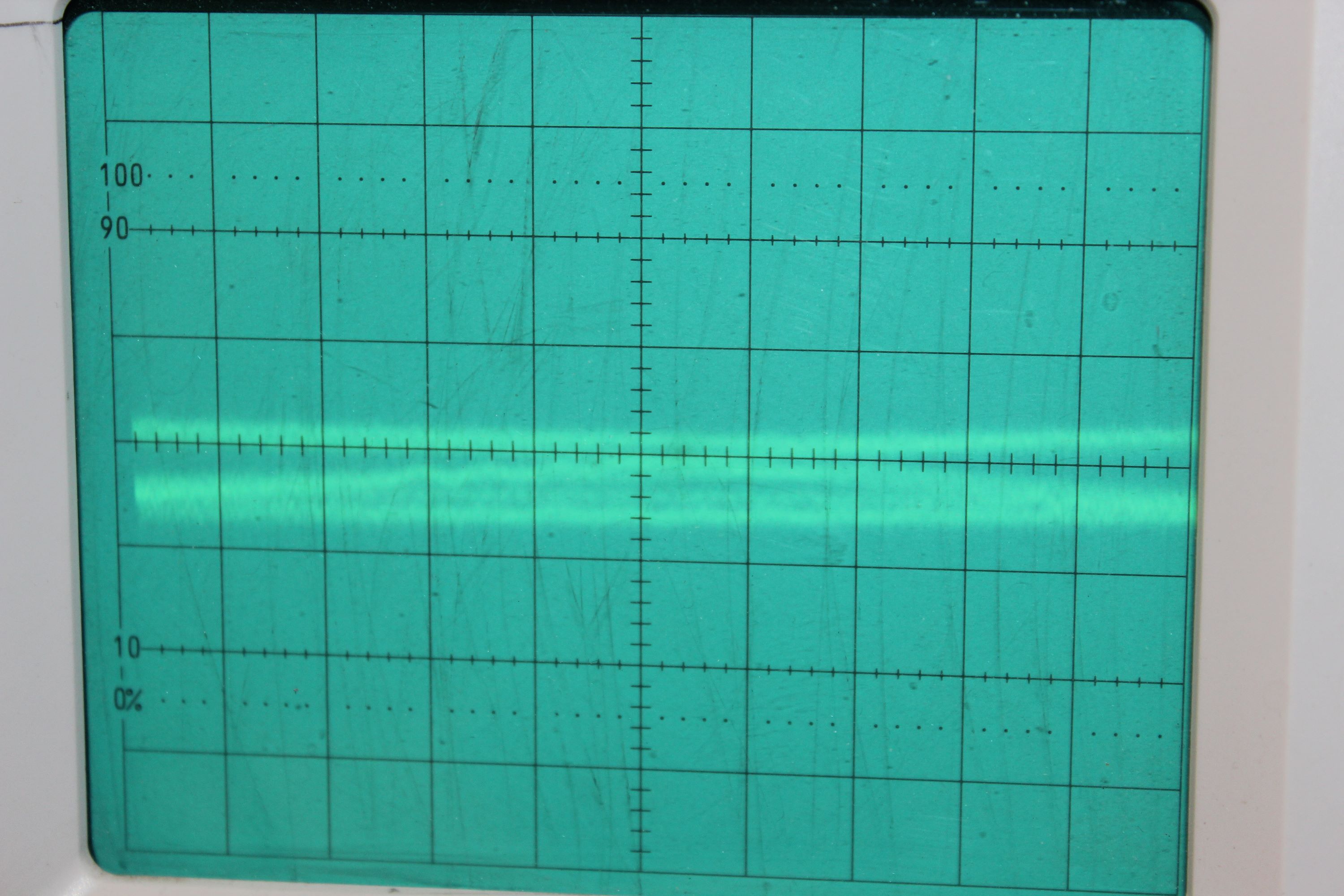

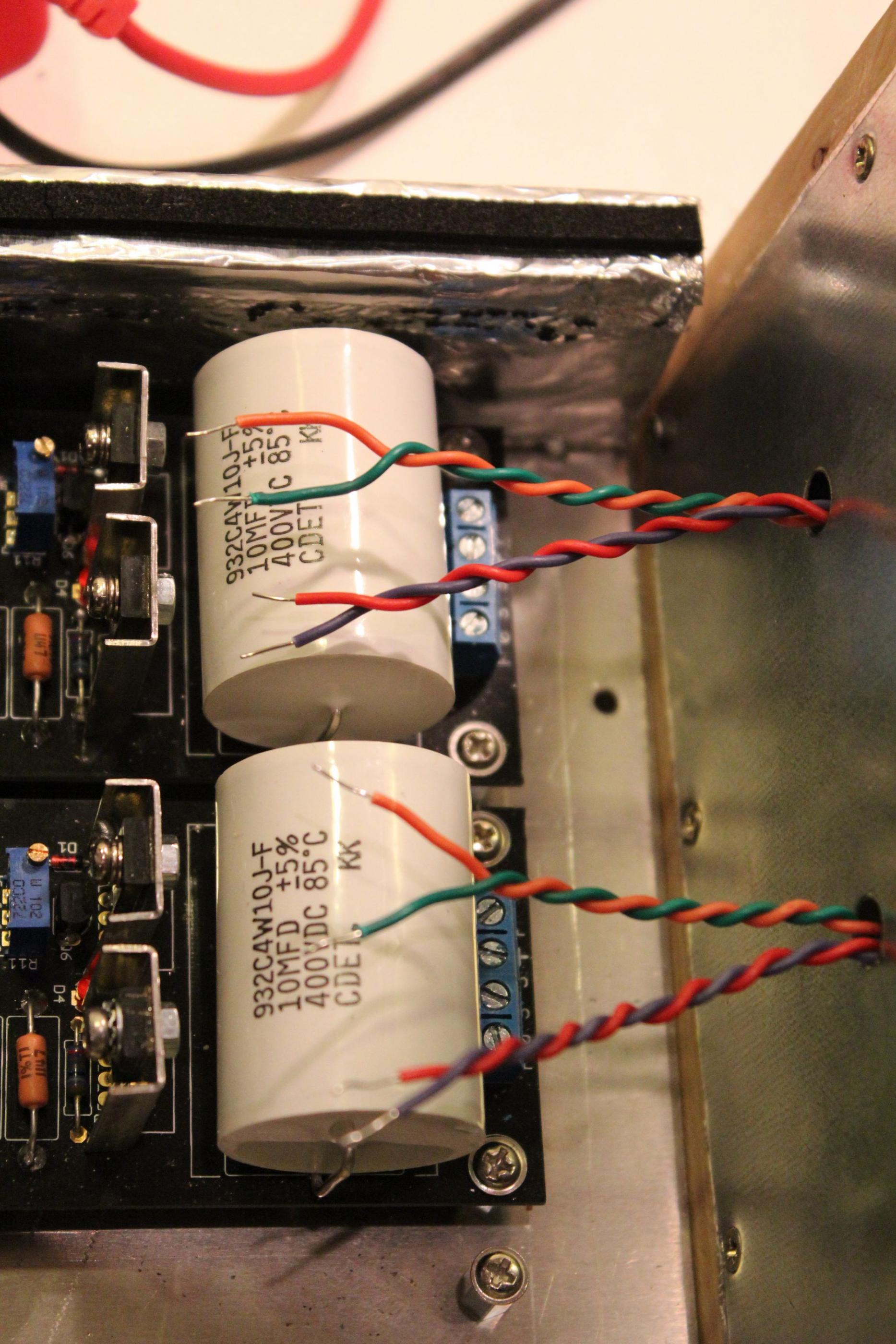

Some shielding to hopefully shut out some noice (pic 2)

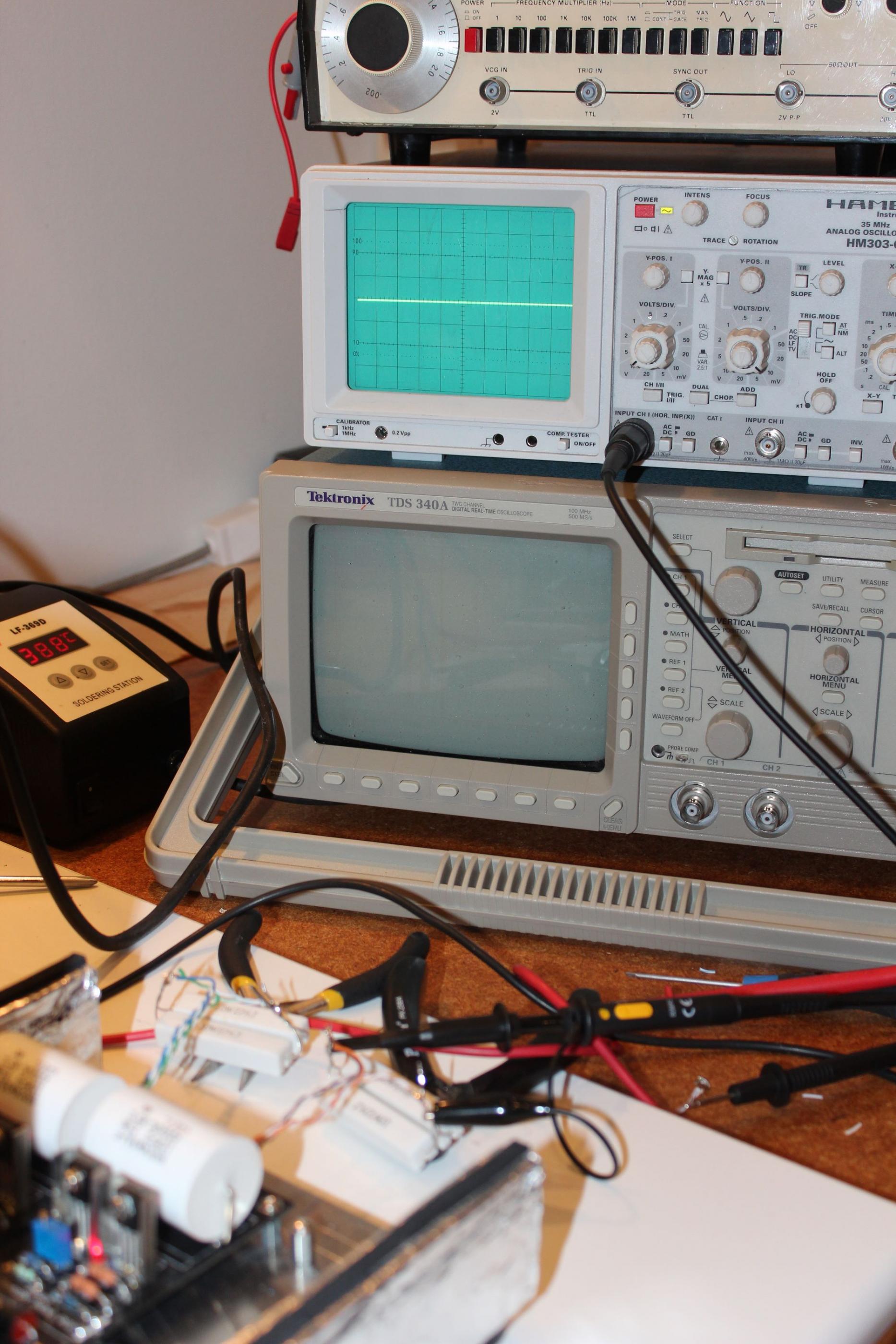

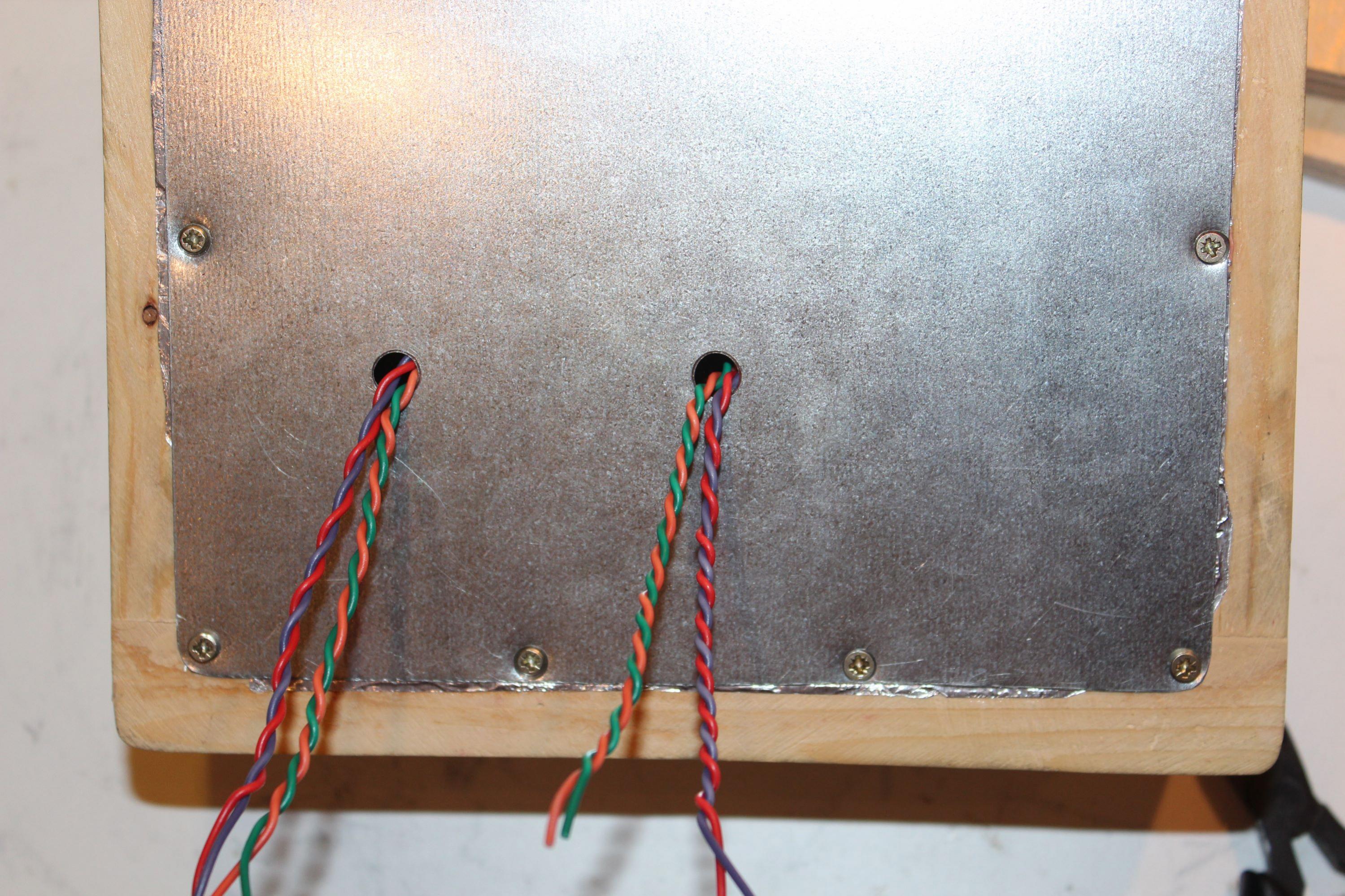

The barge (pic 3)

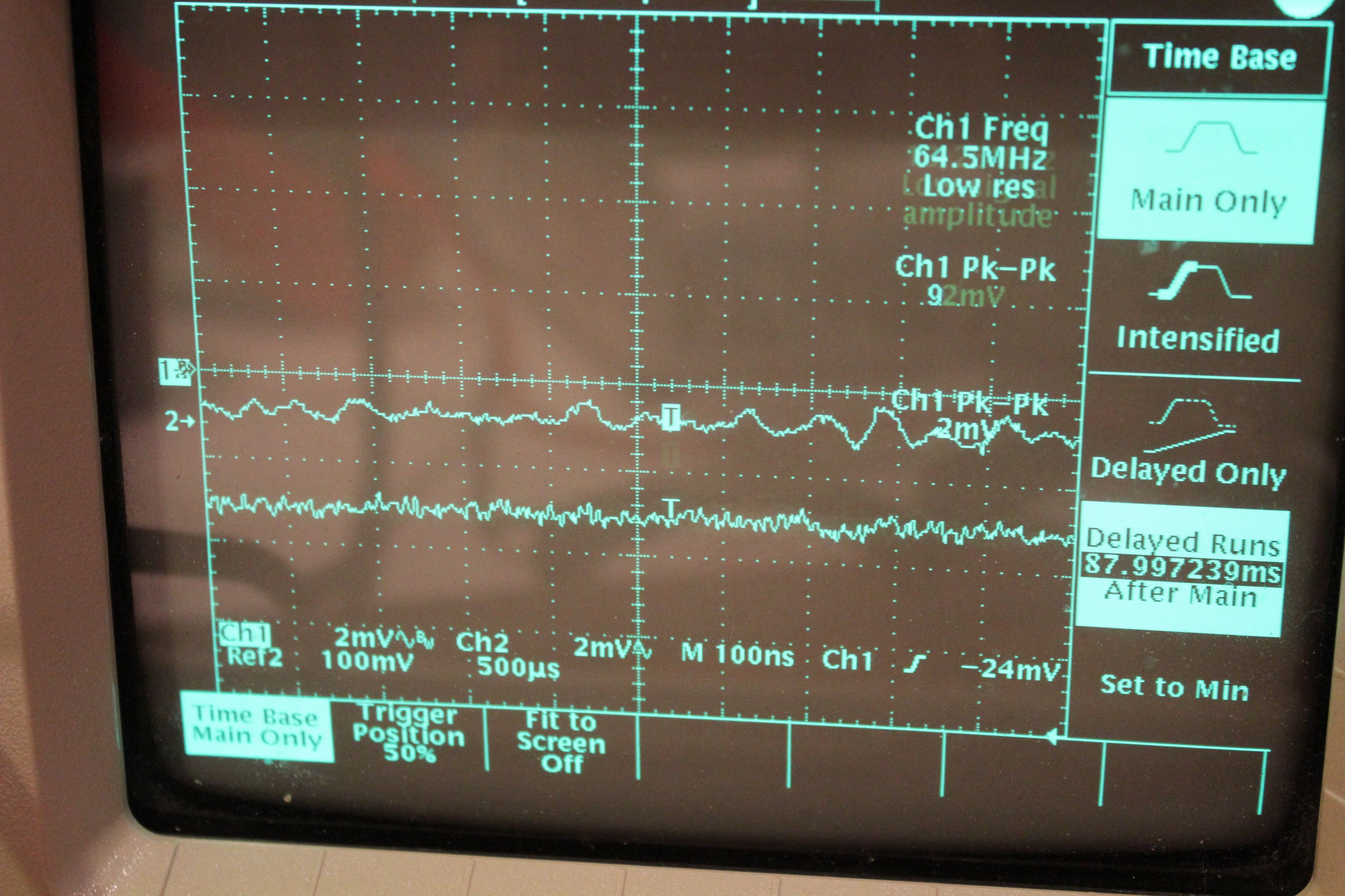

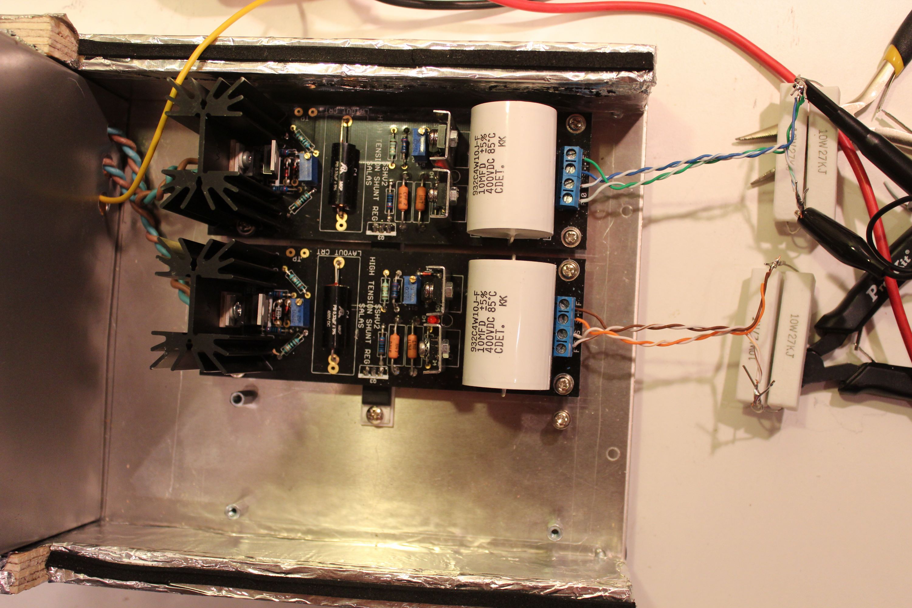

New test rig (pic 4)

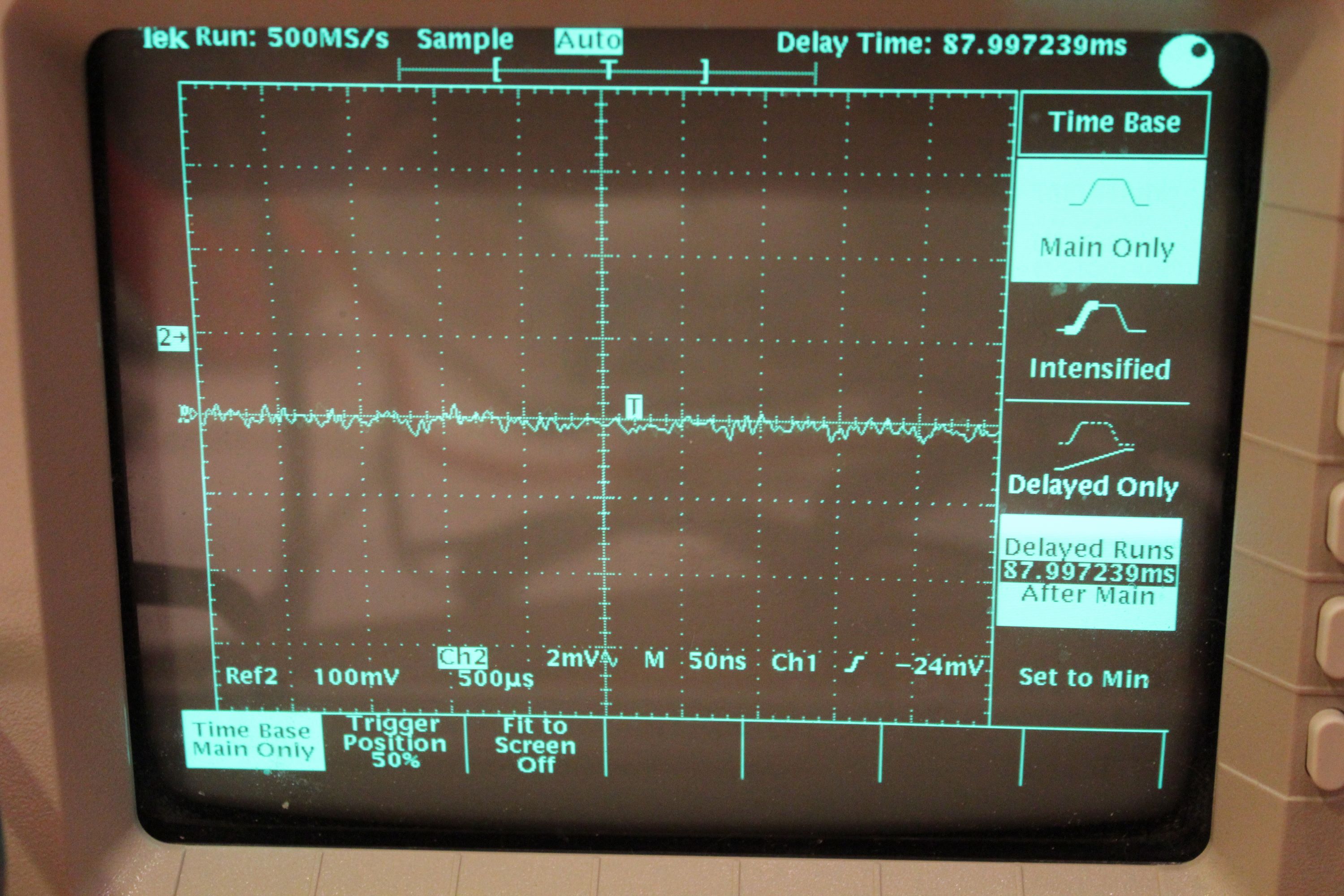

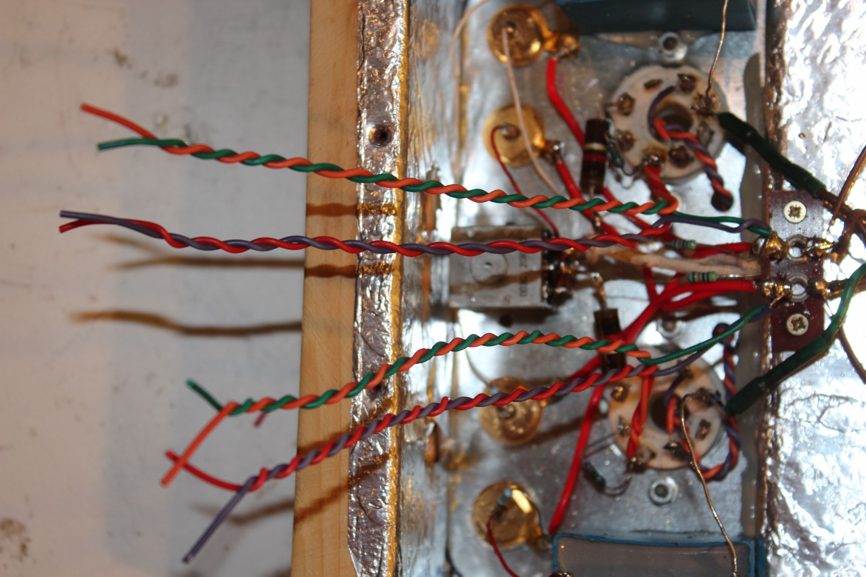

Dang what have we here? 5 mV/div (pic 5)

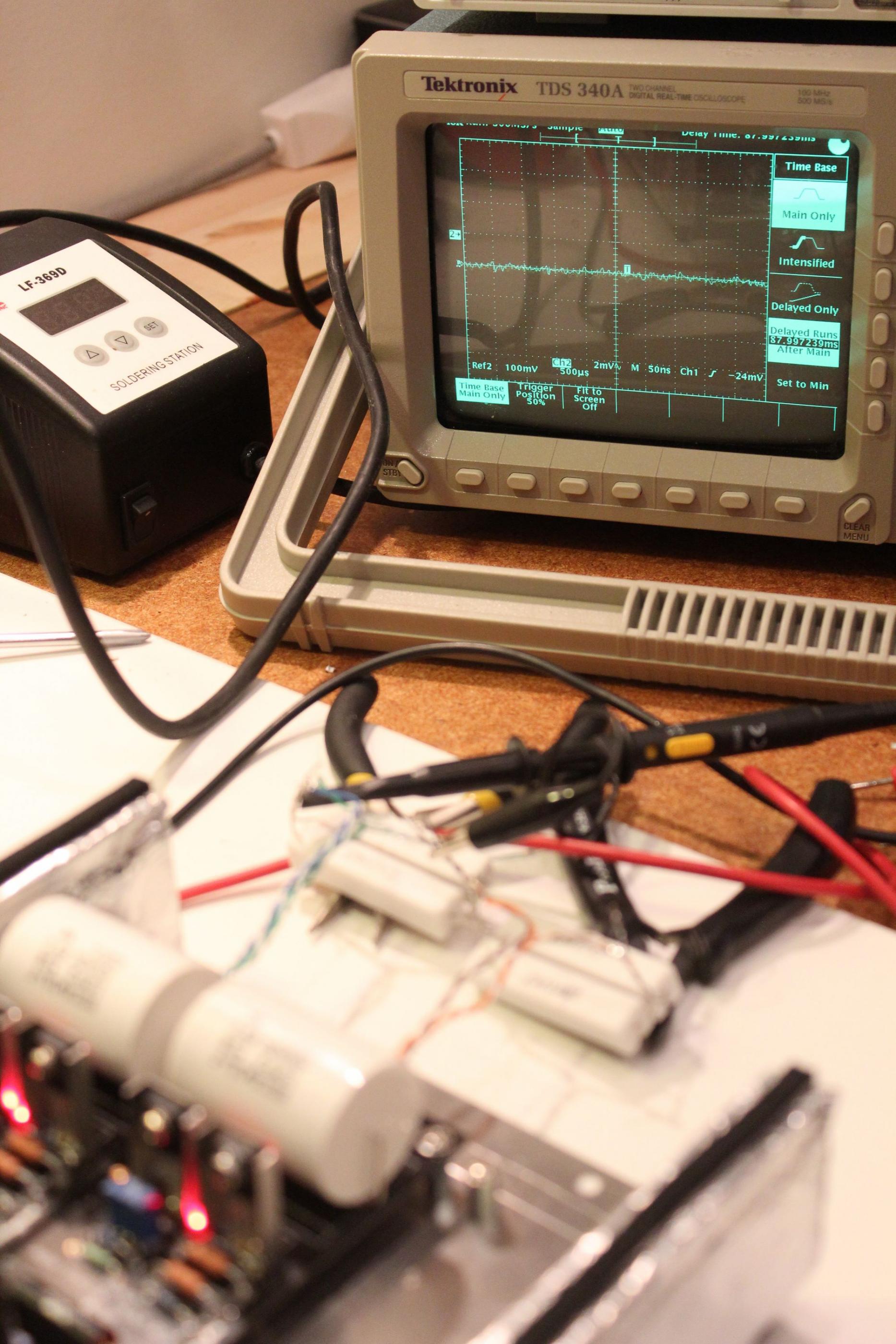

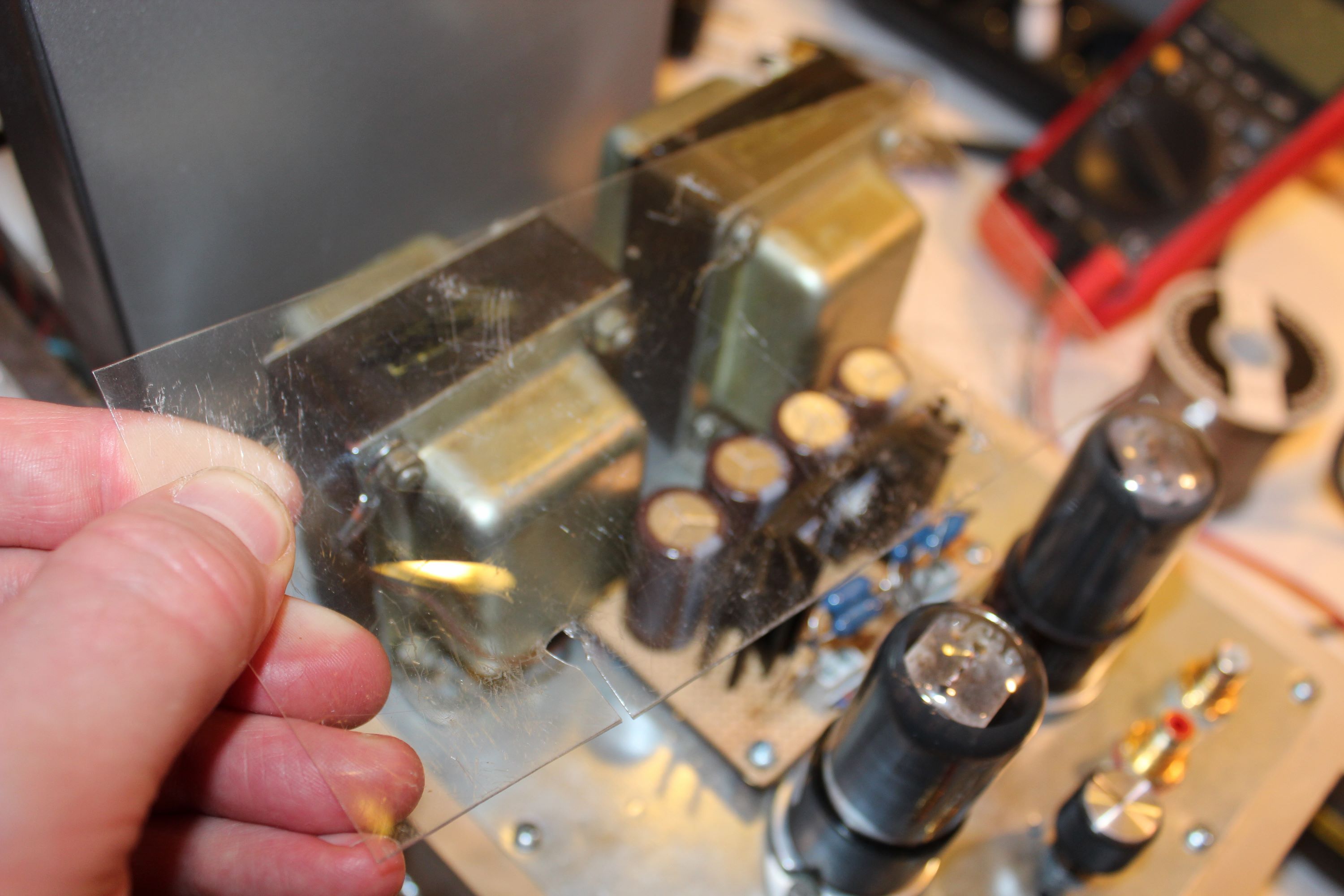

13,5 k dummies (not as dummie as me pic 6)

Do I have a problem

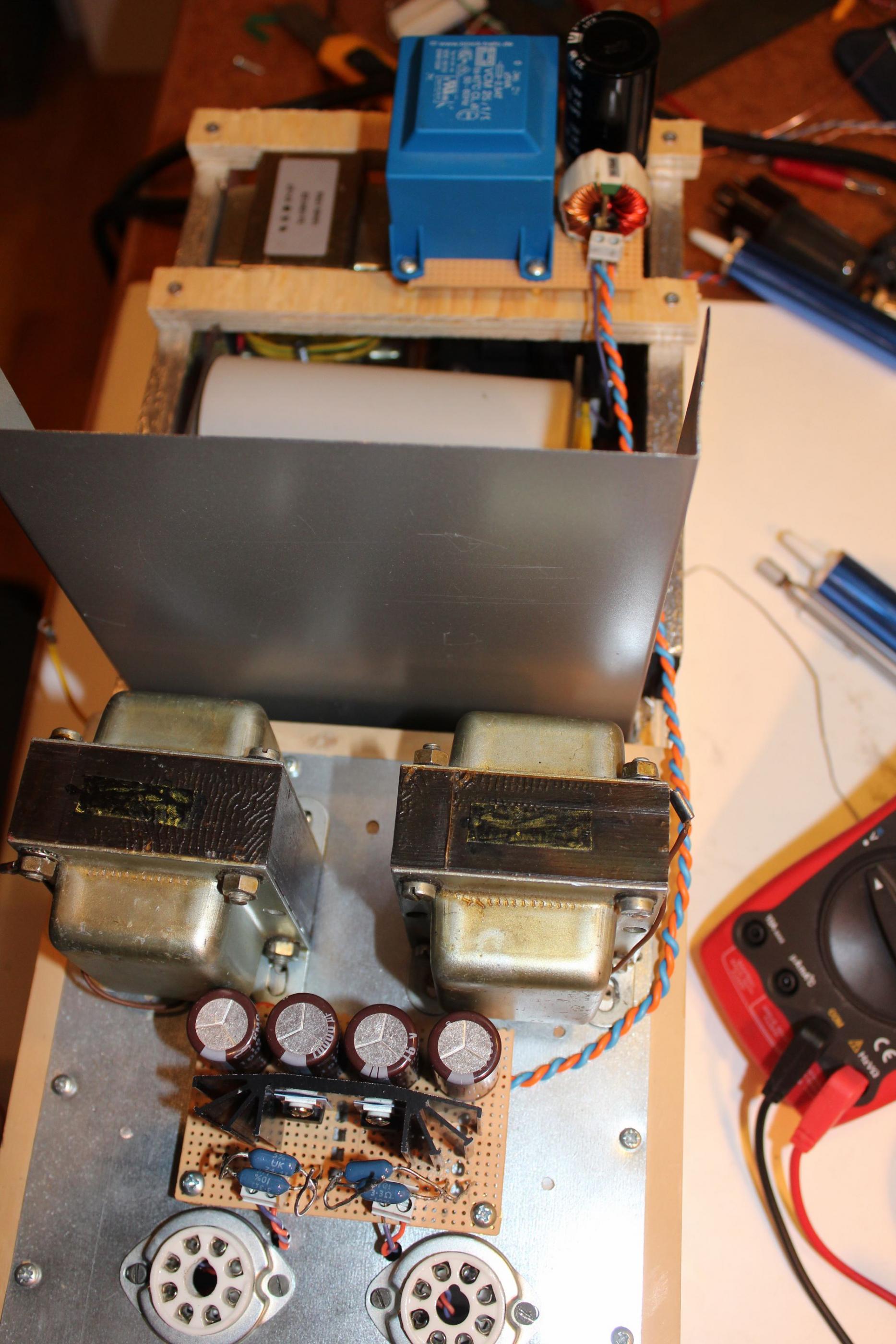

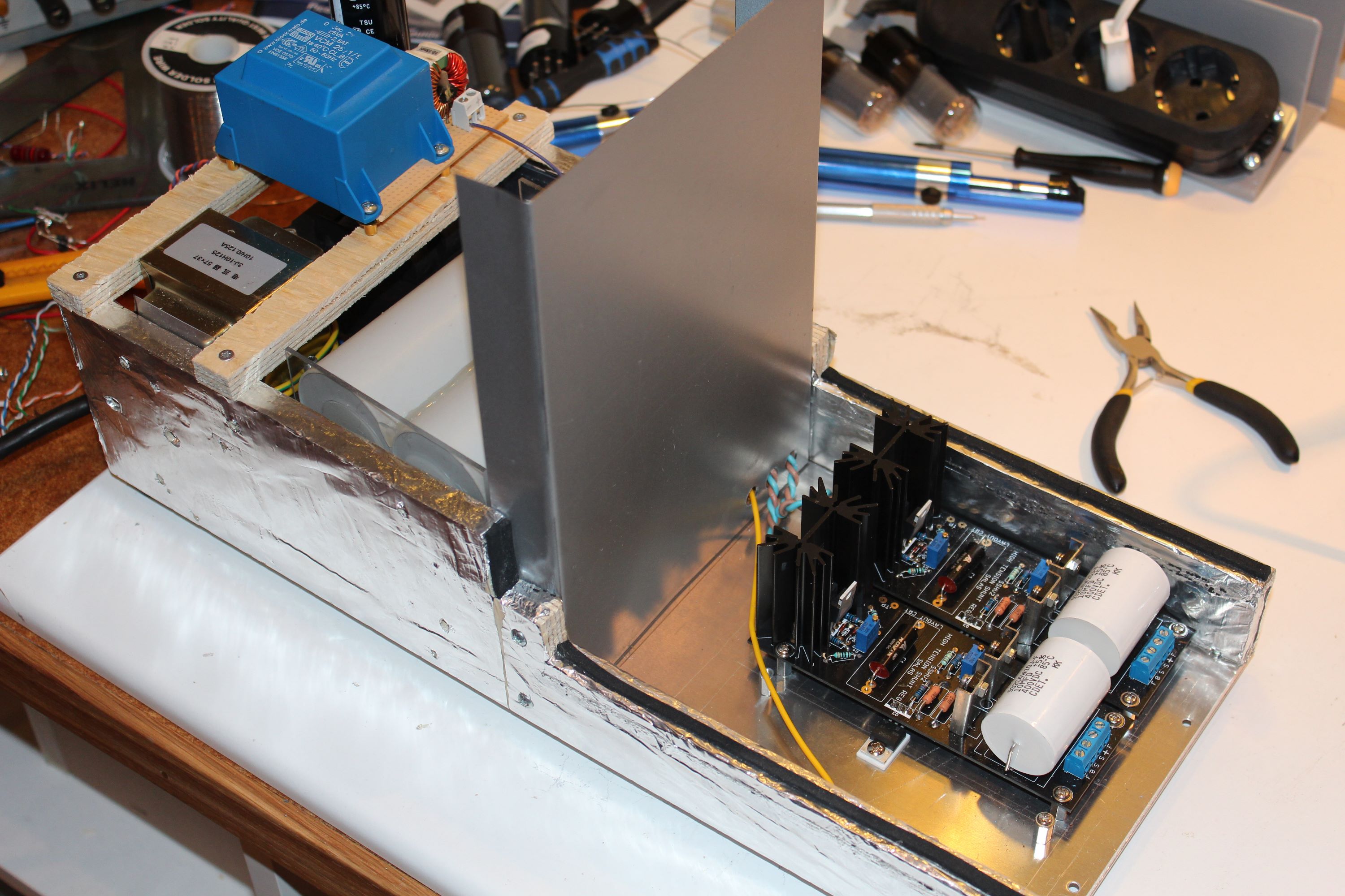

The barge (pic 3)

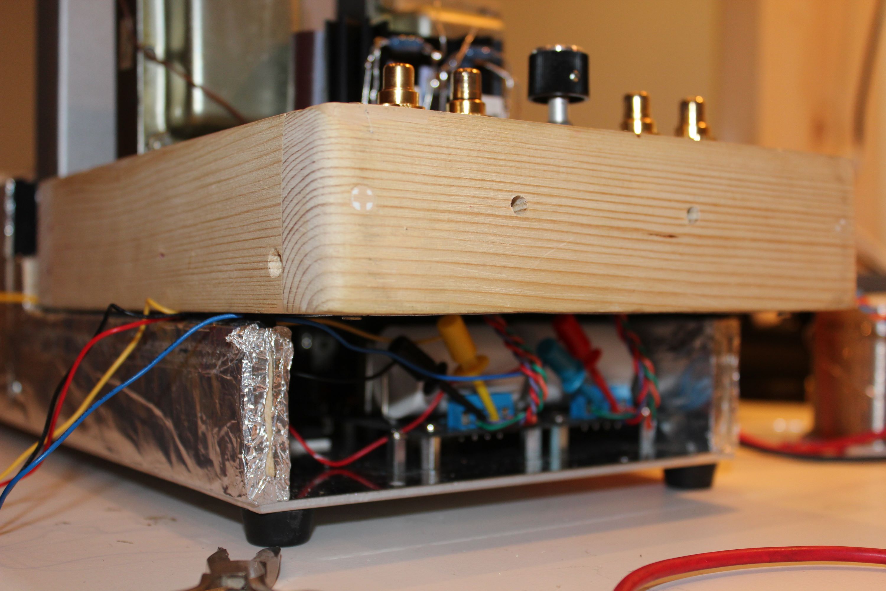

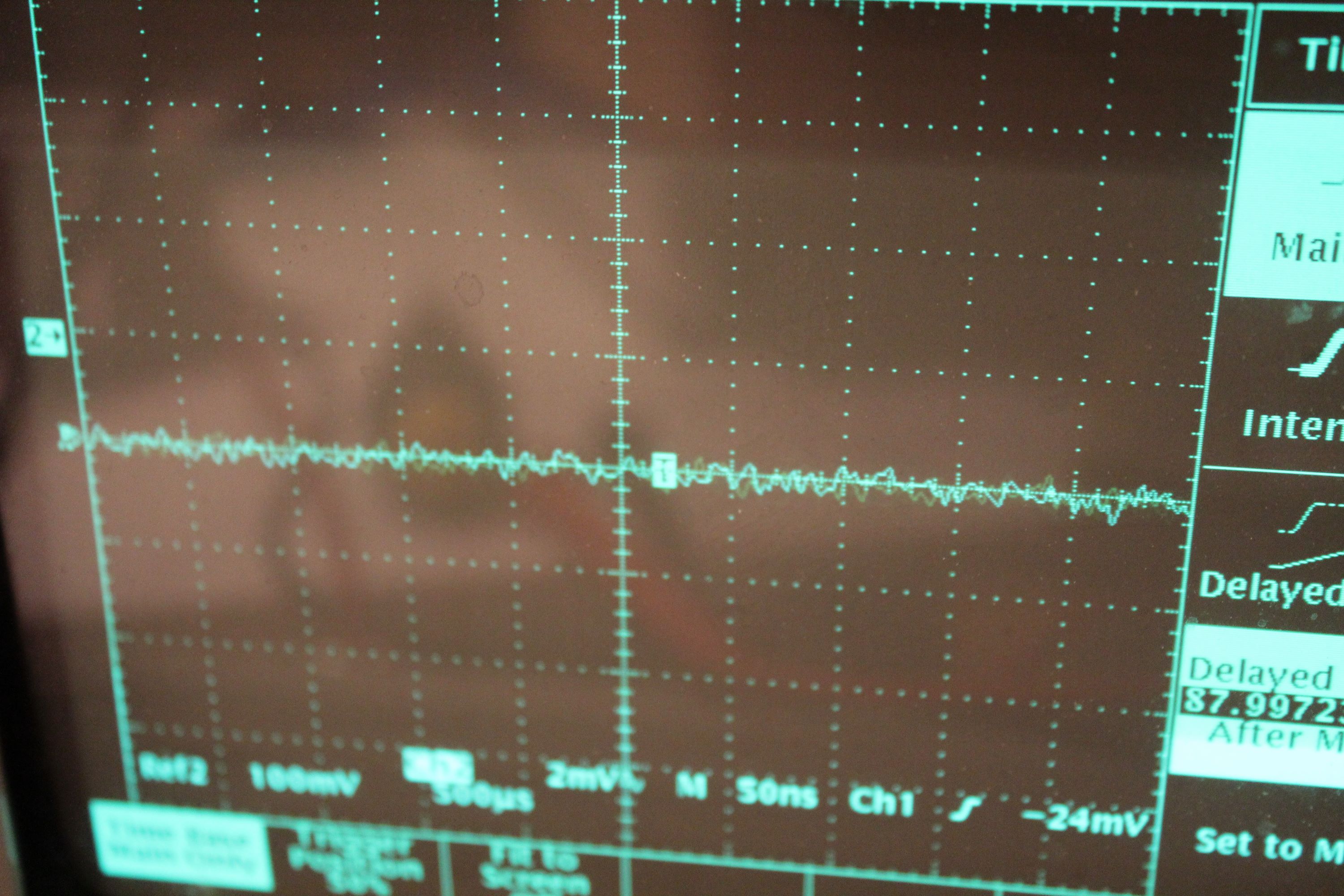

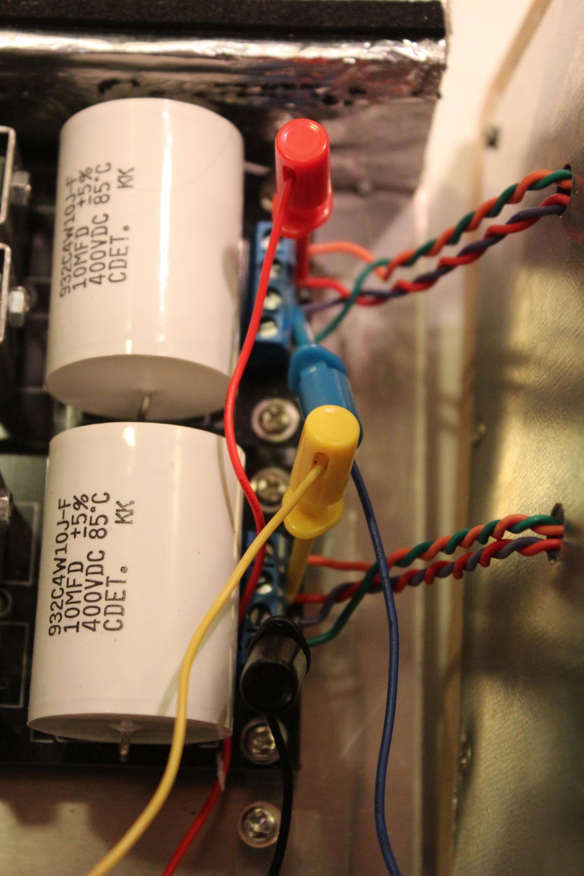

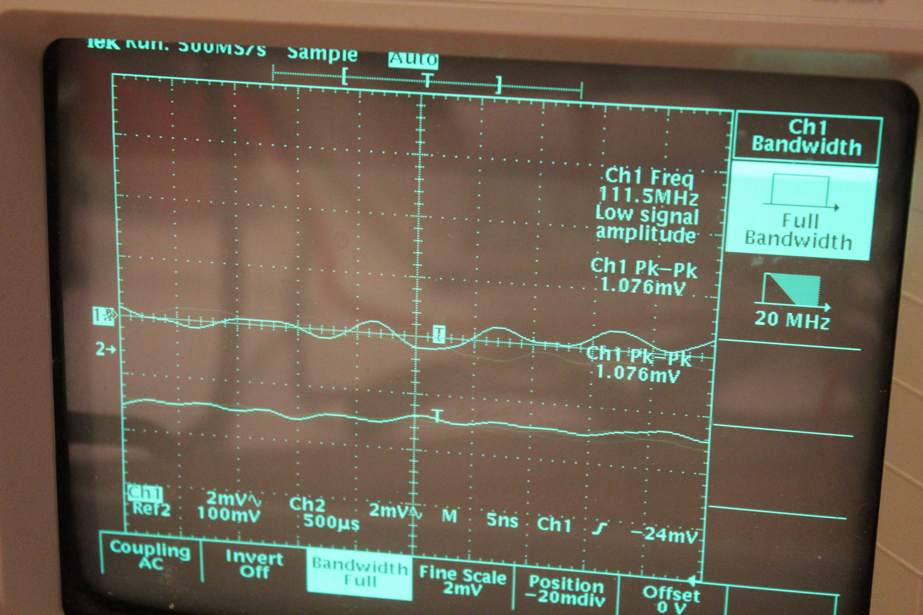

New scope first shot, 2 mV/div (pic 7)
Do I have a problem

DS. The hooks are 60 MHz. Suggest me some new on fleabay if you know any decent provider.
At least 150MHZ probes if to cover 100MHZ DSO with not much additional shift.

Use one channel at a time because it triggers off of just one and noise is not periodic so to sync 2 channels on anything in particular. Looks just like measurement loop and DSO noise to me, and low at that, with no suspicious waveform or EMI spikes. It should be a pass if you are not having something up your sleeve of course.
P.S. Read the manual a couple of times is highly recommended, DSO has nice tricks and traps also.

- New super 1 guage cablong
- Peeled and shorted and test probes on
- The flybridge
- Filament power lifted to 36 VDC
- Chokes isolator handmade by yours truly
