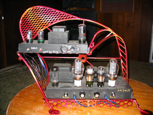

Here is my old John Hogan 300B amp with line stage on top. I made the chassis. I sold the amp last year and kept the chassis which I will now use for my 6C33C. I am planning on having the two power supplies on the bottom chassis and the signal path on the top chassis with ambilical chord between them. I am going with Ari's Simplex and becasue the top chassis is almost too small, I will use his SCC 2 on 1 OT.
In honnor of John Hogan (we lost John last year) I will spay paint the chassis cringel black and lable all the tubes and such with a gold paint pen.
What issues do you see with this layout? Cheers.
P.S., I might add that in Ari's schem he uses diod recs, but for mine I will use 2 6D22S half wave rec tubes for the 6SN7 B+ and 1 AZ1 rec tube for the 6C33C B+
DJN,
I doubt that your AZ1 is powerful enough, in the Duplex the B+ for 4 pcs 6C33C is 1.2 Amps. Other than that I see no problem in using a separate PSU, Ari did it and I have seen a lot of German builders do the same.
I am not a tube expert, I am more of a builder than designer, but I would look into the spec of the AZ1 you plan to use.

Good point about the AZ1. It is most often used in pre amps. I do have 2 of them and 2 of their special sockets. I wonder if I could parelle or series them for increased amp handling capabilities. I am a builder as well. Most of this stuff goes over my head. I got the dimentions of the SCC from Ari the other day and it will work, but yes, it is big. Cheers.

This could be an interesting option. What do you think? I could put all 4 6c33c tubes on top and the PS on the bottom. Cheers.
