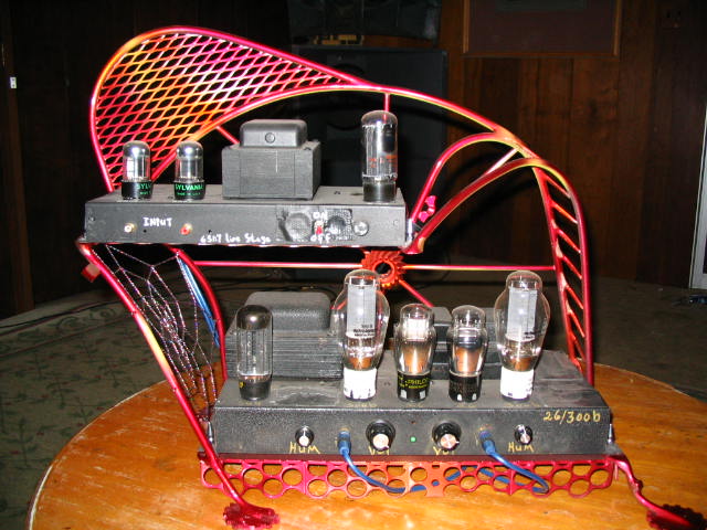

Hi All, I have been following this thread since it started. I am just now finishing up a GM70 SET amp so now I am starting to think about building a 6C33C SET amp. I found a PTX last night in my stash and it is a 350-0-350 with 12.8v legs, 6.3v legs, and 5v legs. It came from a Conn organ that had lots and lots of tubes to drive.
I have two issues that I could use help with
1. I do I know if the 12.8v legs will drive 2 6C33C tubes
2. I am a metal sculptor and I have a wild chassis built already that I would like to use. That being said, what would be the smallest (physially) OT I can buy for the amp?
Here is a pic of the chassis with my John Hogan amps that I sold. I would put the output tubes, driver tubes, and output transformers on top and the power supply on the bottom....or visa versa fit it works out better.
I have 2 6D22S dd rec tubes, the PT, 2 new steel boxes made to fit the upper and lower chassis, and all the chokes for the PS.
I am still trying to figure out what scheem to use.

@DJN,
You might want to contact mr. Ari Polisois, he makes a very special breed of OPT called the SC-OPT, which in fact houses both OPT's on one core.
Since you are limited to existing housings, which to my taste are great looking, this could be just what you are looking for.
Polisois audio amplifiers and transformers: designing and building audio amplifiers and output transformers
Ari's designs are somewhat controversial, but if you always follow the beaten track, you will never discover something new:D
Thanks Midlife. I sent him a note for the dimentions. They just might work. Cheers.

Hi,djn!
You can check Your transformer for:
1. Heating for each 6S33S is 12,6v/4A, or 6,3v/7,5A.
2. 6S33S works good with Uanode-cathode = 190-210v.
3. Your main transformer has 350-0-350 v, after filtering will more than 400v, that is very big and not suitable.
Cheers!
OK, thanks Azazello. The transformer is not marked but I got the reading with a multi meter. I think if I used a choke input out of the PTX I would get it down to the 210v range. It also has 300v legs before the 350v legs so I can use those as well.
How can I tell how much amps the 12.6 legs will handle without data on the TX???
Can You measure aprox. diameter of wire for 12,6 v and 6,3 v on the tap?
Current, aprox. 2,5 - 3A, across 1 sq. mm /sorry for bad english./
Or connect resistor 3 ohm/5-10 wts for a while and measure U on the taps. If is 12,...v
it is suitable coil.
Than connect the same resistor to taps 6,3 v and measure, if is 6,...v it's suitable.
Thanks Azazello. I will do that. This transformer was in an organ that had over 50 tubes in it and the 12V legs powered all the heaters so it should have enough amp draw capability to handle the 6C33C heaters.
If not, I have room on the lower chassis for a second PTX.
