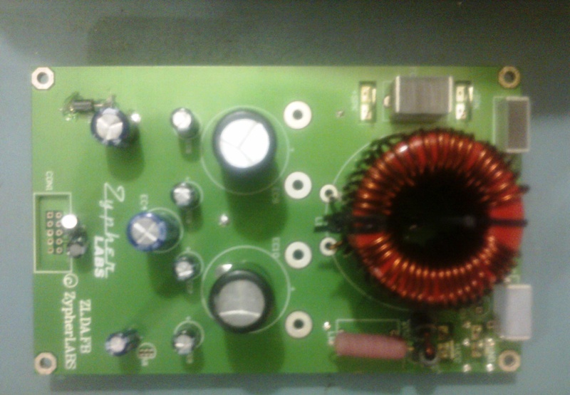

Mine 2KW using 4 X IRFP4227 in full bridge mode, single supply and common inductor. SWF=325KHZ. IR2110 used with buffered drivers from Zetex.
Performance measurements?
What modulation you are using, AD / BD ??
stay tunedPerformance measurements?
AD using Post filter feedback
Hi Workhorse
Looks great.
Where are the output mos? (don't see any through holes ...) .....
Do we get to see the other side of the PCB?
Why do you opt for full bridge? Seem to remember your last design shown here was a half bridge with +-200VDC PSU ...... so why the change in topology?

Hi Baldin,
Cant you see 4 holes between output inductor and 2 black electrolytics?
I wanted to TRY my hands on fullbridge also i did it
The access to otherside of pcb is restricted

With sweet things such as IRFB4227 being standard parts now, 200V full bridge can perform better than +/-200V half bridge. No need to care about body diodes as long as recovery di/dt and dv/dt are under control. I'm about to try 40A peak from four IRFB4227 (with a lot of effort put into layout and gate drive as usual), giving 3200W dynamic power (before supply sags) into 4 ohms. 36A (2600W) works fine.

The only disadvantage of full-bridge amp is that you cant bridge 2 modules as in half bridge amplifiers.

Full bridge, 1 ground referenced leg (with filter of course!) will be bridgeable...That's what I do in my HVI series!
Yeah Grounded bridge is only topology which can be further bridged.
But how do you get rid of huge EMI created by the virtue of floating rails which are switching at 250khz and also the electrolytic filter cap connected between rails will also act as EMI inferno generator for sure.
