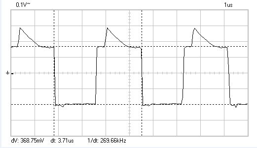

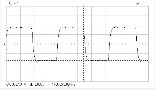

After further work, I can't help to think it has something to do with the use of LT1711. My daughter board with either MAX913 or MXL1016 works without problems. The current drawn by the LT1711 also seems quite excessive ... being 30 mA DC and AC peaks of same magnitude. This also stresses the small regulators made by single FZT657/FZT757, which becomes very hot.
I'm driving the LT1711 +-5V at both input stage and output. This should be possible according to the data sheet, but I'm begining to thik that this is maybe not a good idea after all (and not really necessary either).
But I like the look of the output of the 1711 ... it's just so square and clean ...
Looking at the output of either MAX913 or MXL1016 it looks nice on the unloaded output, but loaded by the levelshifter circuit it looks a bit strange (see picture below .... second picture is the output of the LT1711).

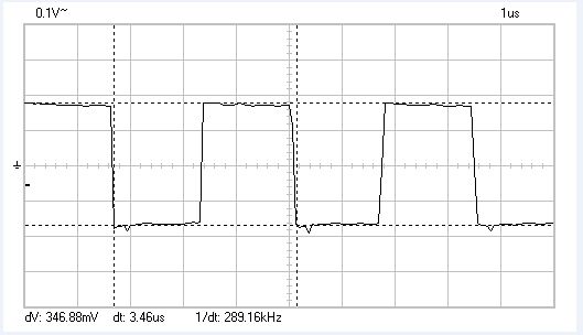

Ok, tried it out in real life ... just kept R3=2k2 and R5=2k7 for startes.
Both MAX913 output and Level Shifter output looks much better.
Speed is faster also, caused the switching freq to shift from 270 kHz to around 290 kHz.
Will sim a little to find lower values for R3 and R5, which will not burn, to get even better and faster shifting
