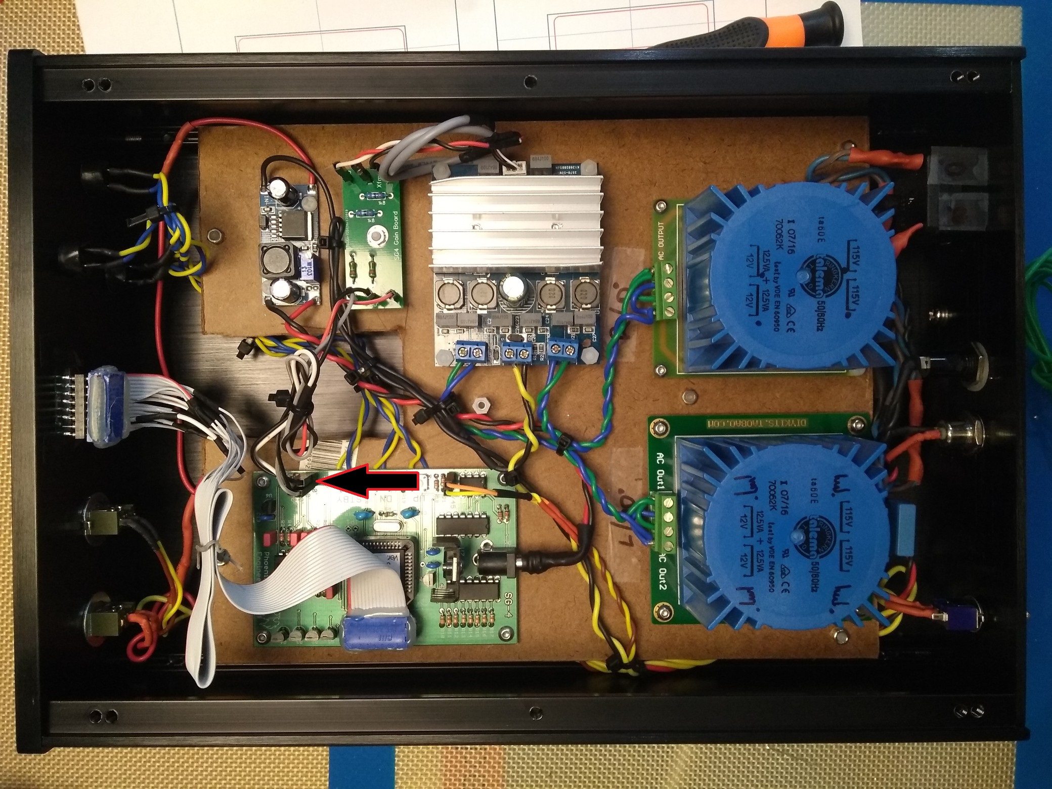

I spotted something amiss at the SG4 output connector. I can't be sure if the wiring is correct from the picture. I seem to see you could have plugged in wrongly.
The bottom row pin at the output is all common ground. The upper pins are the individual phase output. The picture show one connector plugged to 2 ground pins and the other 0 & 90 degree pins. Check again.
I probably should have used different wire colours so it could be less confusing. Here's what I've done regarding the SG4 output:
The ground output for 0&90 (black and white wires) are joined together into the red wire going into the ground input of the gain board.
0 phase (gray wire) and 90 (black wire) are individually connected to their inputs on the gain board.
I found something strange.
While on 33 RPM and with stable speed, I cant toggle the switch to 45 RPM and the platter will spin at 45 RPM (with a lot of vibration). But if I remove the belt from the pulley, set the SG4 to 33, turn it on and then change it to 45 RPM, the motor will stop.
The motor will also stop if I remove the belt with a pencil while it´s on and at 45 RPM.
It only works with the belt on as if the platter´s inertia is acting directly into making the motor spin at 81 Hz.
Is this with a Hurst motor? I have 5-6 of their motors and some will run with dual phase at 45 RPM and some will not. It seems to be related to the bearing vibration; some of the motors have a brass collar to control this. I contacted Hurst in an attempt to find an answer to this, but they did not have any insight.
It might be better in your case to run single phase and switch the phase cap between 33 and 45 RPM.
