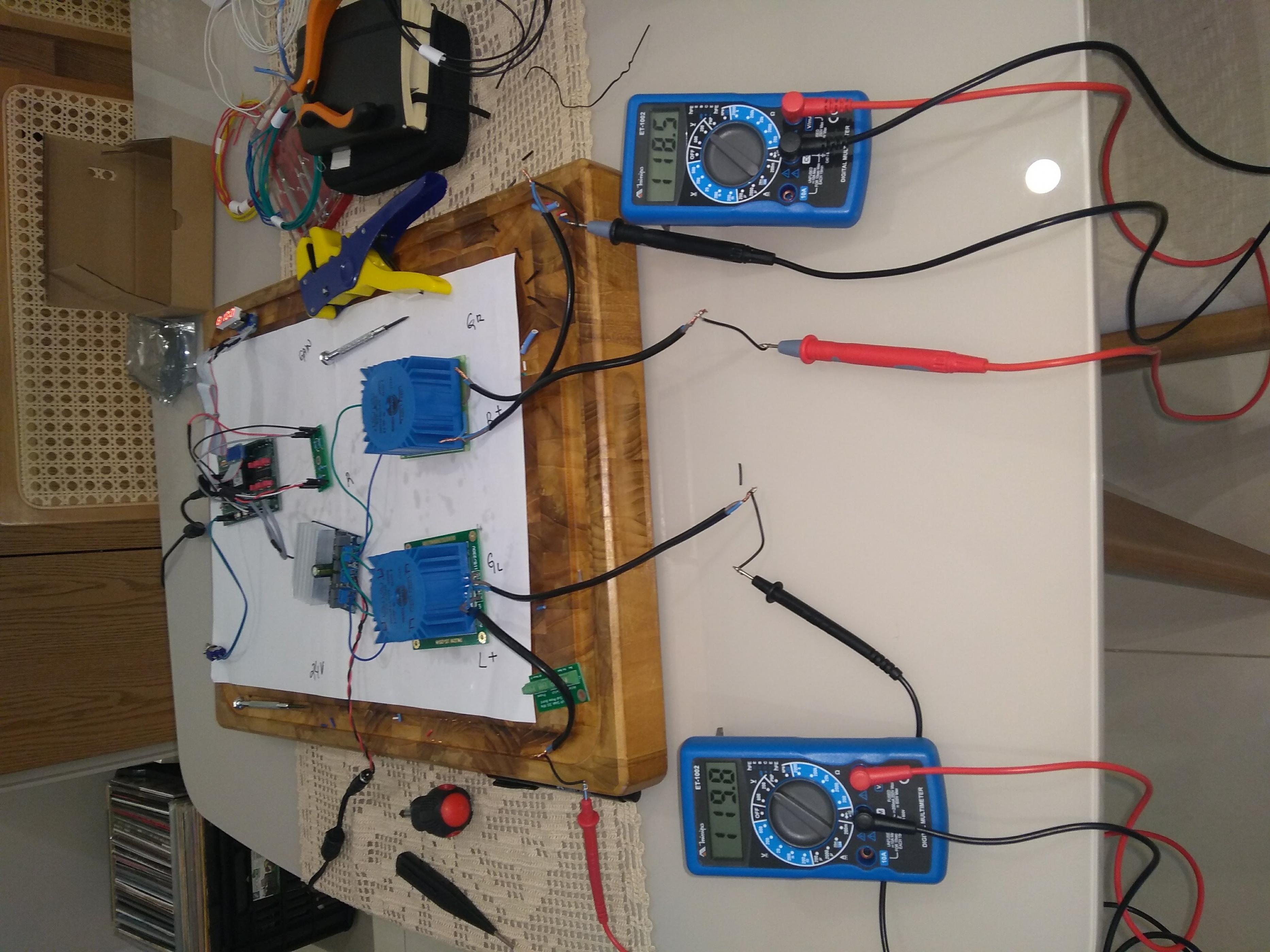

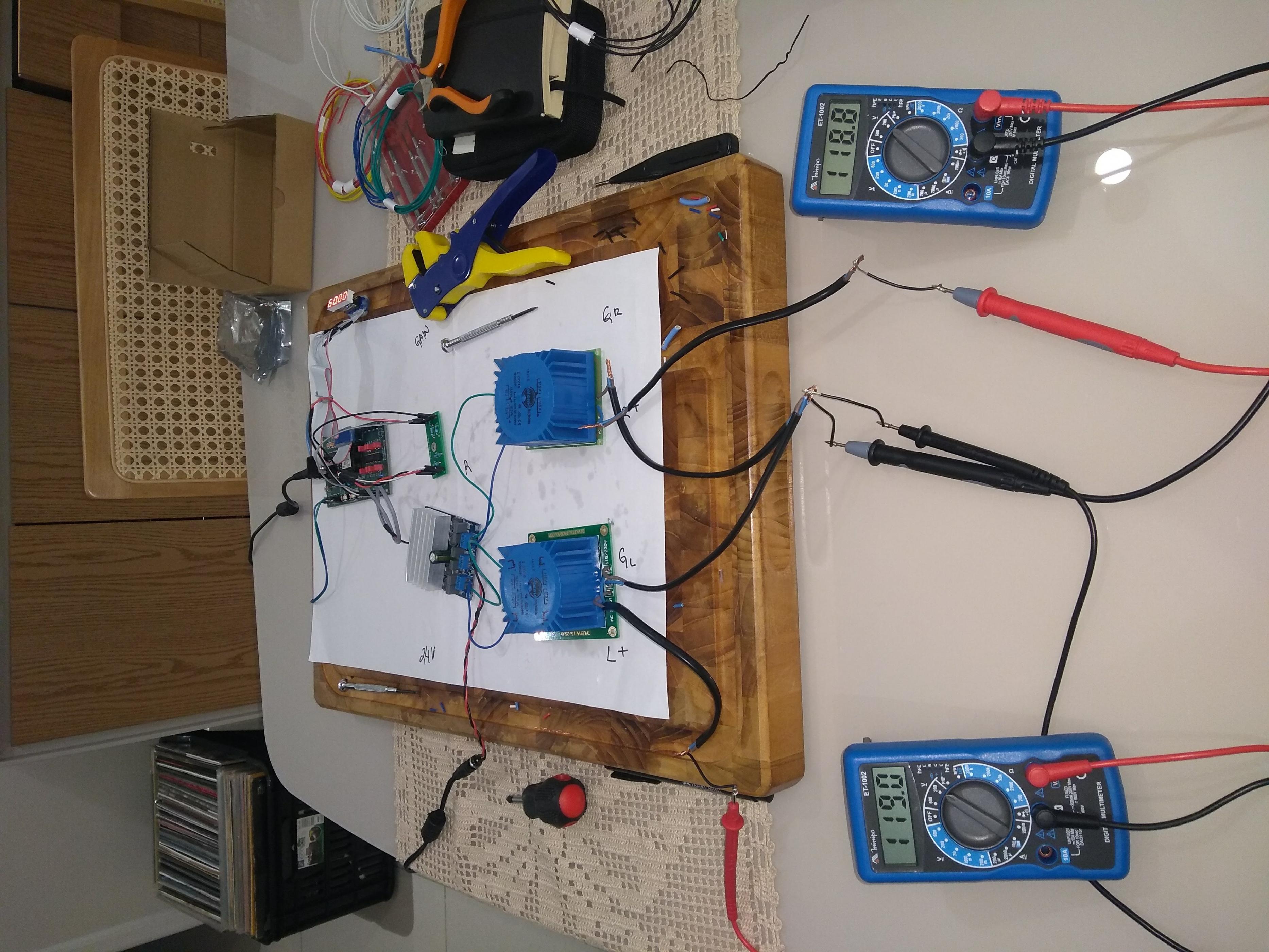

I'm running a long test and this is what I'm getting:
1) power both SG4 and TDA at the same time - SG4 starts in Stand by
2) While in stby, set 33 RPM on the toggle switch and exit stby
3) 119.1 VAC and 118.9 VAC (two multimeters connected at the same time)
4) Press Stand By and then switch to 45 RPM and exit stby
5) 119.8 VAC and 118.5 VAC
If I change the speed without pressing stby before, the TDA crashes. If I unplug both SG4 and TDA from the outlet and replug, the TDA does not work. I have to let the SG4 in stby and unplug/replug just the TDA in order to get them working together again. Is this normal?

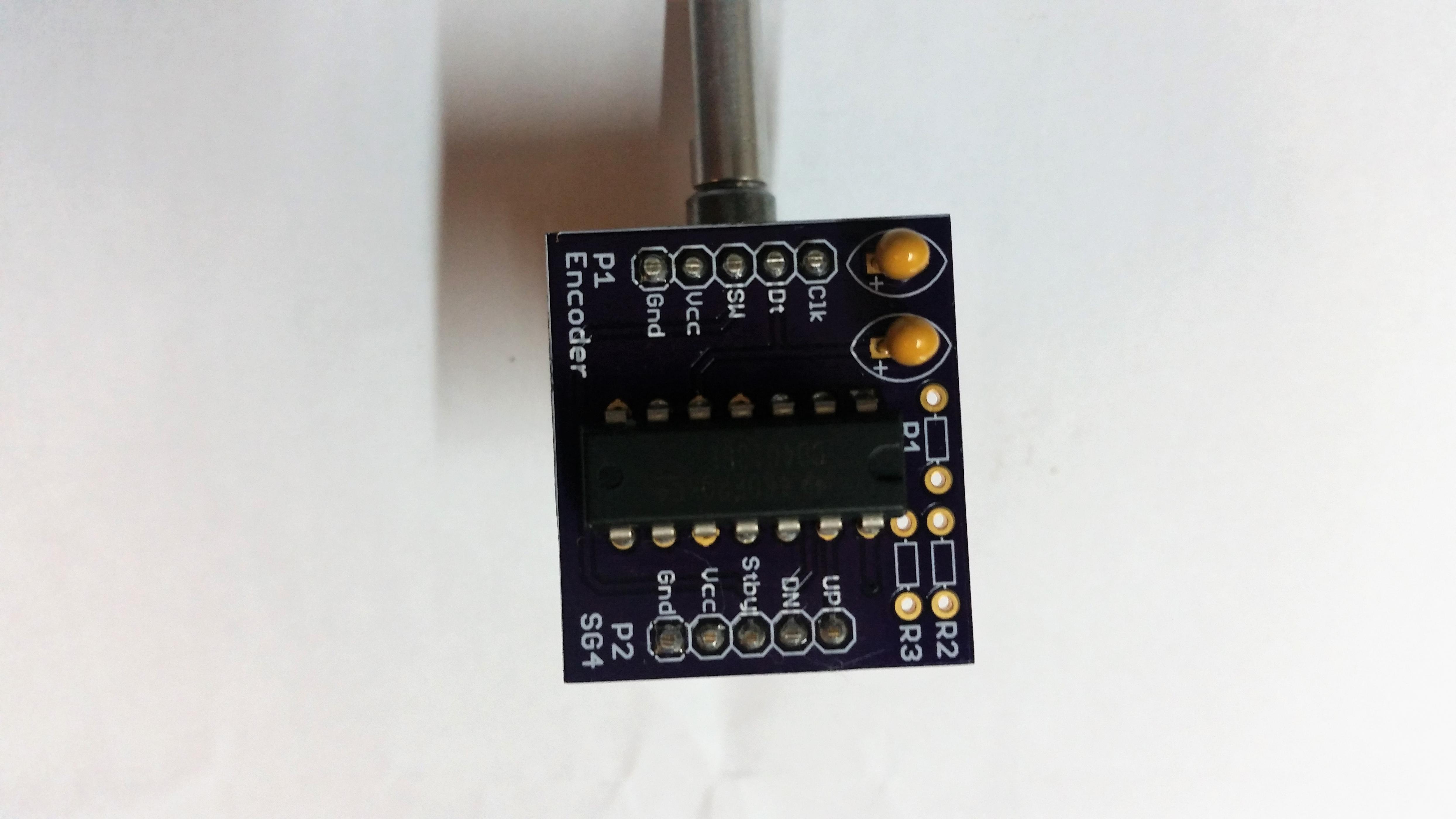

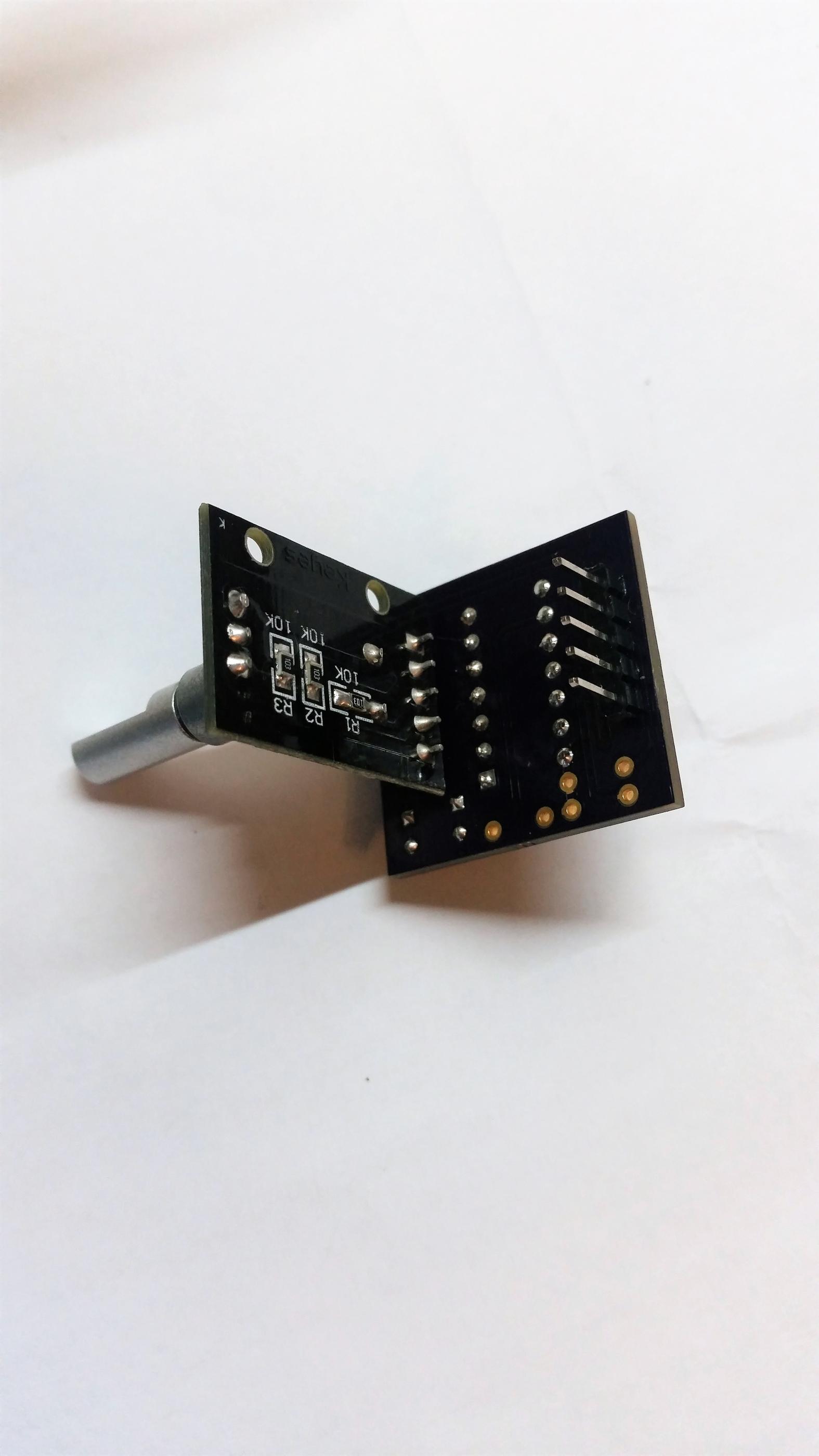

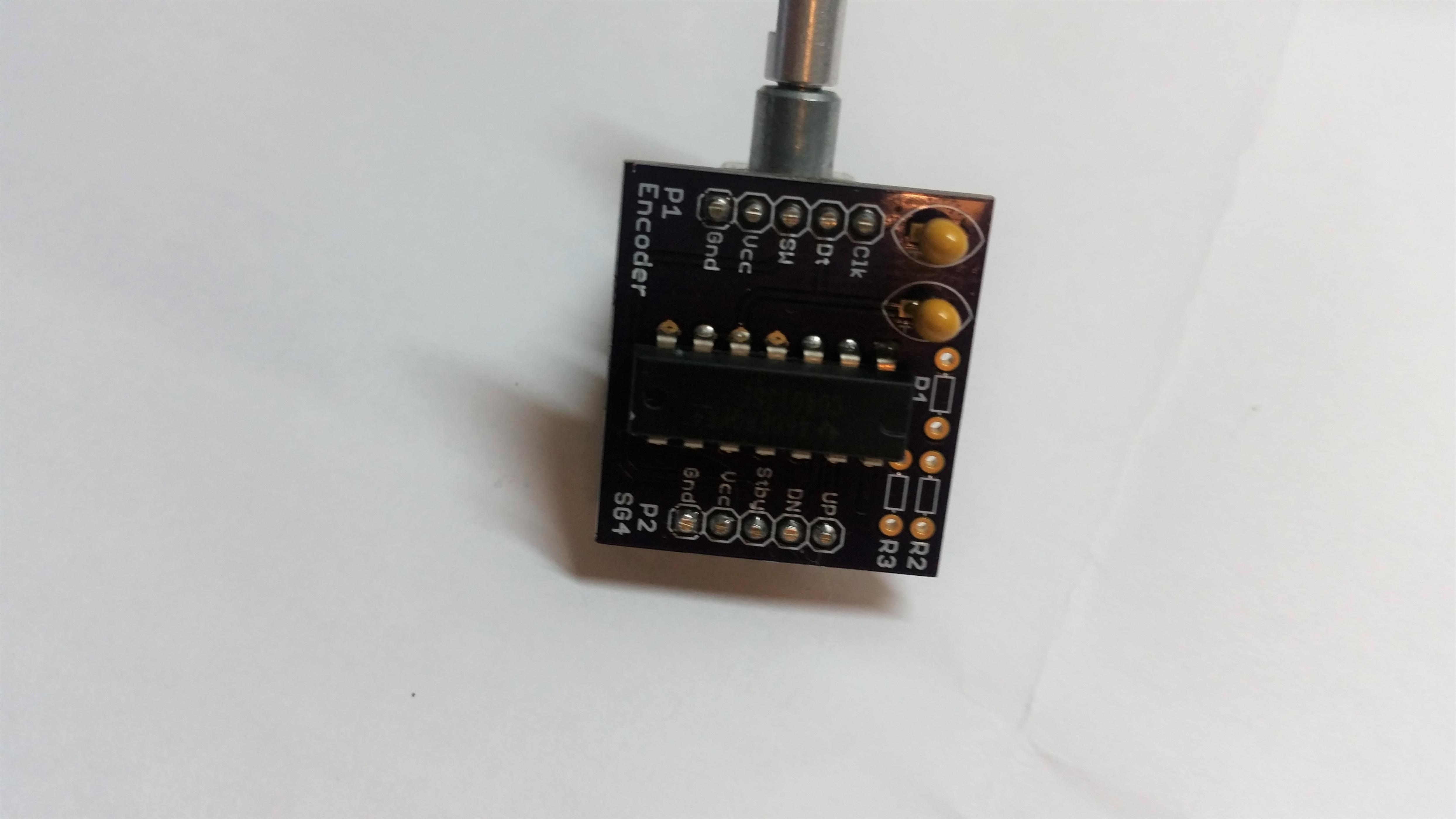

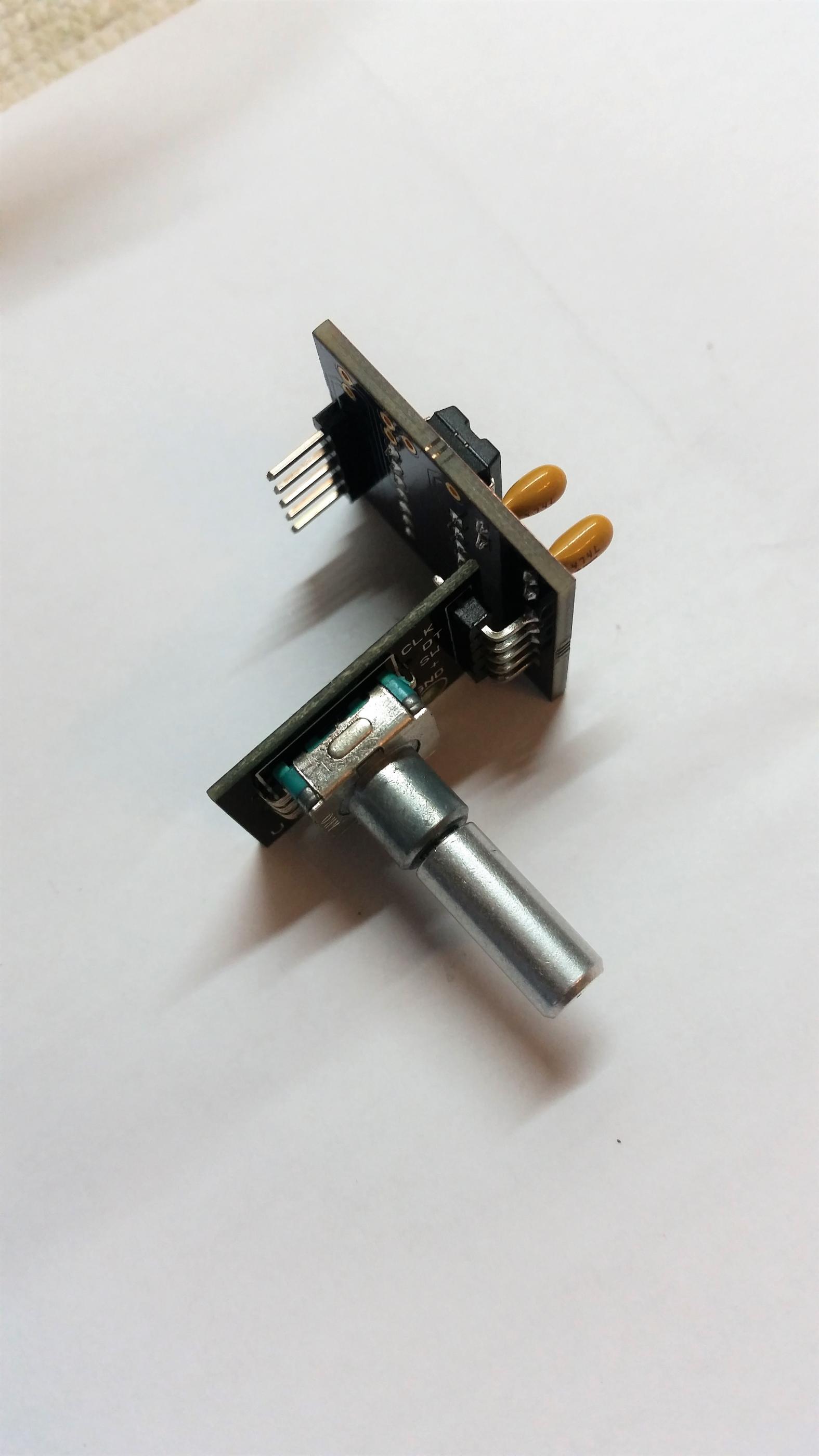

I have to say the optional Rotary encoder for the SG-4 is a very cool and beneficial feature. I don't think I can do without it.
Pics show my build of the Rotary encoder. The encoder is a commonly for Arduino which already have a couple of pull up resistors, some compatibles may have one resistor missing. Don't think that one matter much.
If the encoder have 3 smd 10k resistors installed, then no need to install any (R1 to R3) at the encoder pcb.
