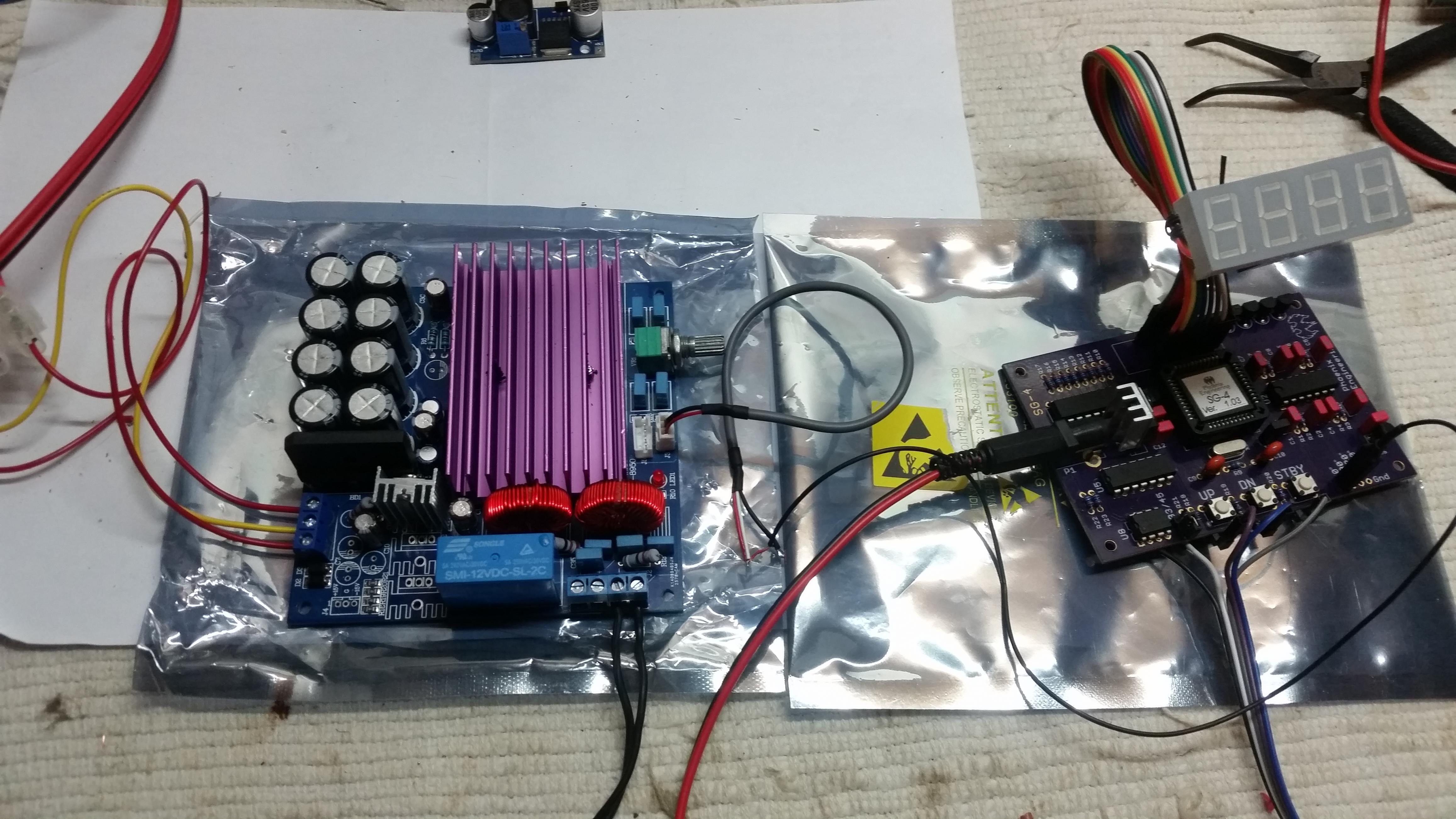

My Class D TDA8950 module arrived today. This is my first experience rigging up such a module for audio or a speed controller in this case.
I observed the following prior and after rigging it up.
1) Its got a miniature 50k stepped volume pot.
2) The onboard volume pot may be practical for audio but later measurement at the amp output revealed a slight variance in each channel after mono'ed both channels at input sourced from from SG-4.
3) I didn't have the right step up transformer on hand at this moment now, (since I wasn't sure either a 12V or 15V transformer is suitable. I used a 160VA 15V/230V transformer for test purpose connected to one side. I had to carefully crank the volume up till I saw 17V+ on the multimeter and anything beyond that, the onboard relay shut it down. I also monitored the transformer output for 230VAC maximum. The other problem was it wasn't stable, the amp started to misbehave and was unstable.The voltage wouldn't hold stable. I don't know why this happened, Its stable if the transformer is disconnected from the amp output. 2nd test was to connect the each 15V winding to each channel, the voltage wasn't present. Something wasn't right.
I don't know if the the amp have issues, insufficient voltage drive or this transformer is plain unsuitable. The transformer is not defective for sure, since its being used in a DIY PSU. Next up was a spare small 10VA 9V/230 transformer. It was stable.
4) The volume pot. I think I've to replace this to a resistor network for best results.
5) Input voltage to Amp board is 22V-0-22V (a transformer I have on hand)
6) I opened the heat sink and found questionable heat sink compound on it. I cleaned it up and applied something better that I have.
7) This amp pcb have got some blank places which I reckon is for an optional LM317/337 circuitry and +15- 0 - -15 output for some purpose. I may work on this to add a LM317 configured for 12VDC to power the SG-4 later on.
Its already got a LM7812 to power the onboard relay circuitry.
8) Second last, is the output inductor coils that are finger hot to touch, even when no load. I hope its not supposed to be like this. I could blame the 160VA transformer for this.
6) Last but not least. I found the output terminals wrongly marked. its marked as L-, L+ R-, R+. I found that L+ and R- terminals are common.

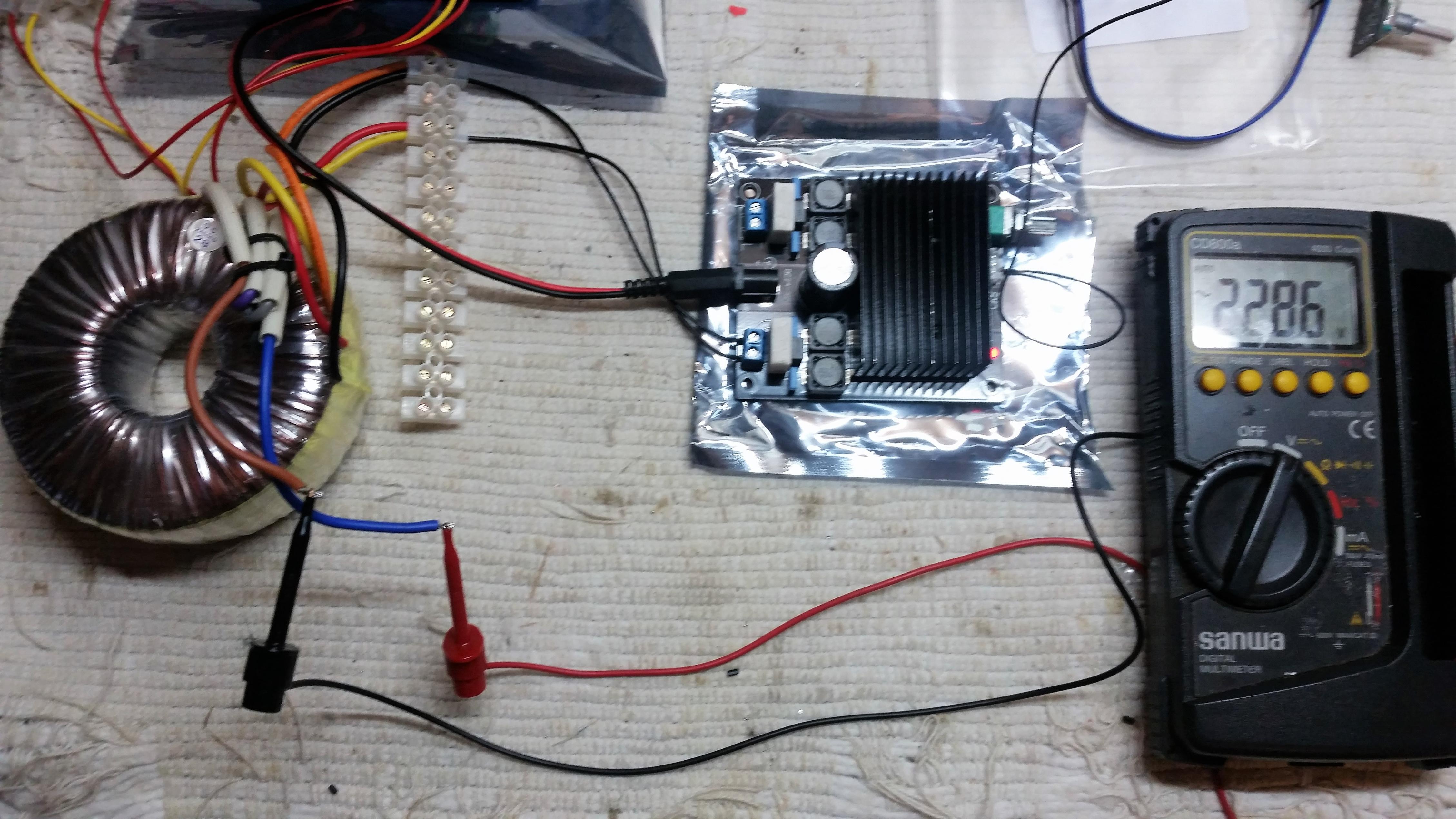

Late night development.
I've got this TDA8950 amp to work and will power up the output step up transformer after some experimentation. It will now fire up test 160VA/15V/230V transformer with 15V winding connected in parallel to full output at 230VAC/50hz. Amp output voltage is 16.8VAC. Its looking good with no sign of unusual temperature rise and LPF coils now finger warm. Main heatsink is also finger warm. No load dc offset is near zero at BTL connection but still 100mV at each individual channel. The main change was the windings are connected to the amp as if in BTL mode. If each winding is connected to each channel, it simply won't fire up and its like a short circuit. However, each channel will output half the current voltage and only work with smaller VA transformers like the 9V/230 type earlier.
Connected in BTL mode, it seems there's no difference whether I jumper the board for SE or BTL. The only way this transformer will build full output is to connect in BTL mode at the output. At this time, I seem to realise this is a perplexing amp module.
Next test is to scope the output waveform and apply a motor load. I think I'll defer the 2 phase idea considering this TDA8950 module is a problematic specimen.
I'm now waiting for another TDA7498 amp module to arrive and I shall see what gives. I've decided to use a 12V transformer instead of 15V type.

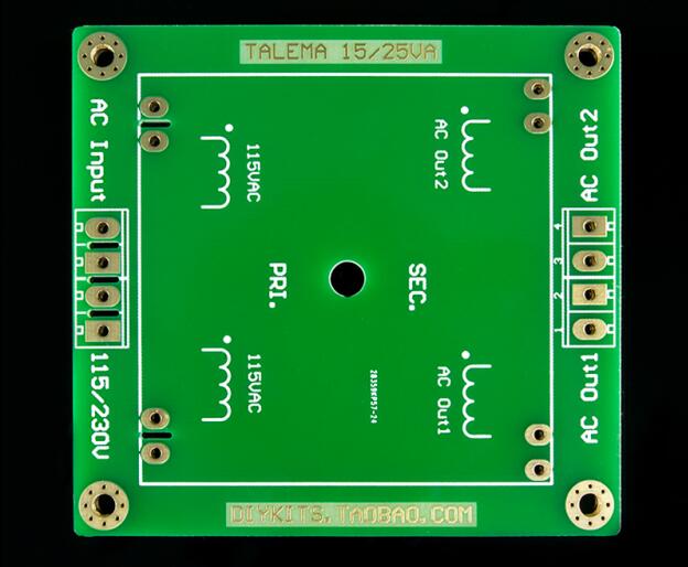

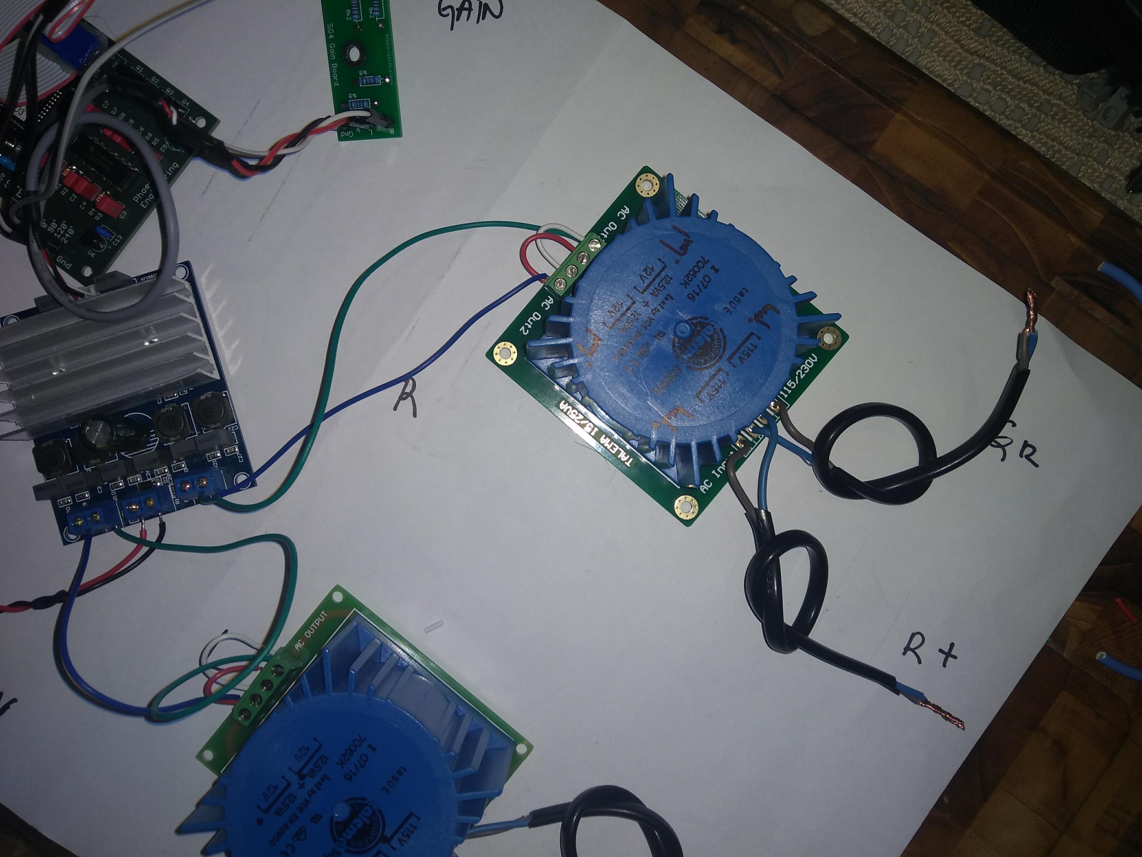

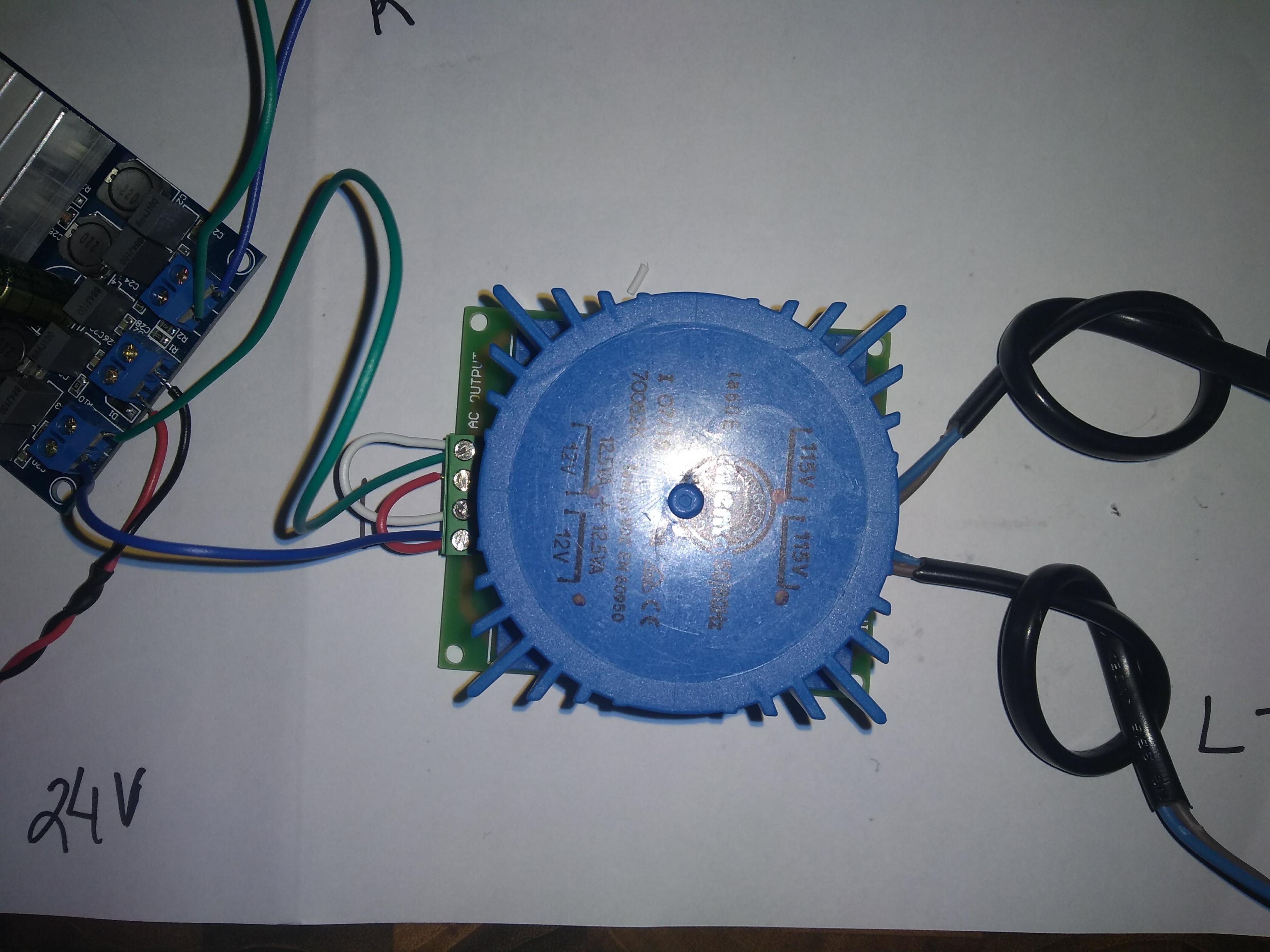

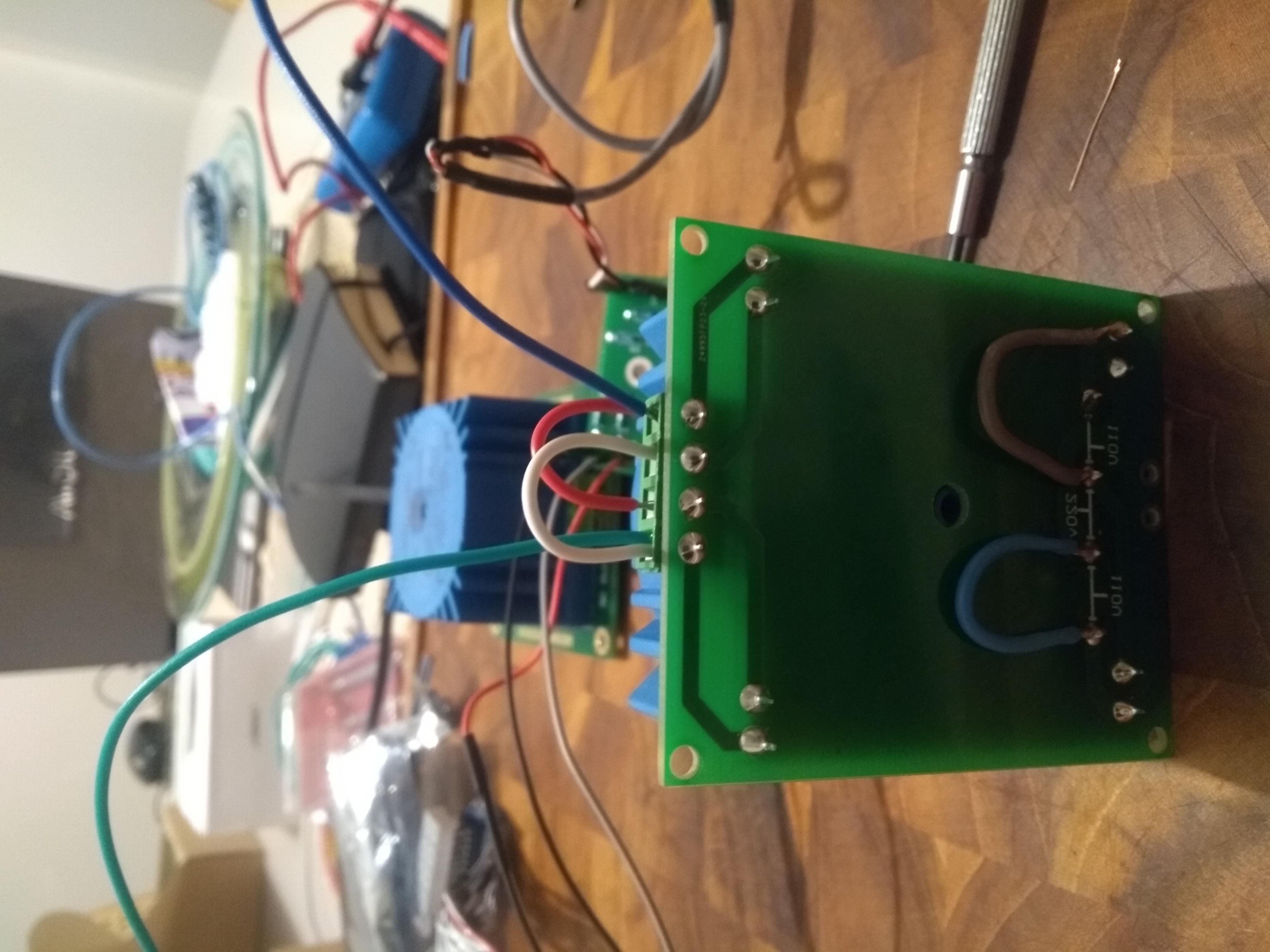

Hello Bill,
I'm getting 14 and 14.2 VAC after the TDA but nothing after the transformers. It's a pair of Talema's 70062K 25 Va 115/12 V and I think I've wired them as the picture you sent me on #136. Dots with Dots, non Dots with non Dots, both in and out of them. I get short circuits everywhere.

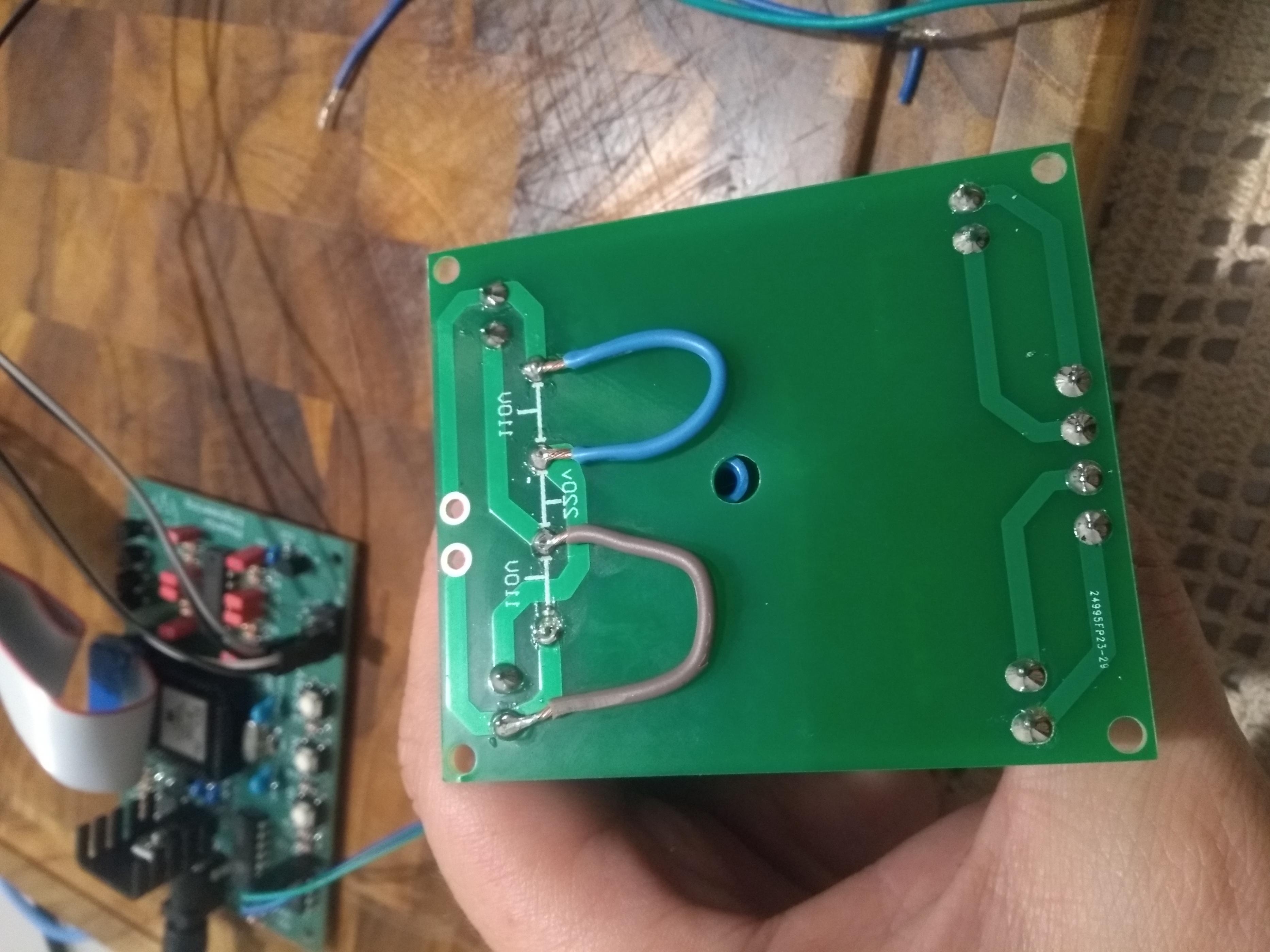

They came with a mounting PCB each, but different ones. I got the dots markings on the transformers by looking at the PCB printing.
The pcb with the wire jumpers has only two holes as original AC Input (used here as output) but after soldering the jumpers (the damaged hole was an accident while trying to remove a first attempt jumper) , both holes are shorted.
The last picture shows how I'm wiring the transformer to the TDA. Green is Negative and Blue is Positive. That also resulted on a short circuit.
One possibly very dumb question: Each transformer has 4 sets of two plugs. Is it normal for each plug to be shorted with the second one from each pair?
I don't know what I'm doing wrong, could you please help me? Thanks!

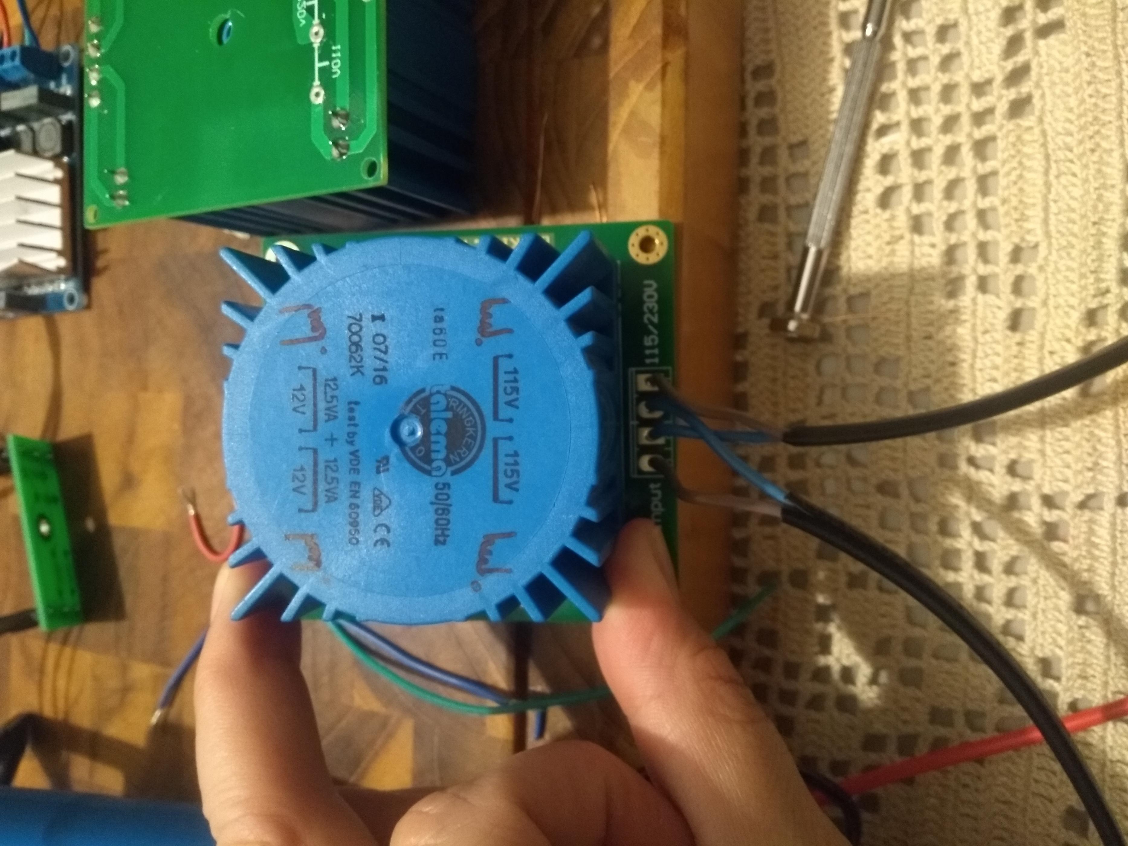

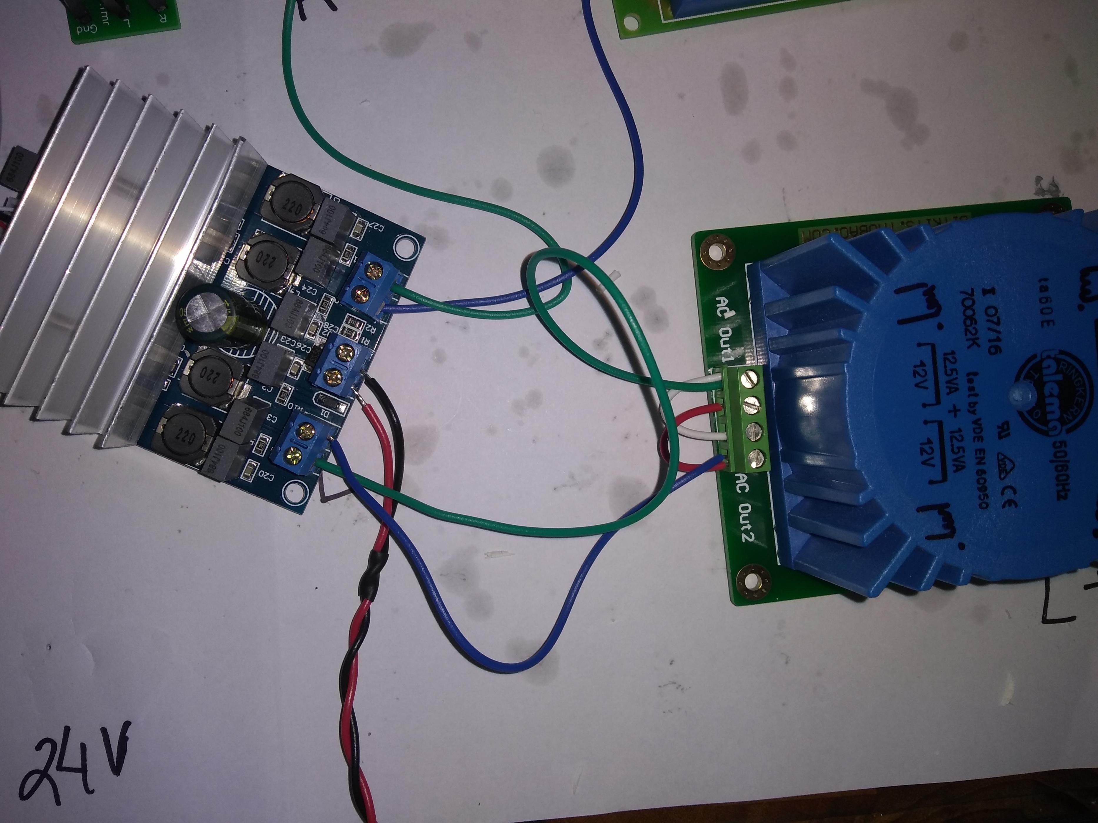

It's difficult to tell what you are doing; you have 3 different arrangements and I can't tell what is connected in each one. Pick one transformer & PCB combo and let's stick with that to troubleshoot.

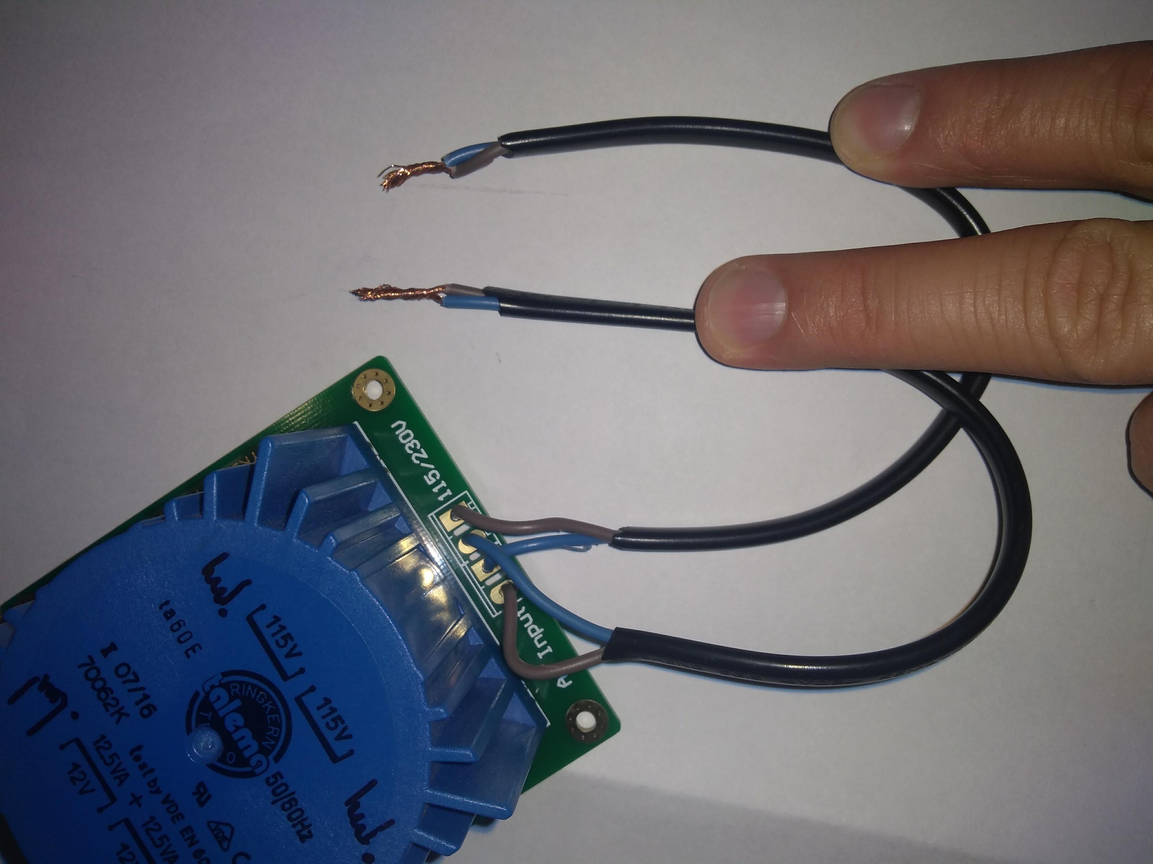

Your first picture definitely looks wrong. You have 2 cables connected to the 115V outputs, but each wire from a cable goes one side of each winding. Again, I don't know what your cables are connected to. If you are connecting the output to one of the motor windings, then use only one cable and connect the blue and white wires as shown in the attached drawing.
The 4th picture looks OK for 115VAC output. This will drive one winding of the motor, not both. If you drive the Blue and Green wire with one output channel of the TDA amp, it will produce 115VAC on the HV side of the PCB.
Each xfmr has 4 windings; 2 primary (high voltage) and 2 secondary (low voltage). Each winding has 2 pins, in pairs close to each other. You will read very low resistance between any two pairs of pins, especially the low voltage secondary windings will be a fraction of an ohm. This is normal.

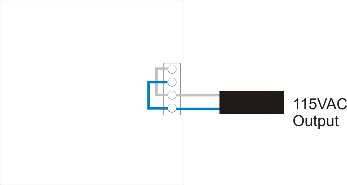

If you can follow the schematic in post 136, it should work as drawn. Maybe someone local can assist you with the connections? If you are not comfortable working with high voltage, please seek competent technical help, otherwise you risk personal injury to yourself and damage to the equipment.

This is what one channel should look like when properly wired. The red and blue wires on the left are 115VAC output and will drive one winding of the motor. The capacitor across the output is .22uFd 400VAC film capacitor.
The Black and White wires are the 12VAC secondary of the transformer and are driven by the output of the amp.

Hi Bill, thanks for the reply.
Sorry for the bad pictures. Here are better ones that shows what I'm trying to do:
The first one shows a whole view of the cables coming out of the transformer. They're two wire cables, with one end twisted into one and the other one connecting the HV pins of the transformer, 1&3 and 2&4. I wired it to be the same as the other transformer (picture #4 on previous post).
The second one shows a complete view of the testing setup, on a dual phase 115 VAC. I did not connect the motor, as I was trying to get AC voltage readings from a multimeter at the output wires. What I understood from your previous posts, R+ and L+ are each one a Phase for the motor, and the Gr and Gl should be wired together to form the Return. I tought that this way would make the transformer capacitors not necessary.
Without the transformers connected, I get 14v readings from the TDA outputs. With the transformers connected, I get 0v.
I also get 0v from each pair R+ Gr and L+ Gl.

2) The TDA outputs 14v with nothing connected;
3) The TDA stops (failsafe/shutdown mode)? working If I short the output and I need to reset it to start working again;
4) If I connect the DOT with the positive and the non dot with the negative outputs from the TDA, it gets shorted and goes into shutdown mode.;
5) If I connect the DOT with the negative and the non dot with the positive outputs (as the attached picture) from the TDA, it works. I get 118VAC and 119VAC from each transformer.
If this last configuration is the only way to make it work, then I would need to use the non-dots output (118VAC and 119 VAC) from each transformer as a phase to the motor (red and black Hurst wires) and wire the dots output from both transformers together to make the return wire to the motor (blue hurst wires) ?
I also removed the TDA´s heatsink, cleaned the original thermal paste and applied a better one.
I had time to make some tests today before work and this is what I´ve found out:
1) The transformers and wiring are ok. I tested them on the AC outlet of my house (120V) and got a 14V on the other side;
It shouldn't matter whether the dot end of the windings goes to plus or minus on the amp, as long as both dot ends are connected together in parallel and both xfmr dots go to plus or both go to minus (do not mix). Likewise, it won't matter if the output dot end is connected to motor red or return as long as both phases are connected the same, that is, both dot ends connected to motor returns (blue) or both dot ends connected to motor hot (red/black).
Also, you cannot connect the xfmr to the amp while it is running (output is 14VAC). When it exits standby, the SG4 ramps up the voltage to prevent the start up current surge from shutting down the amp. If connected at full voltage, the amp will most likely shut down.
Ok, got it. I´m gonna set up a long test and if everything is good, I´ll start working on the final chassis build.
I still don´t get why the 4) does not work and the 5) does... I´ll make more tests.
I never connect or disconnect any wire from the transformers anything is on. I had both DC adapters on a extension cord and everytime I would connect or disconnect anything, I switch them both off.
