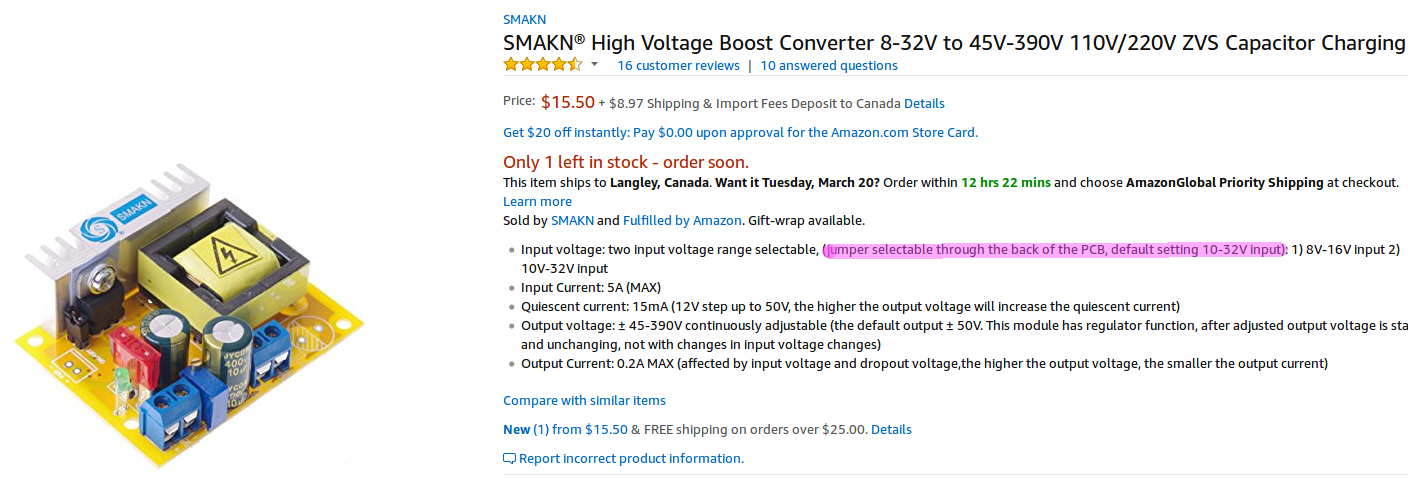

the ad claimed it would indeed live on 19V, and that had been my plan. So now we know - the hard way - that it won't.
The one I fried may not be the same one you are looking at. I had two of them. I looked for it in my Amazon orders history and find two boost converter boards, neither look like the one I fried. Mine might have actually come from Ebay. There seems to be several variants of these things. This one is not regulated. The more voltage you put in, the more you get out. After poofing one rather quickly on a 19 volt brick, I wired the other one to a variable power supply and stopped turning the knob when I saw about 450 volts.....it has a 400 volt cap in it. Maybe it will live on 19 volts if loaded heavy enough to stay under 400 volts.
I'll try it again if I can find it, but I have decided to do something that ended in fireworks and lots of dead parts last time I tried it......DIY SMPS. Last time was about 15 years ago. Parts and computer modelling have both gotten a lot better since those days. So instead of collecting a bunch of Chinese modules, I bought a box full of parts. The rolls of wire to DIY the transformer just arrived. Maybe next week or so, I hide behind something and plug it all into the wall outlet.

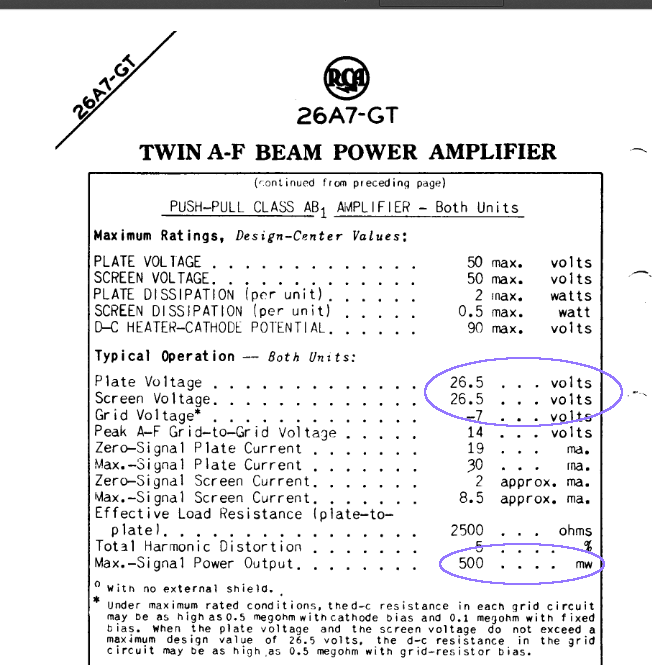

I was debating between the 26A7 and the 28D7. Figured the 26A7 would be simpler without the AB2, but that was before seeing your results. Maybe the 26A7 might like being fed some grid current. No shortage of heat, 26V and 0.6A for the heaters. I was wondering why the plate dissipation was so low, 2W but with 16W already cooking.
I scratched my head over that (2 pentodes, only 8 pins) until I looked at the datasheet. Ah, only one pin for both screen grids!a 26A7 dual pentode common cathode in an octal tube.
I think the 500 mW is for a B+ of only 26.5 V (see attachment.) With 50V B+, you might in an ideal world see four times that output, a thundering two watts.Rated at 50V into 2.5k Class AB1 a whopping 500mW.

The one I have is shown in the attached image. It seems to be sold under half a dozen different names, but the one constant in all the ads I found is the number "390". The letters "ZVS" show up in many, but not all, of the ads.The one I fried may not be the same one you are looking at.
The ad copy claims there is a jumper to select input DC voltage, and one of the ranges will accept up to 32 V DC.
My recollection is that another diyAudio user brought this module to my attention some months ago, and he said he had been running his off a laptop power supply, and using it to power a single-ended 6V6 amp of some sort.
Some months ago, I bought a class-D audio power amp module from the Canadian version of Amazon. The ad copy included the sentence "Output power: 100W+100W (Vcc = 36 V, RL = 6Ω, THD: 10%)". When I looked at the board, I found 32V filter capacitors right across the power rails.I...stopped turning the knob when I saw about 450 volts.....it has a 400 volt cap in it.

I think there are a lot of "390 volt" boost boards out there, and the reason for the 390 volt spec is the 400 volt output cap.
That's definitely NOT the same converter I have. I can't find it now, but your ad copy states "regulated" and dual range input. Mine did not, and did not look like that. Mine looked like a 12 volt to 240 VAC automotive power supply with half the parts missing.
I may look for one like yours the next time I order from Amazon. Depending on how the 6AK6 testing goes, I may want something that can make 250 VDC from 8 to 12 volts worth of batteries.
