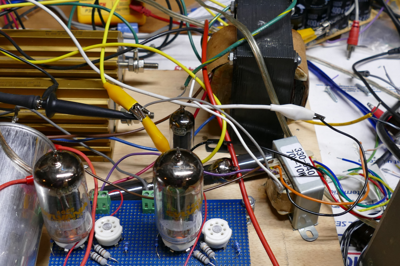

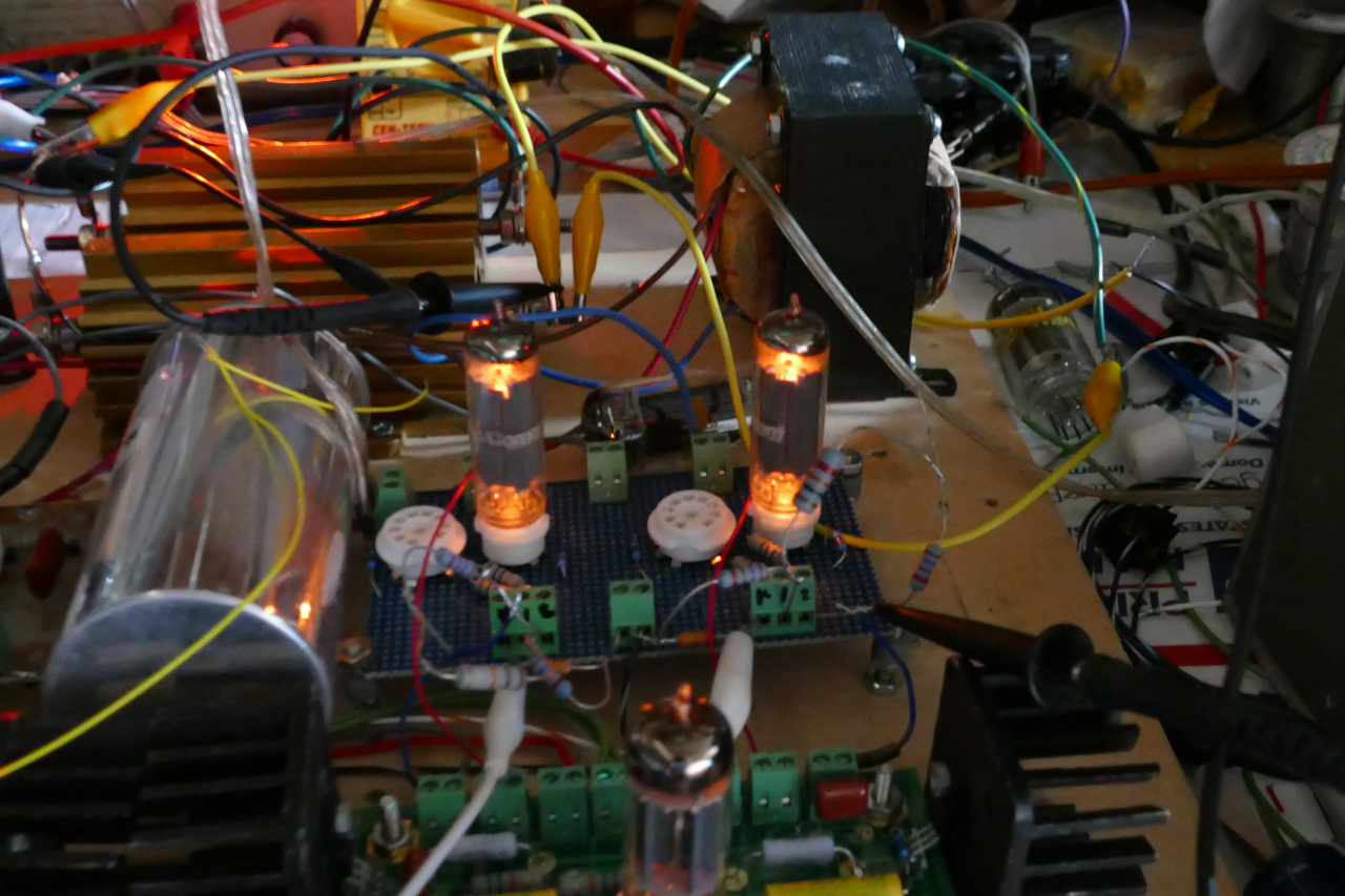

We, or at least I know that the $4 transformer lives in a push pull 32ET5 amp making 4 watts from 170 volts B+.
So what would happen if I take the big OPT out of my test board and wire this little guy in its place and turn the power supply up to 400 volts?
Stay tuned. It's getting dark aand I need to grill myself some dinner before darkness falls. I will have a full report "complete with 'scope shots and meter measurements."
Four hundred volts might be pushing it. But I have had 250-300V on them with 6AQ5's.
My experiments for most of yesterday were done with 400 volts on 6AQ5's, so that's where I started. I thought that the worst that could happen was I would fry a $4 transformer. well, that didn't happen.

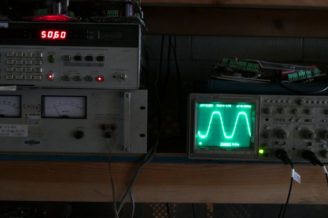

I tested the tiny transformer with 6AQ5's with an 8 ohm load on the 4 and 8 ohm taps at 1 KHz and at 82 Hz. I expected crappy bass performance, and I got it. The bass is there and doesn't sound as bad as it looks, but you can decide how much distortion you can live with and build your amp with that much power. The 10% choice is beyond the point where I would run the tubes.....limit the screen current to avoid meltdown. The current was about what I expected at of below 5% distortion......What I didn't expect was how well these guys passed power, and how good they sounded playing music.
The trick of putting the 8 ohm speaker on the 4 ohm tap doesn't work here. Saturation is primarily caused by AC voltage across the primary, and a 10K load puts about 600 volts P-P across the primary.....no fireworks, just uber distorted bass. Max power at 82Hz was under 3 watts and the tube current was over 200mA.....no good.
I put the 8 ohm load where it belonged and turned up the drive until each distortion level was reached, then recorded the output power. Yes, you can shove 37 watts through the tiny transformer without fireworks.
6AQ5 data for 8 ohm load on 8 ohm tap:
Distortion %: 1% 2% 3% 5% 10%
Power at 1 KHz W: 21W 29W 32W 34W 37 W
Power at 82 Hz W: 1.4W 4.4W 6.3W 9.7W 15 W

At this point I connected my thrift store Cerwin Vega speaker up and drove the amp with my iPAD. I played music and was surprised at the quality of the sound. For most of what I played there wasn't much difference between the tiny transformer and the big one sitting behind it. Even some bass heavy music came through the speaker with the same apparent bass that the big transformer had, but these speakers don't do big bass. They have a 4 inch "woofer." I took some pictures with the same music as yesterday, and they look similar. I can still see 45 to 50 volts P-P across the speaker.
I hooked up my blow proof test speakers (2 X 6 inch PA drivers + tweeter) and cranked some music. This amp gets quite loud through these speakers, and while it won't kick one of my other amps off the shelf, it might be something worth building......
So these little guys may be useful for a super low buck guitar amp in the 10 watt range. I need to try them with a real guitar speaker that has a resonant frequency in the 80 to 100 Hz range. The impedance peak may drive the tiny transformer nuts!
I'm waffling with the idea of simply wiring a 340 volt power supply up to the OPT CT in the 32ET5 amp that I have now to see what happens. It can't do AB2, so the power should be limited to maybe 10 watts......what have I got to lose, a $4 OPT?
I tried it and my guess was correct 10 watts happen. That amp is cathode biased. Simply stuffing 340 volts on the plates makes the idle current 50 mA per tube so the cathode resistor must go from 150 ohms to 250 ohms. That gets the idle current down to 25 ma per tube and burns 20 volts in the resistor. 25 ma is still a bit high so more resistor, and more wasted voltage is needed.

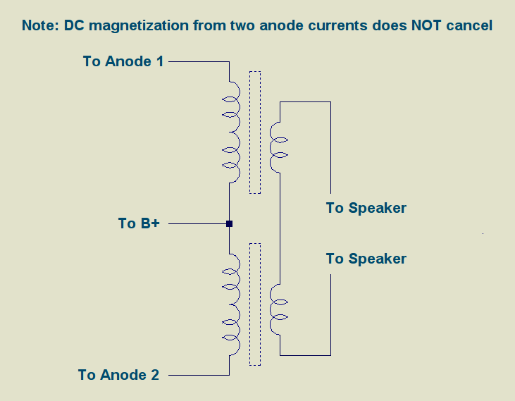

Everything seems to work out for AC currents. But there is a fly in the ointment: DC magnetization from the quiescent current in each output valve does not cancel, because each valve's idle current only flows through one transformer primary, and therefore only magnetizes that one transformer's core.
However: George's high-power recipe does include very low quiescent anode currents to keep the power dissipation reasonable with the high supply voltage. So maybe this will work?
If the $4 transformer can cope with the rather small 12 - 15 mA of DC current through the primary, then becoming a big spender and shelling out $8 for two transformers might work (attached image).
I note that applying a 330V peak (AC) half sinewave to a 3300 ohm (half-primary) results in 100 mA peak AC current from each anode, which the $4 transformer apparently copes with (17W RMS, well within some of George's measured numbers.)
So if the transformer can cope with 100 mA AC peaks, I would think it could handle a 12-15 mA DC current, which is 7 or 8 times smaller. (This is very different from the class A, single-ended situation, where idle current is as large as peak AC current, doubling the total current through the transformer on negative-going peaks.)

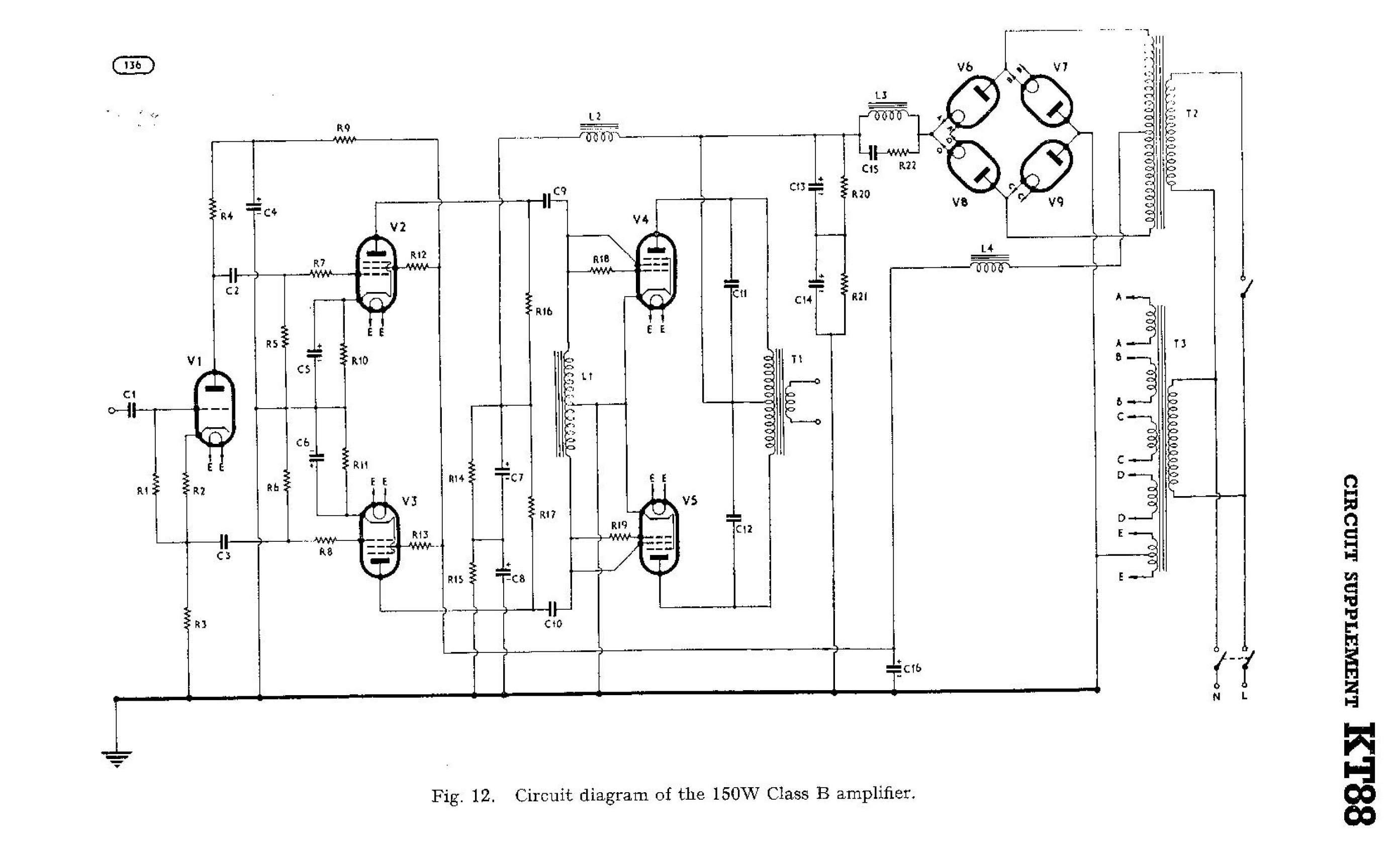

The tube publication is in the GEC KT88 application notes. They get 150 watts from a pair of KT88's on 750 to 850 volts. The app note is too big to attach (9MB), A screen grab of the schematic is included. No negative voltages are needed for this or pure screen drive, both will be tested.

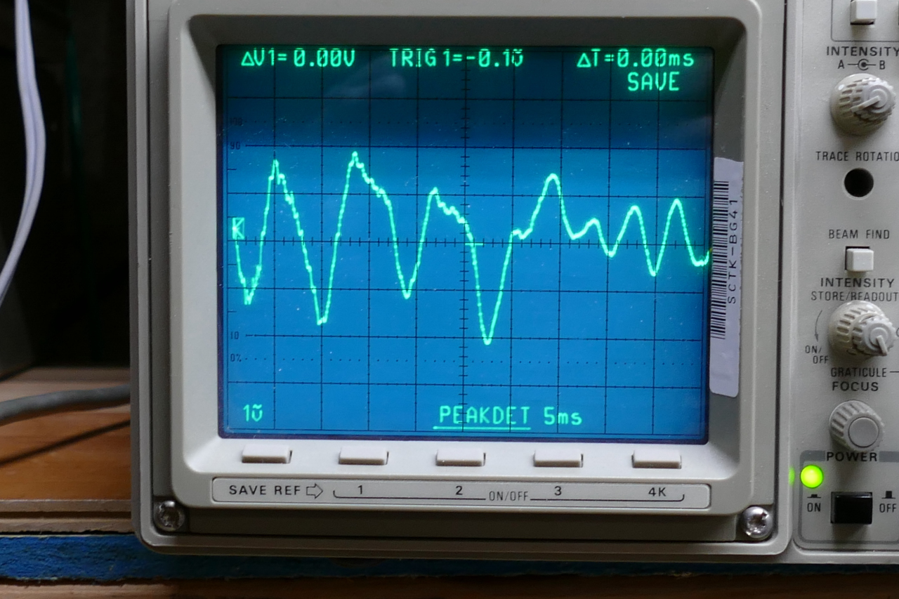

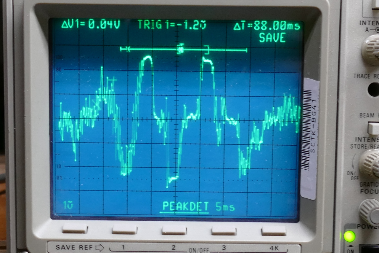

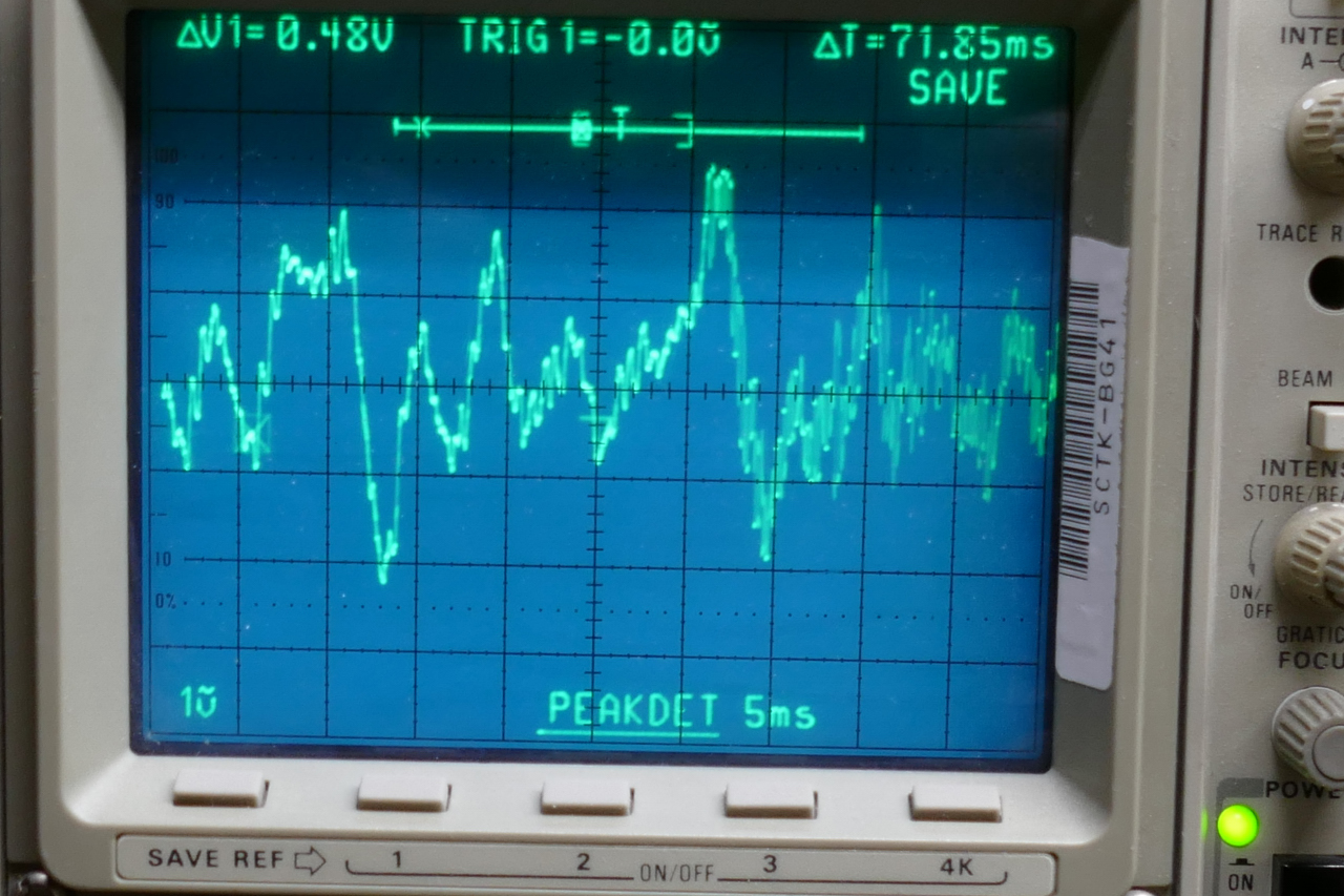

I simply connected my audio oscillator and audio analyzer in parallel across the whole primary and adjusted for 5 volts RMS, then moved the analyzer to the secondaries and recorded the voltage output. I got .143V on the 4 ohm output and .202V on the 8 ohm output. That's a 35 to 1 on the 4 ohm tap, and 25 to 1 on the 8 ohm tap.

I spent the afternoon tinkering with a no-negative voltage circuit similar in concept to what I discussed earlier. Drive is directly fed to G2, and restively divided down to G1. I could get 35 watts out of a 6GC5 on 400 volts with good distortion at all power levels. The 6GC5 should do better on 400 volts so I tried a 50B5. This little guy screamed, but I could not get the distortion good at all power levels. After losing my patience and turning the knobs to the right, I found the red plate point on a 50B5. I was squeezing over 50 very distorted watts out of a pair on 450 volts while poking around with a scope probe. I realized that the distortion issues were because the driver board was running out of grunt. I needed more than 250 volts P-P from a 450 volt supply. There are ways to do this, but not with this board.
After poking around with a scope for about half an hour I noticed a faint red glow on the back side of one tube. These are no name 50B5's, probably Japanese, but they could be RCA's. Who puts 450 volts on a 50C5 anyway?
Code:Distortion %: 1% 2% 3% 5% 10% Power at 1 KHz W: 21W 29W 32W 34W 37 W Power at 82 Hz W: 1.4W 4.4W 6.3W 9.7W 15 W
It occurred to me belatedly that dropping from 37W to 15W is only a 4 dB drop; normal power bandwidth is defined between the -3 dB or half-power frequencies.
So the tiny $4, ten-watt transformer with four times its nominal power pushed through it at 1 khz, still actually managed to work down to 82 Hz only 4 dB down from 1 kHz. I would call that a rather spectacular success.
I can see why there would be little to no audible bass shortage with guitar. Most guitar speakers don't go down to 82 Hz with less than 3 dB drop-off, either.
-Gnobuddy
