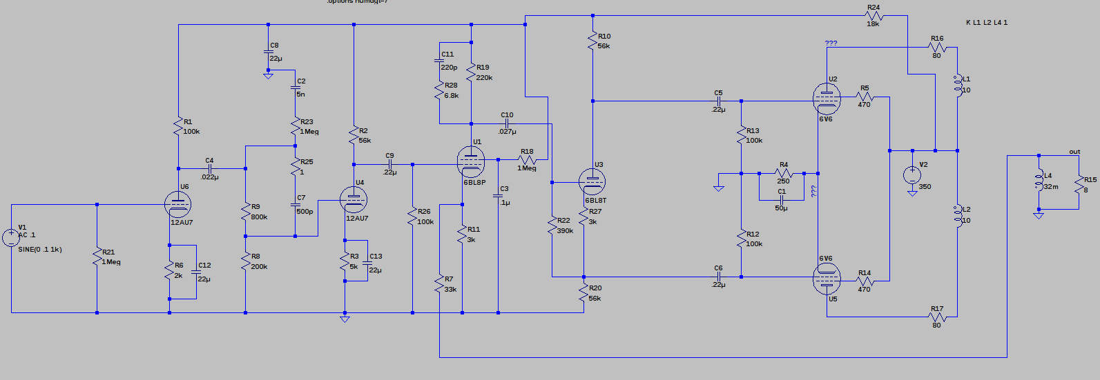

Sort of a mix of circuits. I have some 1.1k primary impedance transformers and was thinking of paralleling up three 6W6GT's to get about 10W. Maybe 6AT6's or 6AV6's for the triodes. I have a 120V transformer that was used in a doubler circuit with EL84's if I remember correctly. It will put out the heater current the 6W6's need. I only have three of them and I like to have a spare set of tubes before I build an amp, I have to throw together the circuit and see if they all work. I could always go with 12W6's which I have a whole bunch of but then I need a separate supply to do the 12V.
So a 5E3 front end that can go to a Tweed and Blackface channel using a four pole switch. The NFB and the jumped inputs are the only other feature.
3 parallel 6W6 (or 12W6) into 1K1 will give 10W easily. B+ of 200V and Vg2 of 125V. About 9V grid drive required, are you shure you have enough gain - I think you would be running with the Master well up most of the time.
Might be tempted to ditch the 2nd input and add its triode into the chain as tone recovery stage.
Else should work fine. 6W6 are a good choice for low Primary Impedance Output Transformer and work well at lowish voltages.

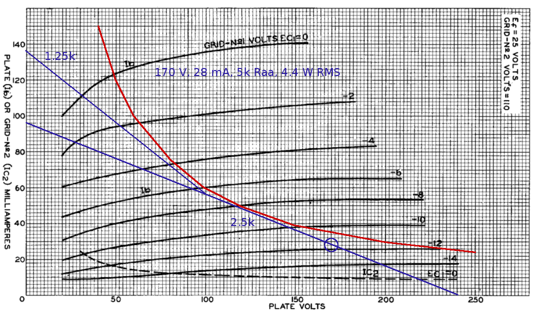

And I thought I was doing okay when tinkering with load-lines led me to find a predicted 4.5W output from a pair of 25C5s in push-pull....50L6...a pair will make 30+ watts when fed enough voltage...340 volts B+, 170 volt through a several K ohm resistor fed the screen.
I know the 50C5/25C5 only has about half the plate dissipation rating of the 50L6, but if you can get 30+ watts from the latter, can you get 15+ watts from the former? And if so, do you happen to know the recipe?

For one you can push the current up The load lines a little as the plate averages out the dissipation and you can go above the dissipation curve as you are cooling off the tubes at either end of the swing. Also it depends on if you want to have the tube last 1000's of hours you run a little more conservatively. Are you running fixed bias? A few more mW's. The 70% rule of fixed biasing from what I recall is in part taking into account the value of the grid resistor, if it is lower you can bump up the percentage. But I have no practical experience squeezing ten gallons out of a five gallon sack.

The 25C5 / 50C5 has a 7.5 watt like the 6W6 / 50L6. It also has a relatively sensitive screen grid, so it should not be emission limited, and should be capable of pulling its plate down to near 0 volts into a lowish load impedance. However I have not tried to go there yet. I would guess the same formula applies within dissipation limits. Screen grid in the 110 to 125 volt range, plate higher, and load in the 3300 ohm to 5000 ohm range. It would be interesting if the plate will eat 340 volts, since that voltage is easy and cheap to get.

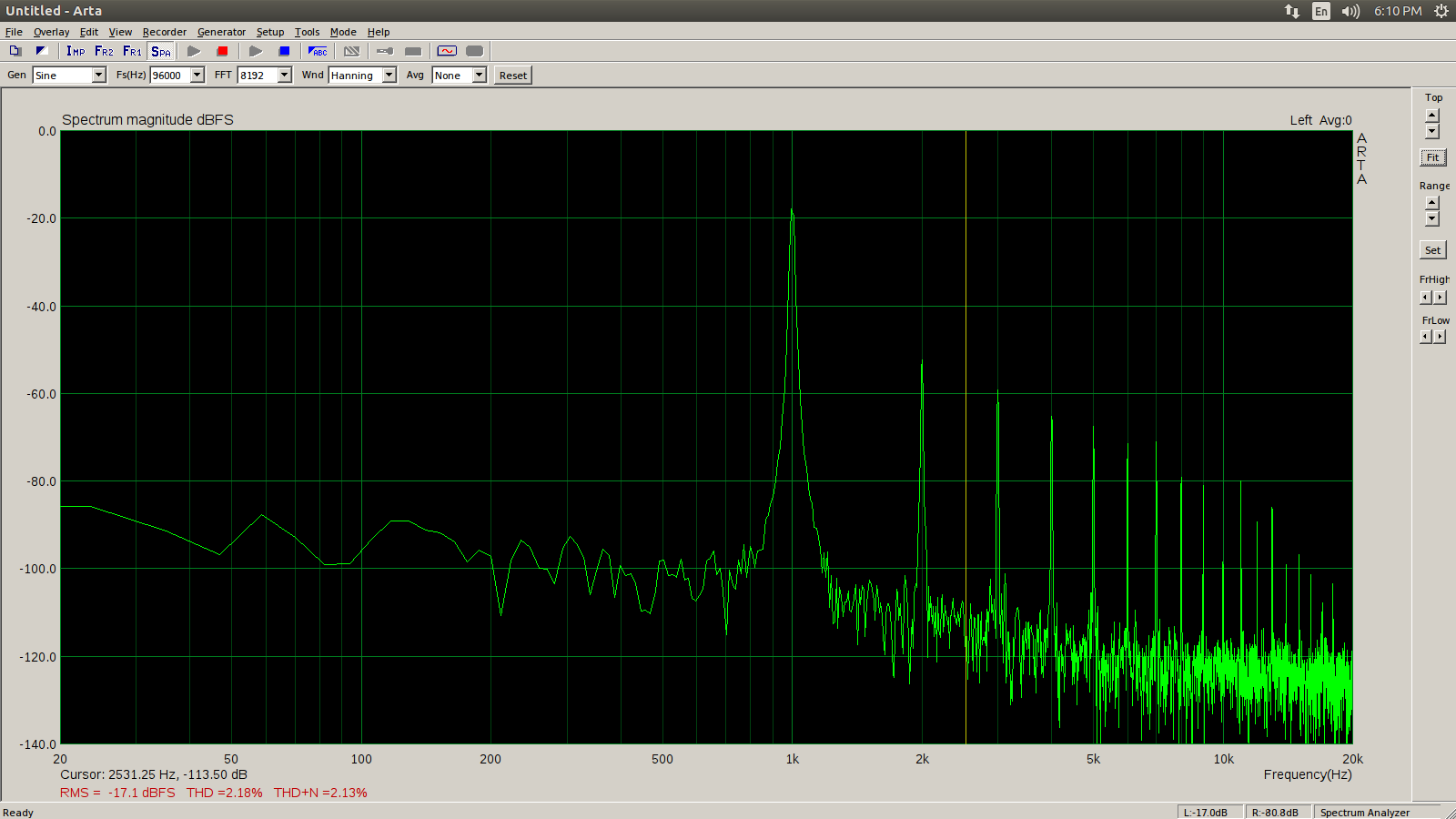

On my latest guitar amp build I wanted to try that too and boy am I glad I did. Most guitar amps as you have mentioned have the pentode as the first stage but I wanted to stick it somewhere in the middle, after a couple triode stages and before the phase inverter stage. Beautiful clean tone that is just very rich and warm. It's a nice 10 watt combo amp, I am currently using it with a Jensen P12R Alnico speaker.
Attached is the schematic, R8 and R9 is the volume pot and R23 and R25 is the tone pot, both 1Meg.
The FFT is at 10 watts. As you can see it has a nice rich waterfall of harmonics.
Thanks for the details. Sounds like a fun amp!On my latest guitar amp build I wanted to try that too and boy am I glad I did.
<snip>
I did something similar as well. 6JW8 triode-pentode for the clean channel, triode first, pentode second, then tone controls and master volume. Like you, I too like the clean tone from pentodes.
The same amp also has an overdrive channel which is even closer to your topology: triode -> triode -> pentode, the first triode shared with the clean channel, the later triode/pentode from a second 6JW8. It works, but needs refining (sounds too fuzz-boxy at the moment, probably needs interstage attenuation.)
There is a DIY guitar amp called the "Tweed Overdrive Special" on EL34world.com with an overdrive-channel topology that goes triode, triode, heavy attenuation, triode, pentode. Online sound clips are quite interesting, and I might build it some day.
-Gnobuddy

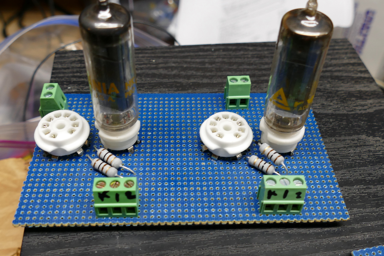

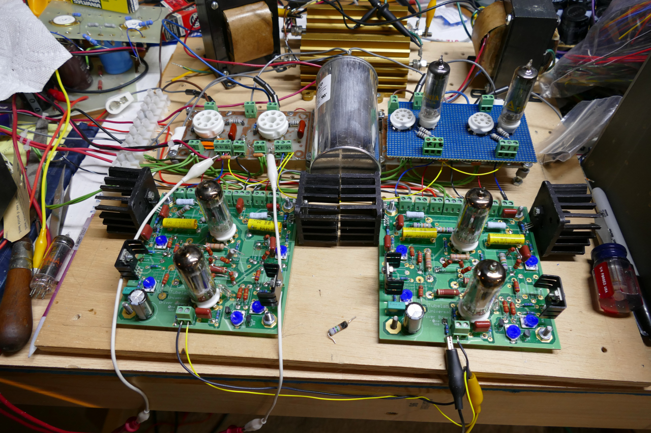

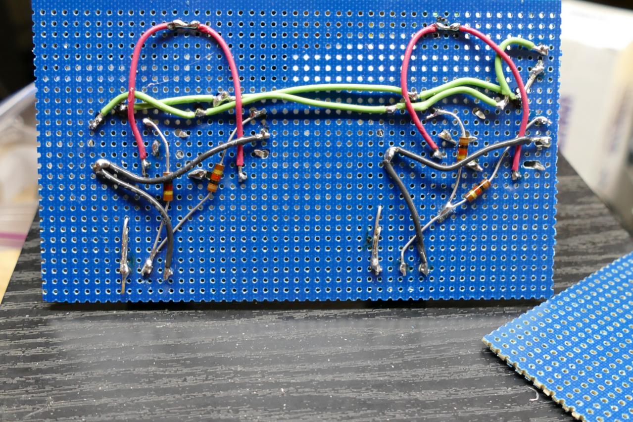

Today I rigged up a crude, but hopefully usable perf board output module for my current HiFi design breadboard. I wired in a pair of 9 pin sockets to test about 5 different types that have been sitting around for almost a year waiting to be tested.......In digging through my tube collection I found 5 50C5's in boxes, but some don't match the box. Only one really looks like a new tube, but 3 are identical looking Sylvanias. So, I also through a pair of 7 pin sockets on the board.
So, who will win, a 650 volt 1.7 amp power supply, or the lowly 50C5......not to worry, I got to use the big boy for heater power so the 50C5's only need to eat the Fluke 407D on the plates...it's just 555 volts at a rated 300 mA. I have seen it crank out 500 mA before it goes into convulsions.
While hitting the books and looking up tubes, I found a wild card. It is a 7 pin miniature with a 12 volt heater and curves that are a dead match for the 6W6. Of course I wouldn't expect a pair of small 7 pin tubes to crank out 35 watts, but how many will they make....I don't have any and will not see Stan (ESRC) until he comes to the Dayton hamfest in May.....theyr'e on his dollar list.
Interest in the little guy will be detertmined by my testing of two 9 pin miniatures that curve match the 6W6.....tomorrow or Wednesday.
