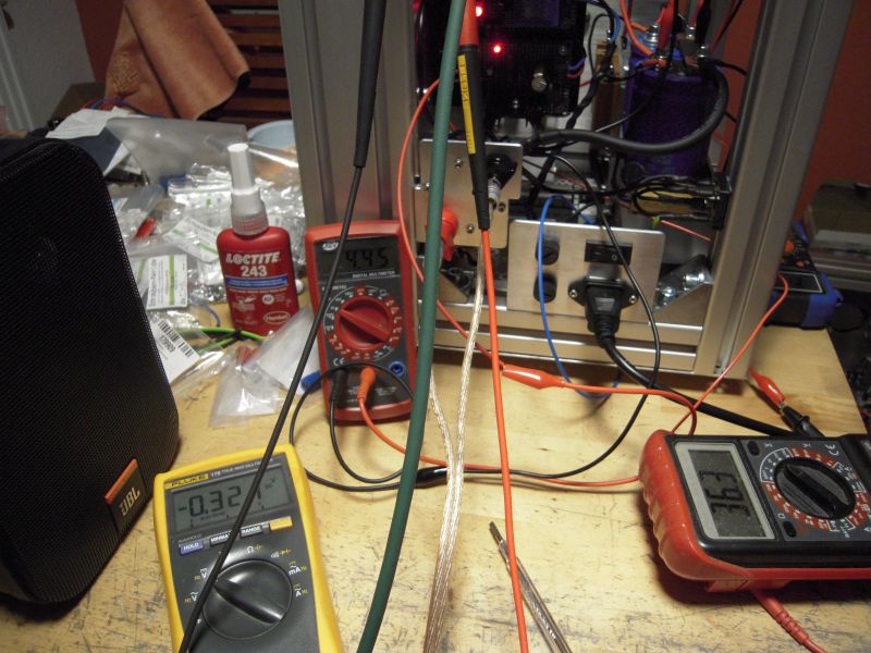

the 50W-SE-Schade-amp is singing! Hip-Hip-Huray!
The first test is promising. My WHAMMY is driving the 50W-SE-Schade-amp
directly.
I have to do some work on the other channel and then I will listen 'stereo'.
BIAS is at 3.2 A. The baby is hot :redhot:
This is a good evening!
Greets
Dirk :drink:

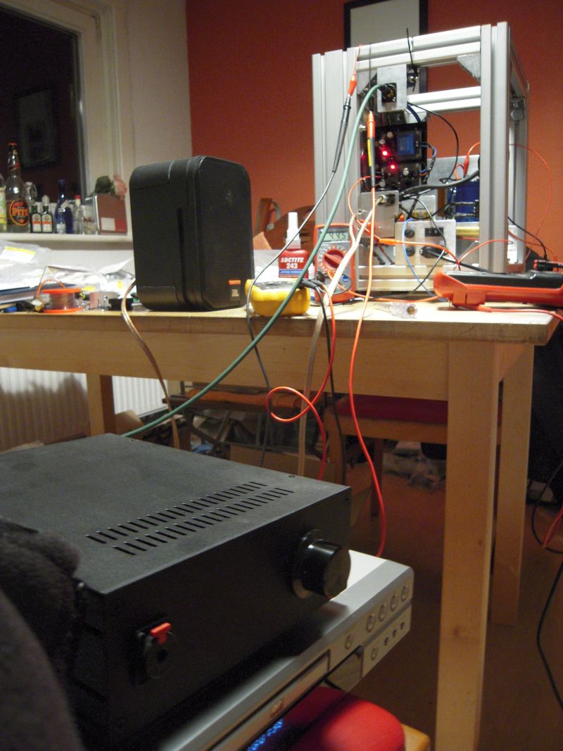

Hello members,
I started my little session this evening with the WHAMMY as preamp in front
of the 50W-SE-Schade-babies.
I've got horrible 50Hz-hum. Hmm? :confused:
Changed the preamp to B1 Korg NUTUBE (single ended). And voila - no noise.
Now I have fun to listen. The amps are running in and get very hot! :redhot:
After 1 hour I mesured around 60° - 65°C on the heatsinks at a bias of 3.19 A.
But it sounds really good. Did not adjust the B1 Korg NUTUBE (it's at 9,7 V).
Speakeroutput normal (not inverted).
Now I need some time to listen to well known records.
See ya later.... :D
Dirk

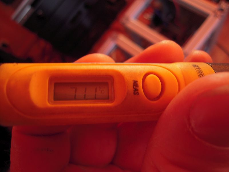

Good morning,
a little 'weather report' from the 50W-SE-Schade-amp:
some temperatures from last night (after circa 2 hours of listening):
the bias climbed from 3,15 A up to 3.29 A. But it is really rock stable.
My rail voltage is 67.4 V. So this would mean a dissipation of 67.4 V x 3.29 A =
221,75 W for one channel.
Temperature at outside of heatsink climbed to 70° C - 75°! But also room temperature was up to 30° C! I think I don't need a heating system anymore?:confused:
