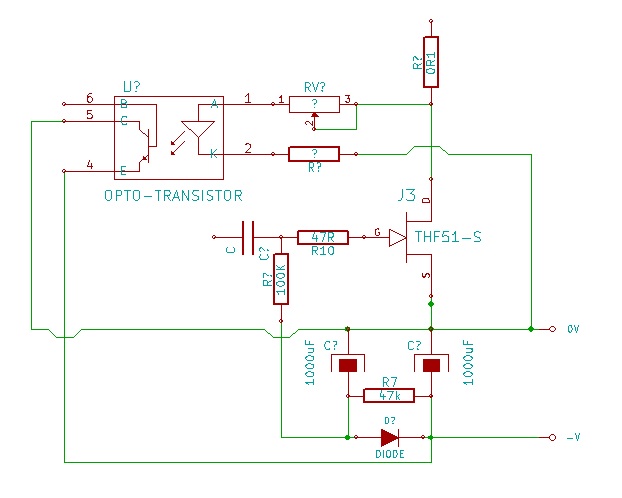

Had another thought earlier (it always hurts when that happens), the bias, what is it actually doing? - adjusting Vd; rather than 'grid bias', why not 'cathode bias' or not quite - monitor Vd with an opto and shunt the bias; iv'e done a scribble, but 'me brain' is too tired to check it for mistakes.

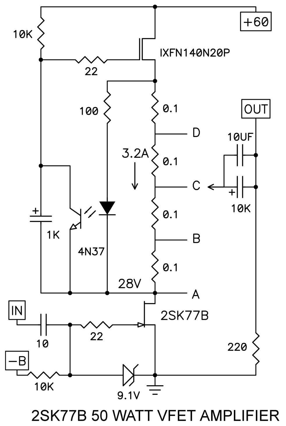

Mornin',
Picture for reference, re bias.
Looking at the the CCS, the LED is monitoring the voltage across the resistor string, if the string voltage increases the opto transistor starves the FET of gate voltage, hence the CC action, the opto cap is used to swamps the modulation.
2 points to me for teaching my grandmother to suck eggs.
I'm suggesting the same technique could used to monitor and set Vd.

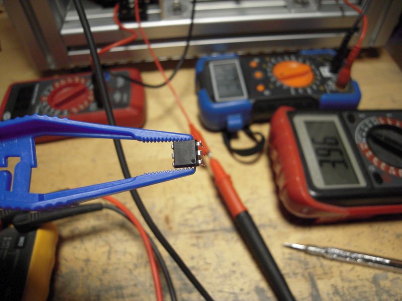

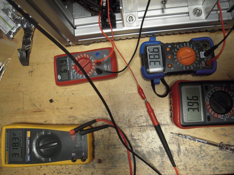

Hello members,
yesterday evening I had an exciting experience. One monoblock made 'interesting' things...:rolleyes:
I tested another preamp (ZEN balanced line stage) together with the 50W-SE-Schade- amp. I had a lot of hum and tried to dial the pots at the pre as well at the poweramp. suddenly the bias was running away - up, up and away.
I immediately switched off.
I pulled the amp off for an inspection. Crazy measurements on my DMMs
(Very high voltages at both MosFets).
Today I pulled off the optocouplerboard. After disconnection of all wires from the upper MosFet I tested it for failures - still o.K.! - Pooh! :eek:
Then I thought, what could be damaged?
My first suspicion - optocoupler (all the rest are a few resistors, caps,...)
and yes, it was that tiny little 'creature'. I had two ones as spare (was it presentiment?). Repaired and running again. ;)
Don't ask me for the reason?
