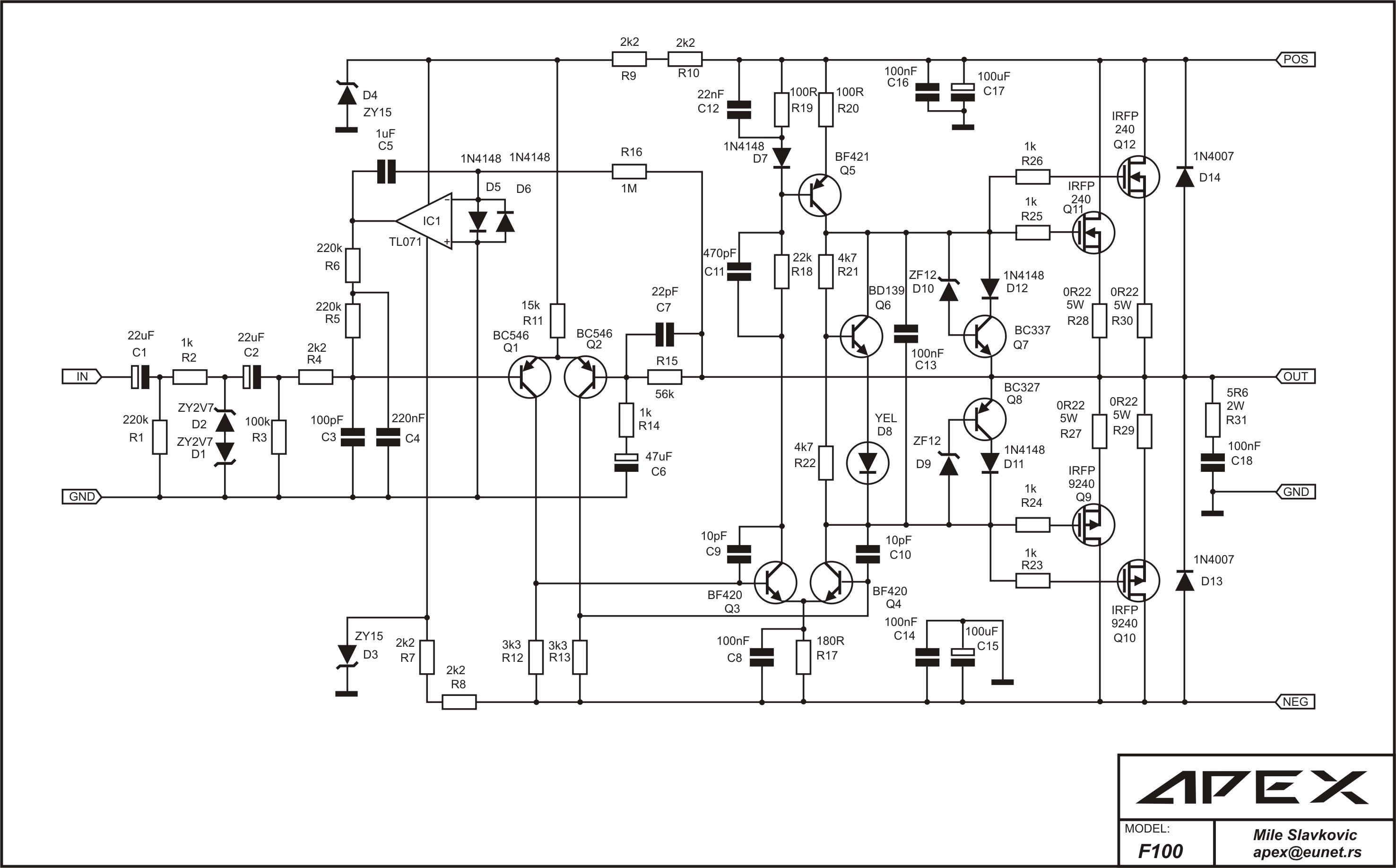

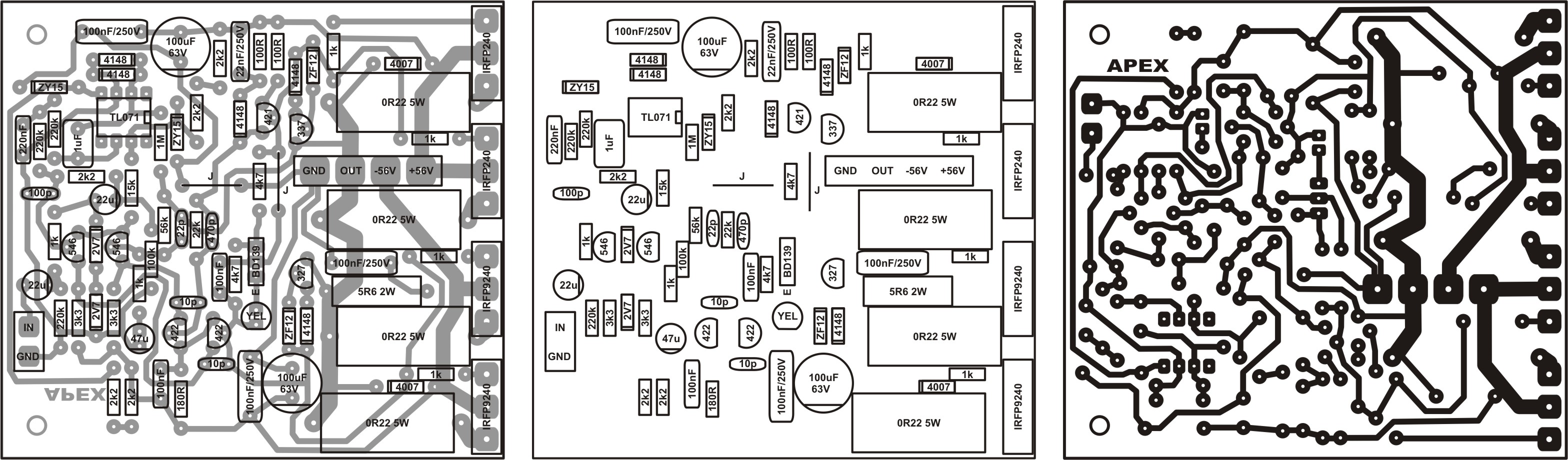

50W mosfet amplifier IRF540/IRF9540
I think only R8 and C2 has to be connected to signal GND.
And the two grounds (signal and power) always must be connected together, with a link or a resistor.
No two grounds must be connected separate to PSU GND, only link with 100nF. With wireing diagram as I suggest there won't be any hum and noise, amplifier will be quite dead without input signal as any commercial brand amplifier.
Regards
F100

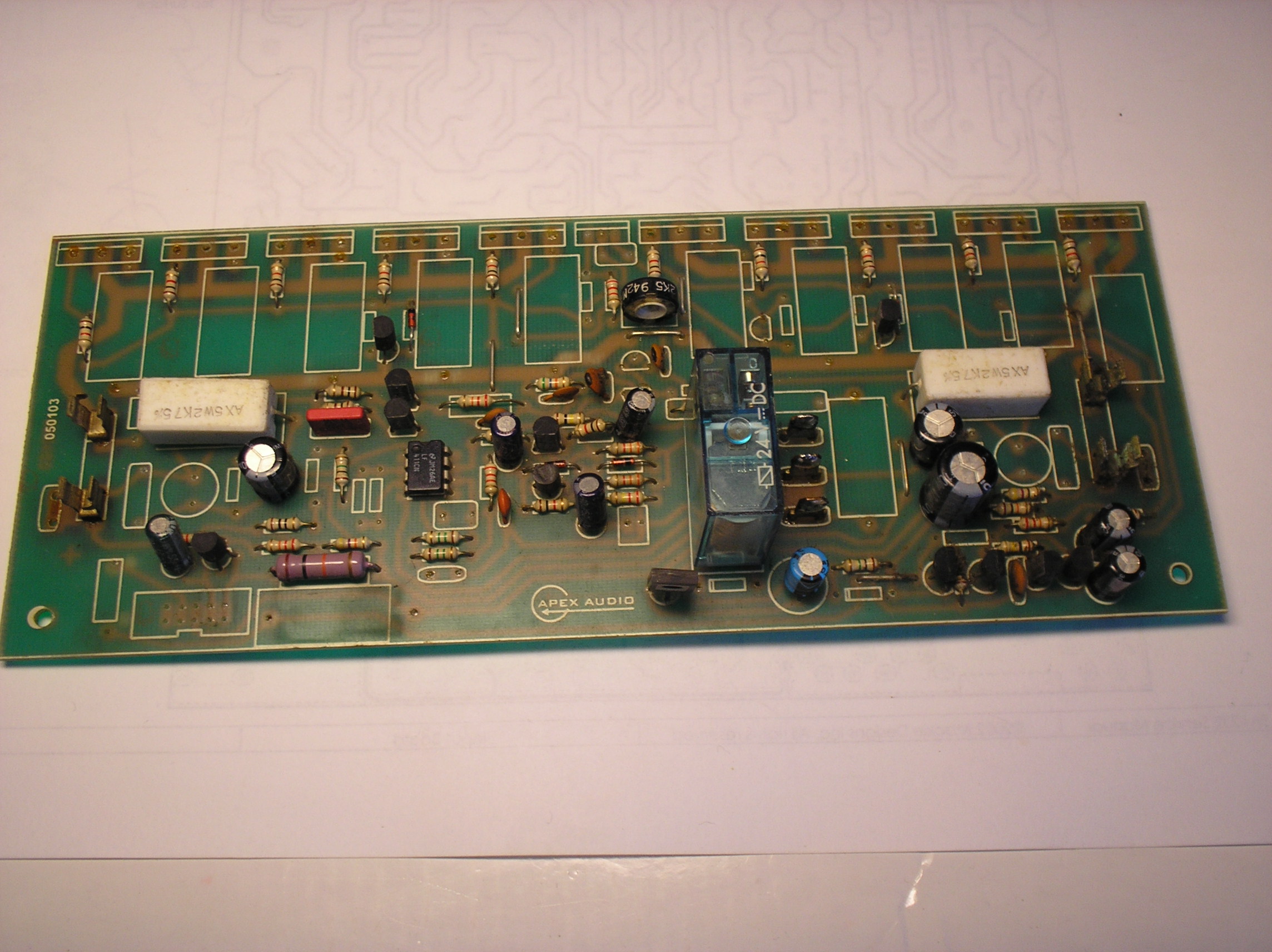

You can't save cost diying pa amp, only you can easy fix it if you diy with avaible parts. I share H1200 soon, three amps work almost one year, without problems.
Regards
