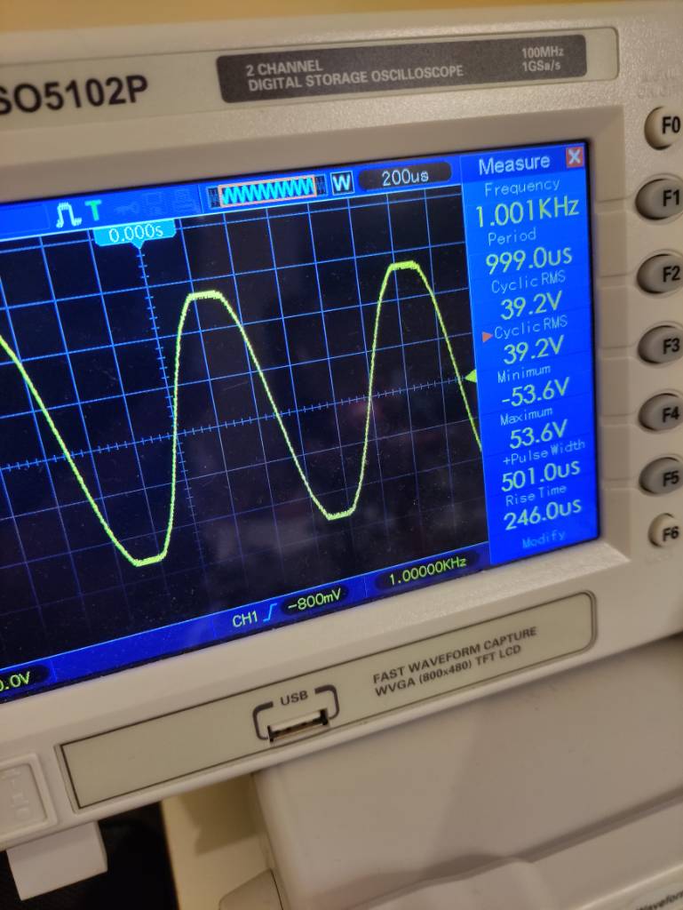

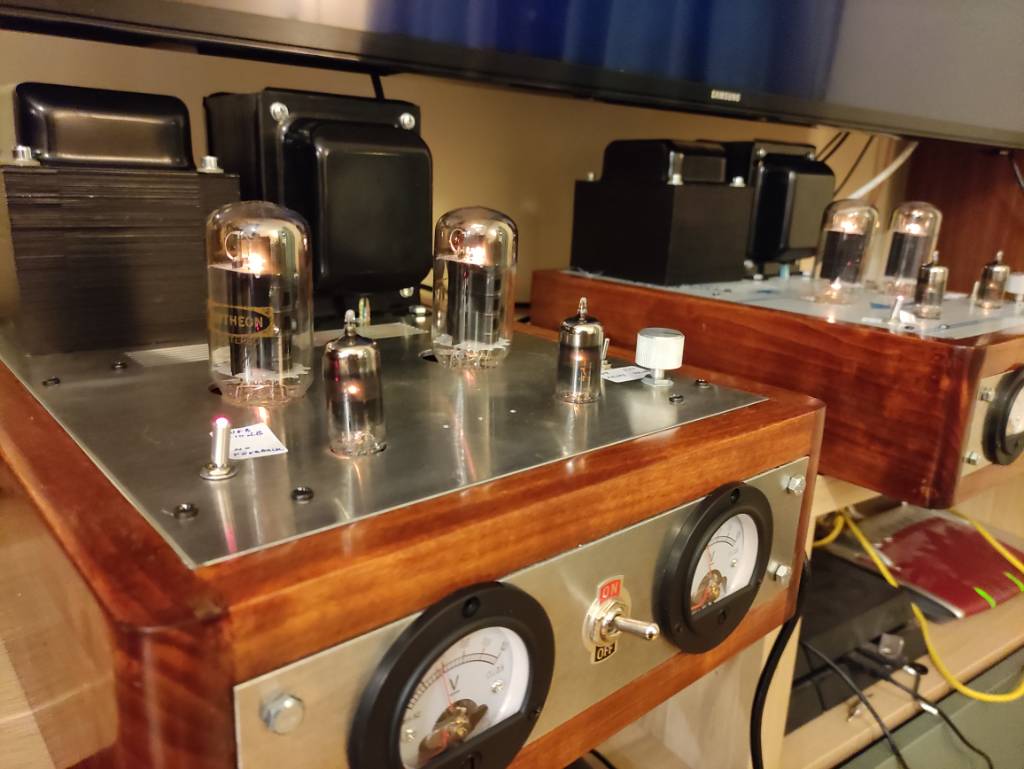

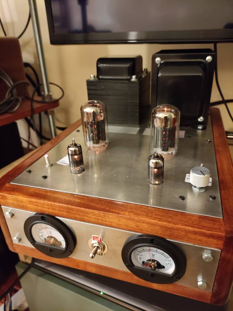

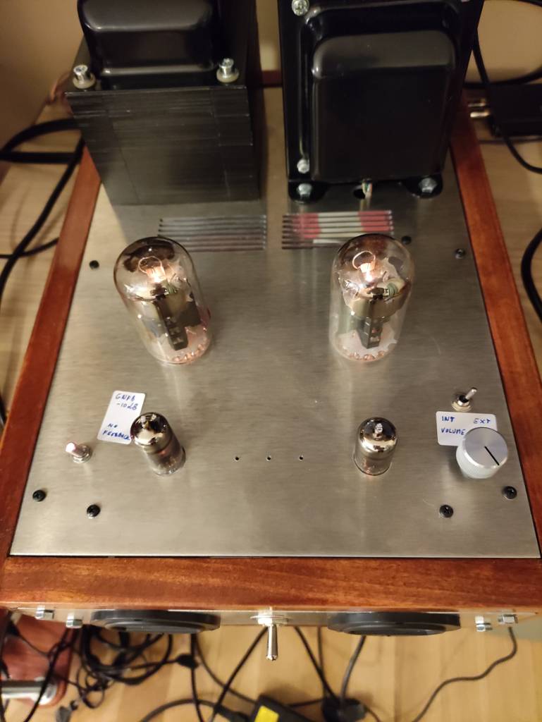

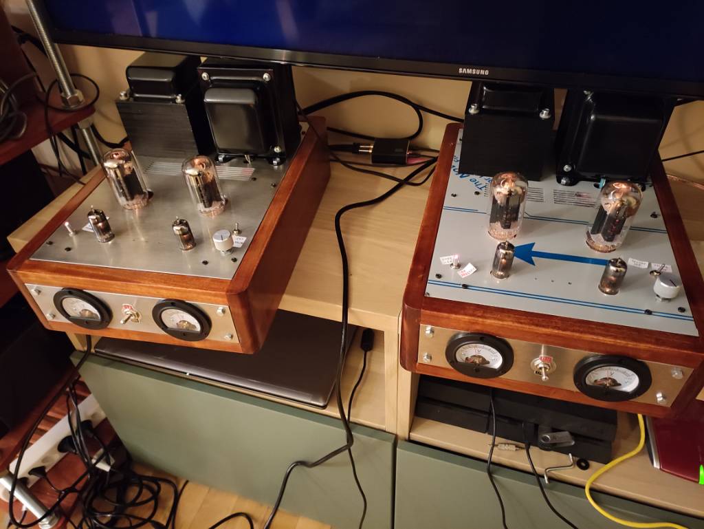

Ok friends, so far so good... For a monoblock at least. (Fig 1.) A little more than 100W on 8 ohm load.
Second monoblock, however, is bad.
Symptom is that with a lov level of input signal, i get very low output, and cathode current rising to the stars...
For the working mb:
INPUT. OUTPUT(Rms) CATH CURR
0.5Vpp. 8V. 0.4V on both
1 Vpp. 15V. 0.64V (64ma) on both
1.5Vpp. 21.2V. 0.9 (90ma) on both.
The one under testing gives:
INPUT. OUTPUT. CATH CURR
0.5Vpp. 2V rms. 0.8V (80ma) on both...
Nevertheless, the power transformer buzzes and rattles...
Measured voltages are stable and spot on and on line with the working mb.
I swapped all the electrolytics on the b+ path, no effect, swapped the ones on the driver plate path, no effect.
I swapped the tubes with the set mounted on the working one, no effect.
Plate voltage on the power tubes is 520v,
Biased at 35 mA (both mb)
Plate voltage on drivers 6gu5, is 220V-ish.
C- circuit stable and working.
Screen grid circuit spot on on 150V.
I have no ideas left... At this point I could try with the working mb output transformer... But don't think it's that...
Any hints please?
Thanks!

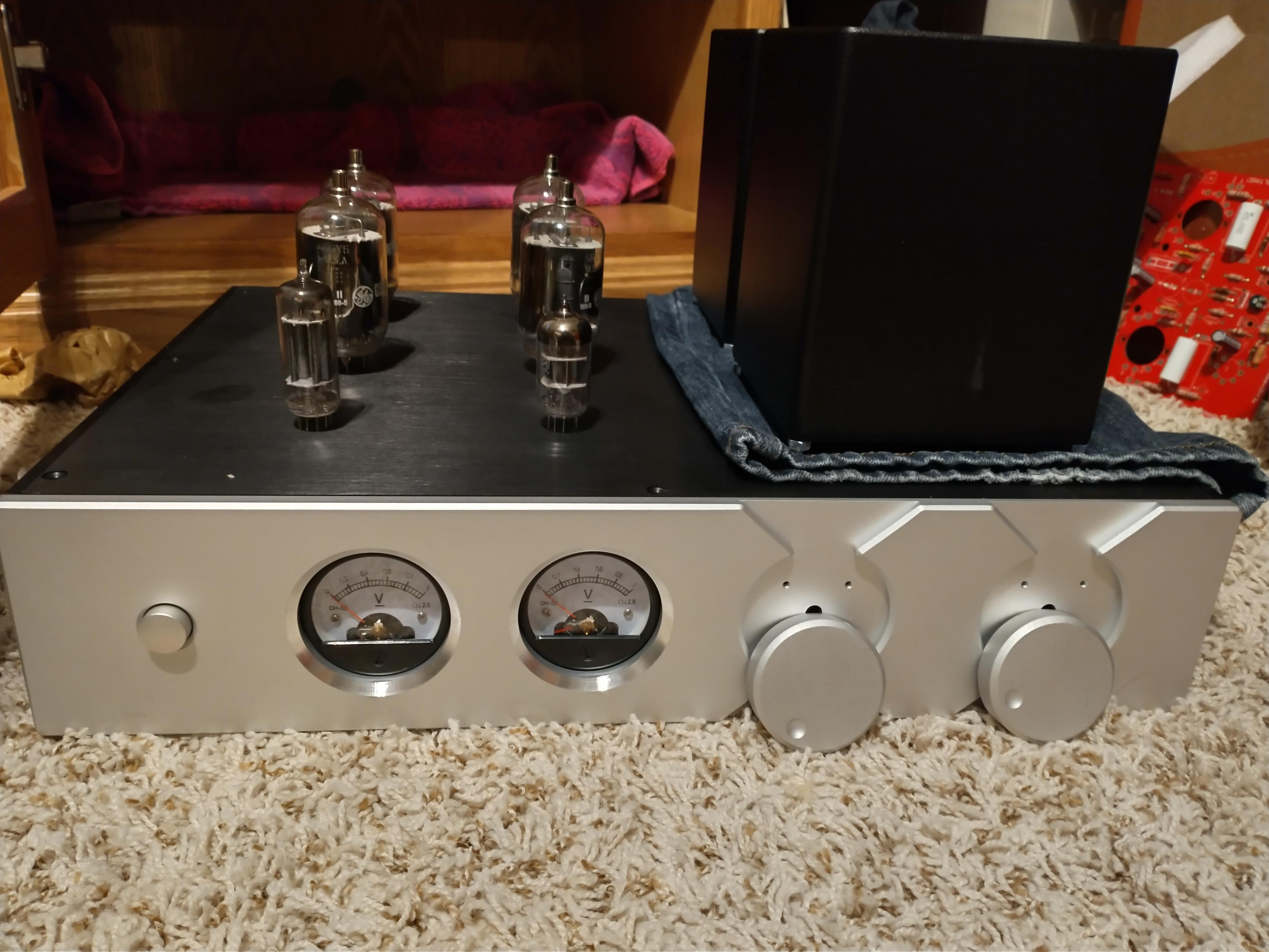

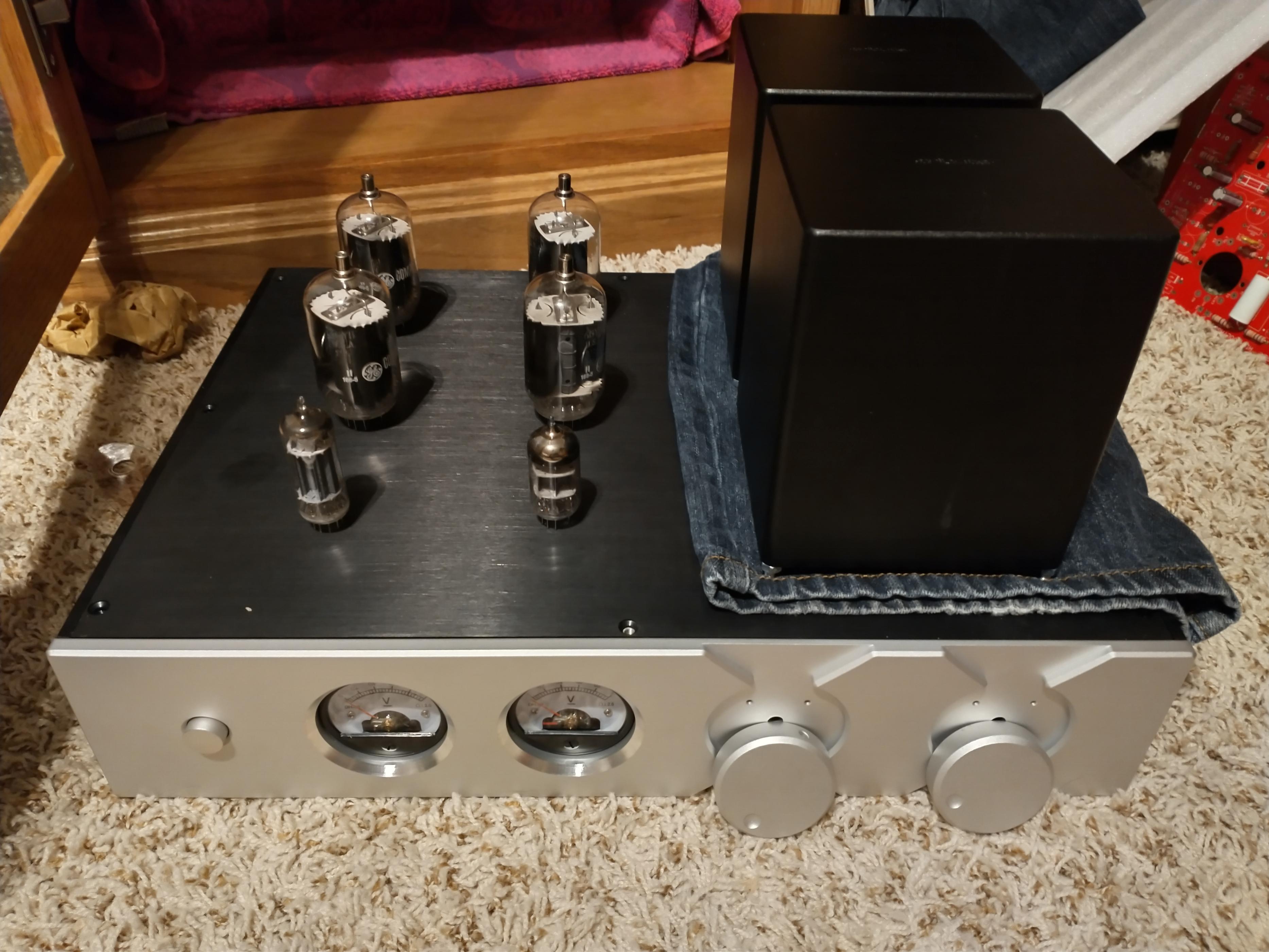

So here's my planned build. I won't be using two potted transformers like in this pic. It will be the Hammond 290FX + filament transformer with the potted Tribute Audio opt in the back.
Do the bias pots hold high voltage? I am planning on running the bias pots to the knobs in the pics. However, since every large bias pot has a metal shaft and the knobs are metal I want to be sure this is safe.
Shown here are 6GY5's. I have a lot of them along with EL509's however the high voltage plate cap scares me especially with a puppy and hopefully kids of my own in the future. 21VJ6's would work however I am also looking at the GU50. I can't find plate resistance or gm values of this Luftwaffe/USSR vacuum tube. How would the GU50 work with 4.3K opt compared to the 6GY5/21JV6 in this design?
