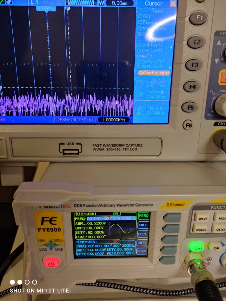

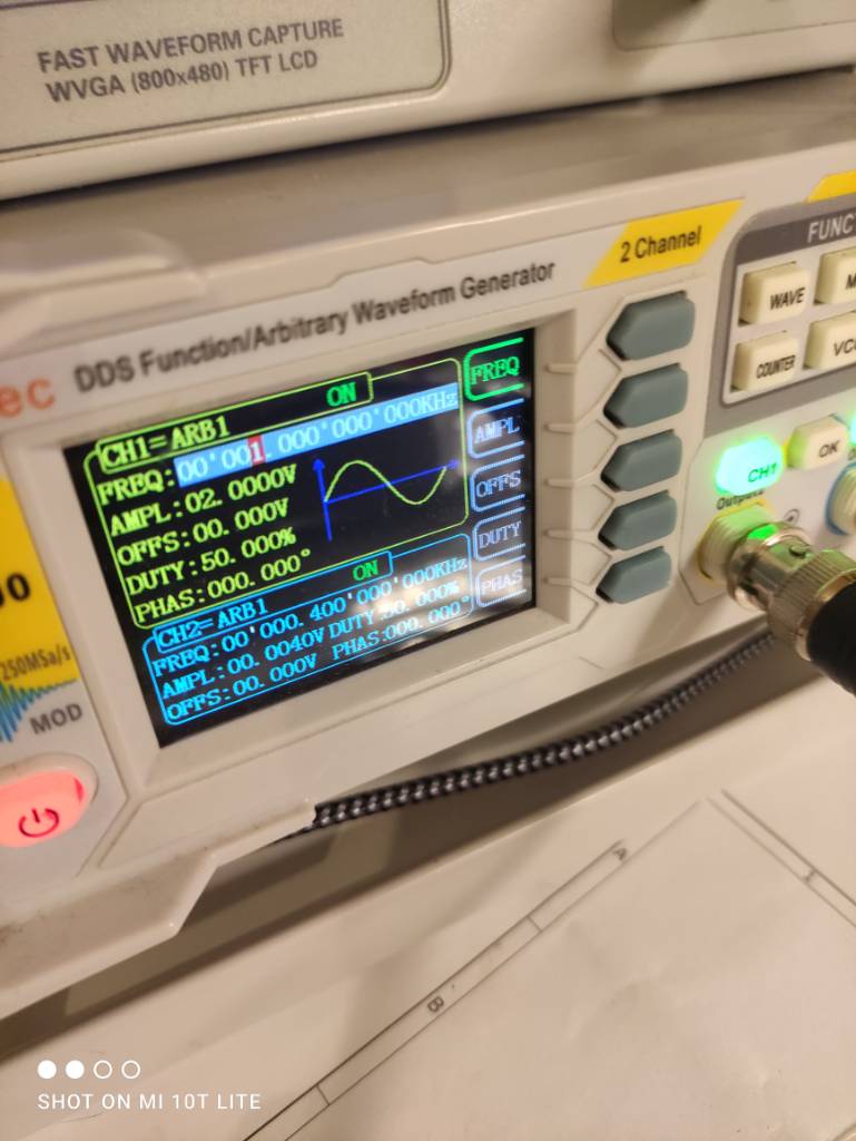

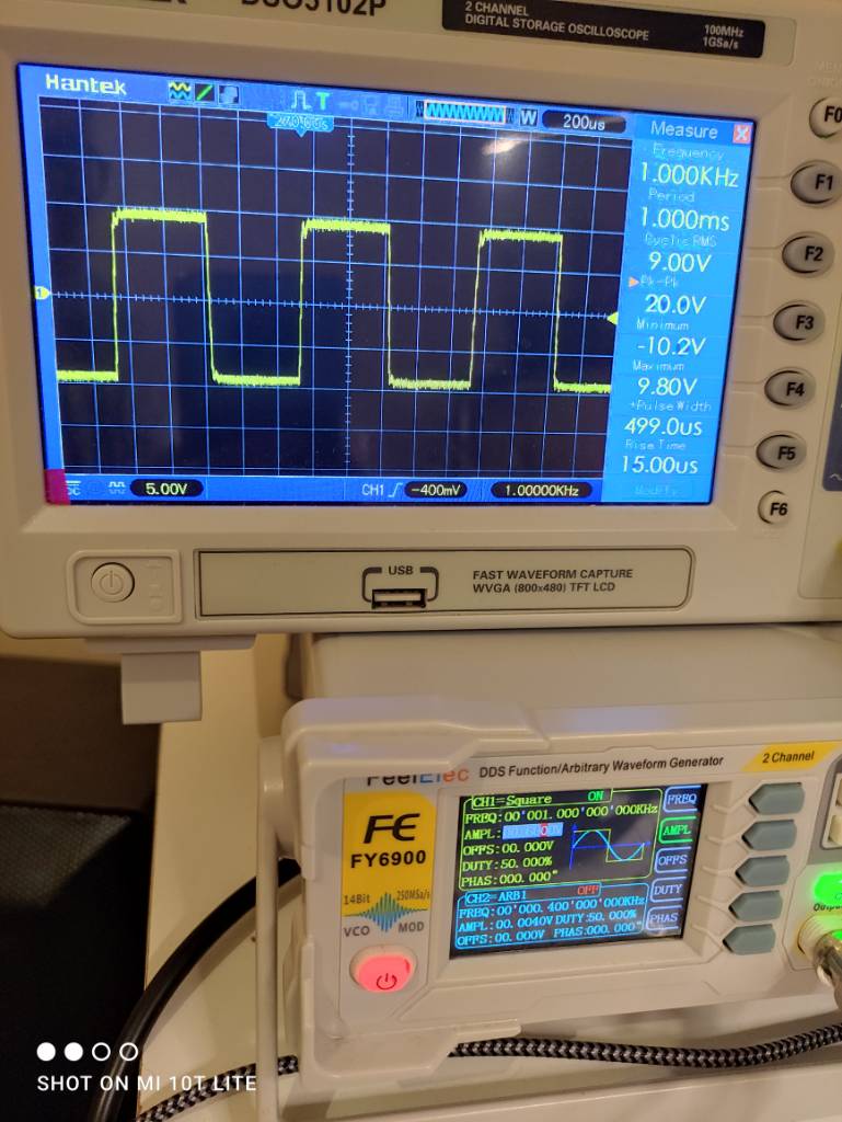

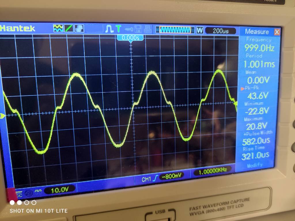

Ok, so, a first working moniblock build is done... 530v on plates, 150on g2s, biased at 35mA... Yet when cranking up the input on signal gen i get some crossover distortion? Couldn't bias any hotter, I'm already a 20-wattish in there...
First 2 pictures, crossover distortion,
3rd pic, fft at 1W, 8ohm, 1khz tone,
4th, square wave 1khz 20Vpp
5th, 10khz 10Vpp....
All on 8ohm dummy output...
What about that crossover distortion? IMG_20210111_191904.jpg IMG_20210111_191914.jpg IMG_20210112_181730.jpg IMG_20210112_182110.jpg IMG_20210112_182228.jpg
That's clearly very excessive crossover dist. Looks like the top of the sinewave is not conducting for as much as the bottom. I would check the grid drives on the tubes to see if they look OK and equal, and check the DCV on the screen grids to see if they are equal and correct V. If alright, then I would suspect some component is wrong somewhere. Could try another tube too.
I'll have a look later, voltages are all correct,and bias is right on both, at about 20W dissipation...
Thank you smoking, what do you mean exactly with "I would check the grid drives on the tubes to see if they look OK and equal" ?
Visually inspect ?
