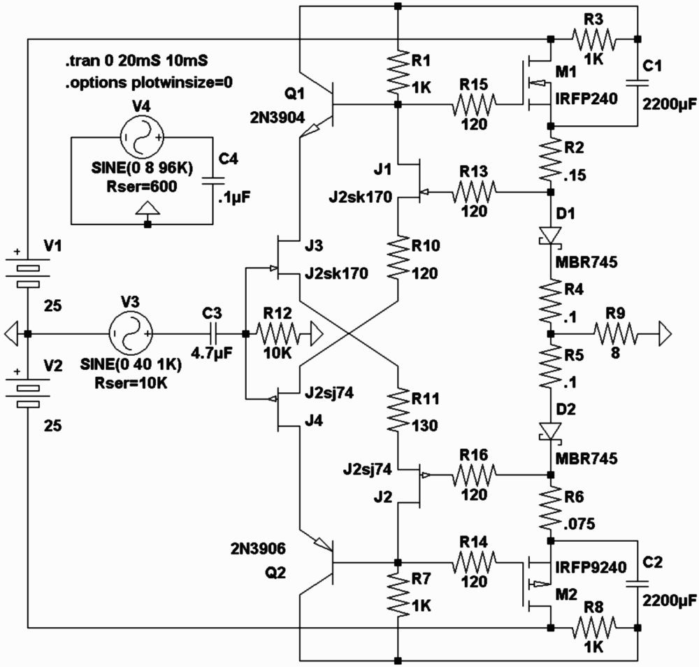

I've discovered a possible problem in most of my designs...
Voltage clipping problem may be handled elegantly, but
slew rate clipping still seems to be very ugly.
You had spotted it before I ever did. When you tried the
96Khz dummy loop as an input source, turned garbage.
Good clue that I might have needed faster slew to avoid
transient intermodulations. It should have handled that
fast a pure sine, and it didn't.
Yeah, its true we don't hear much if anything above 20KHz.
But we rarely listen to just one pure sinewave by itself.
And I'll illustrate a test case where this might be relevant:
If one were to play 1KHz, 3KHz, 5KHz, 7KHz and all the
other odd harmonics below 20Khz that sum to a square
wave as one example. I think the worst case slope is a
lot faster than a simple 20KHz sine all by itself.
And my circuits weren't handling even 20KHz rail to rail
without some strangeness. The slope of the amplified
error at the collector of the backward Allison transistor
needs to be many times faster than the music signal.
When it can't keep up, it goes sorta nutzo instead....
We can kind of get away with it not being fast, as it
dumbs itself down to an autobias circuit. Even when
it can't react quick enough to behave as Allison/Aleph
error correcting base followers, the output transistors
should revert to simple uncorrected emitter followers.
But the mess mine makes trying too hard to be fast,
still somehow not keeping pace, is whats killing me...
I think I need to work on how to make it transition
more cleanly: From fast base follower below 20KHz
to slower emitter follower above. But not getting all
weird on me inbetween...

Everytime I tried bootstrapless mirror drives with any more
current gain, it broke into oscillations... Never quite fixed that.
Actually every time I try bootstrapped Alephs with Sziklai or
Darlington followers to enhance the slew of the gate drives,
it goes just as weird for me.
I can't seem to gain faster local slew after the comparators,
at least not with any stabilty. I need to drive more current
swing directly into the comparator emitters, no way round it...
But I've also been playing with JFETs for the comparators
and diamond buffer. I'll show you here in a minute. They got
some of the same issues, but less tail current if you should
accidently drive one into cutoff (as happens in clipping).
They also sim far more stable, but that may just be LTSpice...
But the main diff, I'm pushing up the quiescent current of my
comparators from 4mA to 8mA...
That's neat!
I tried using Jfets in just the normal Allison style but it didn't work and oscillated. I need to experiment with FETs more.
Note: Those diodes actually decrease the gain of the Allison feedback loop, which should increase stability at the expense of distortion.

For JFETs as comparators, you need to make sure the threshold
of turn off is less than VGS-ON for the MOSFET to be controlled.
The ones I specified are fairly low threshold, and available in
matched pairs (by a different number 2sk389/2sj109). This
makes the sums across the diamond equal in both branches.
But if the MOSFET thresholds aren't as well matched, you still
need jigger with the little resistors in the middle that set the
offsets. There is nothing "automatic" like a bipolar threshold.
The JFET models are Toshiba I think.
.model J2sj74 PJF(Beta=92.12m Rs=7.748 Rd=7.748 Betatce=-.5 Lambda=4.464m
+ Vto=-.5428 Vtotc=-2.5m Cgd=85.67p M=.3246 Pb=.3905 Fc=.5
+ Cgs=78.27p Isr=129.8p Nr=2 Is=12.98p N=1 Xti=3 Alpha=10u Vk=100
+ Kf=26.64E-18 Af=1)
.model J2sk170 NJF(Beta=59.86m Rs=4.151 Rd=4.151 Betatce=-.5 Lambda=1.923m
+ Vto=-.5024 Vtotc=-2.5m Cgd=20p M=.3805 Pb=.4746 Fc=.5
+ Cgs=25.48p Isr=84.77p Nr=2 Is=8.477p N=1 Xti=3 Alpha=10u Vk=100
+ Kf=111.3E-18 Af=1)
Those diodes are not there for stabilty, they are for class AB.
You can't have smooth AB if the voltages at top and bottom
of the pincers have a constant offset, and ours certainly do.
This only allows class A till one or the other clips, and then
the transition will be a hard one.
You can look at my Schottky as current variable voltage drops,
and thus pincers that "give".
I was just writing my thoughts on the diodes, nothing more. I probably should have clarified.
The affect of making it Class AB is nice. However I don't know if it is possible to reduce distortion apart from component selection, however. The Allison works well assuming we use perfect resistors. If the the resistors aren't perfect, then their VI curves must cancel. The VI curves of the diodes don't cancel perfectly, and should leave dominant 3rd harmonics.
We could probably reduce distortion if we bypassed the diodes with caps. Perhaps we could leave in some "desirable" 3rd harmonics in the bass region
Please don't mind my usage of "we". I'm not implying anything. I just write that way...

Hmm. That's an interesting idea. Bias the outputs at class B or AB, and have the drivers be the only class A part. I wonder if this can work? Unfortunately, it would take some tweaking of BE resistors.
I hope this clears things up,
- keantoken
BTW, I hooked up the LTP and VAS to the Allison. I got some sound, but bad oscillations ensued. I will redo the layout tomorrow if possible, with some changes, and try again. Too bad I only have ceramics to use for Cdom. :cannotbe:
if one or the other of the output transistors stop controlling the output current then the stage is not ClassA.
A bit like a single ended ClassA stage transistor always controls the output current, then similarly the push pull stage requires both transistors to always control the current turning one either off on to a low near constant current while the other is left doing all the work is ClassAB.
Don't worry, it's fully class A.
When I get his working on breadboard, I will try to work out a PCB layout. From there is history, depending on what the measurements are, impressions, etc.
- keantoken
