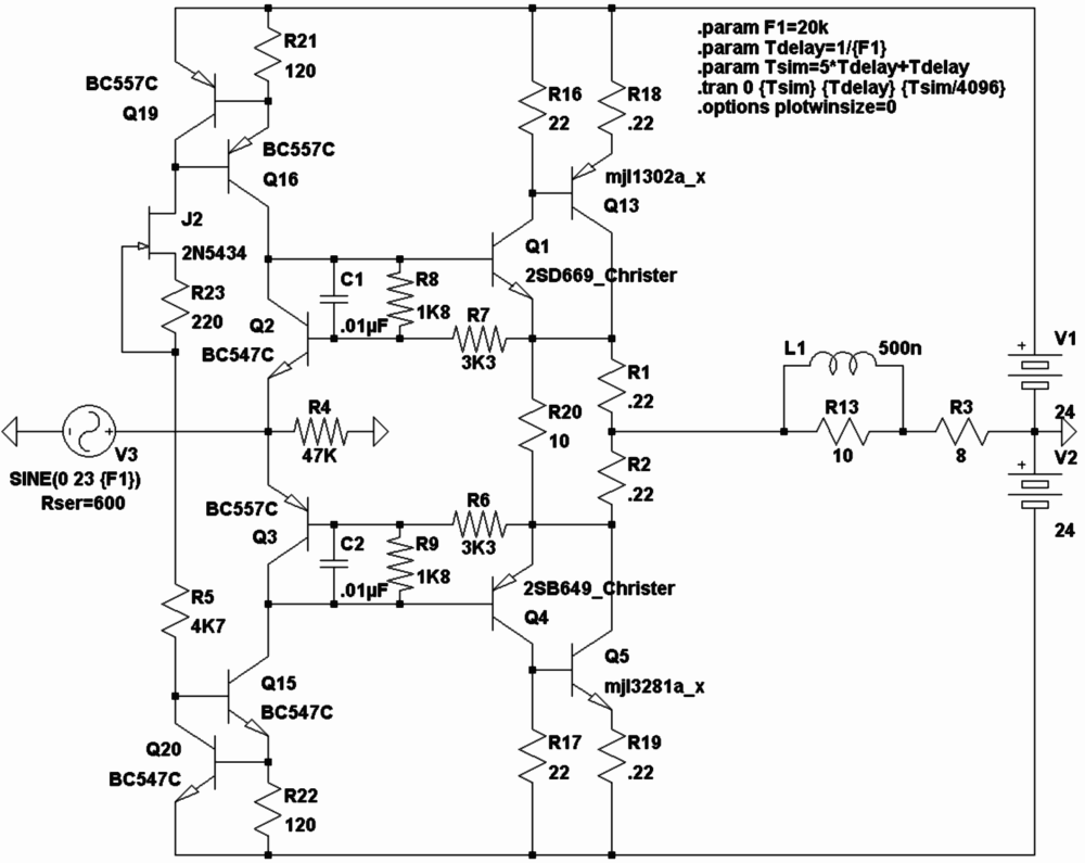

At first it might look differential, but really just a complimentary
pair of error correcting amps. Same basic game plan as Allison.
Just another goofy way to do it.... Creating as many mysteries
as it seems to solve...
The quasi complimentary pairs don't balance with equal resistors,
and I'm not sure why that is? Also the push and pull phases don't
want to stay together at 96KHz unless I cripple the N-JFETs with
extra Miller... I'm assuming that dumbs em down to better match
the speed of the P's?
It behaves well under duress (absurd voltage / slew) on the sim.
But 1W distortion is nothing special... At least loop bandwidth is
up where TIM shouldn't be an issue...
Pretty close to both rails, considering no bootstrappage abused.
Unfortunately without strappage, voltage clipping isn't softened...
I'm not sure I've improved on anything over previous attempts.
Just so you know I haven't dropped off the face of the planet.
I still follow this thread, and want to know about your progress.
Still need your custom .models to follow along with your design.
Can you zip those up with an .ASC every once in a while?

Following my own advice....
Here are the .ASC and .models for my above drawing.
Anyone know where I can find MJE340/350 as BJT .models?
I do already have them as .subckts.... Wanna try them as
drivers for these final outputs... I just seem to lack .models
for anything complimentary throughole in medium Wattage.
Small and big BJT models I got. Medium, still an information
vacuum..

That is very unique. I was looking for a way to implement the Allison with common-collector outputs. Although this is probably far from what Allison himself envisioned. I have a feeling you would get much better overall performance if you could replace the FETs with BJTs.
I haven't dropped off the face of the planet either, but I haven't had any news since I discovered I didn't have any suitable transistors for the supply voltages I'm using. So until I get an order of BCxxx transistors, I won't have anything more to report.
Since you ask, I'll zip up all of the Allison derivations I've posted and attach it. The Allison+LTP schematic I included is more advanced I think than I have shown here, and the extra components can be done without I think, but I don't have the time to dumb it down again.

My Allison of Post 97??? I didn't post 97, nor does it seem to
have any schematic attached, so I'm not sure which drawing
we are talking about? I will use your latest drawing for the
purpose of reference designators in my response.
Some degeneration of the error correction does seem necessary.
Especially when we deal with inputs and/or outputs that exceed
saturation and/or cutoff voltage boundaries... Those drive signals
will leap away at maximum slew, when there is no other feedback
but an output that can no further move to prevent it.
I would have put resistors parallel with D1 & D2. That the
collectors have some linearizing negative feedback to bases...
This also creates small voltage drops across R17 & R18, which
can be simultaneously abused for bias tweaking purposes.
Your D5, D6, and the associated CCS might not be needed.
D1 and D2 might be chosen to have a breakdown voltage just
above that needed to fully saturate the next stage... That too
could help prevent drive signal overshoot.
I'm not sure what your C5 + R25 are supposed to be doing?
I'll try that, and see what happens... Whats with the glitch we
see in I(R11)? Was that a drive signal overshoot, or the tail of
a bipolar coming out of saturation?

Here's what I was talking about earlier...
Local feedback to keep the error correction from goin too wild.
And as a bonus feature, shims up some of your voltage gap...
Notice both Iq resistors reduced to .22, damping factor now has
improved! Or is damping not that simple in context of a complete
amplifier circuit? How small can R1 R2 safely be, without shooting
smoke out of the BJTs?
I was gonna add Zeniers, but then realized you don't need em.
You don't have bootstraps, drive isn't going past the rail anyhow.
I'm surprised how close to the rail that type CCS seems to work.
Without C1 C2, it sometimes oscillates? Could just be the sim...
The exact value of cap needed here doesn't seem critical...
If cap is chosen too big, merely stops trying so hard to correct
uncorrectible errors, dumbs it down to a glorified diamond buffer
at the highest frequencies.

I will try this. How about instead of using high-gain transistors there in the first place, you replace the Allison transistors with low-gain switching transistors such as the 2N5771/5769 (I posted this in my Allison thread here: http://www.diyaudio.com/forums/showthread.php?postid=1871329#post1871329 )? My simulations show better stability and no significant rise in distortion (in fact, distortion actually lowers by an insignificant amount). Models:
.model Q2N5769 NPN(Is=44.14f Xti=3 Eg=1.11 Vaf=100 Bf=78.32 Ne=1.389 Ise=91.95f Ikf=.3498 Xtb=1.5 Br=12.69m Nc=2 Isc=0 Ikr=0 Rc=.6 Cjc=2.83p Mjc=86.19m Vjc=.75 Fc=.5 Cje=4.5p Mje=.2418 Vje=.75 Tr=1.073u Tf=227.6p Itf=.3 Vtf=4 Xtf=4 Rb=10)
.model Q2N5771 PNP(Is=545.6E-18 Xti=3 Eg=1.11 Vaf=100 Bf=76.77 Ne=1.5 Ise=0 Ikf=50m Xtb=1.5 Br=1.365 Nc=2 Isc=0 Ikr=0 Rc=3.75 Cjc=2.77p Mjc=.1416 Vjc=.75 Fc=.5 Cje=2.65p Mje=.3083 Vje=.75 Tr=4.033n Tf=118.5p Itf=.5 Vtf=3 Xtf=6 Rb=10)
Now you have higher bandwidth, better stability. But since I haven't tried your idea I don't know which is better. It is possible that your method would not work well with low-gain transistors because the base current would cause significant error (but maybe you're not worried about distortion that much).
Damping factor should not change much depending on R1 and R2 (it is already incredibly low, and any change will be because of the transistors' Hfe/base current). Does the benefit of lower bias resistors make up for the consequences of lower Allison gain? I suspect not but I haven't tested it.
The CCSs I used here cut off at around 1.3V. This is perfectly fine because I wouldn't drive the output devices this far myself.
See if my suggestion for the switching transistors fixes your problems. Also, with LTSpice, sometimes your circuits will go into oscillation if the timestep is too high (I was havinng a hard time with my linear regs until I realized this - LTSpice can be misleading about oscillation). Try to make the timestep about 1000 times less than your simulation time.
C1 and C2 don't seem to have a terrible affect on distortion except when used inside a resistive feedback network, like you have. Since I'm so picky, I like to do without them, and the Allison on my breadboard works without any compensation. The next step would be to see if this works on PCB (which it probably can if it works on breadboard).
- keantoken
