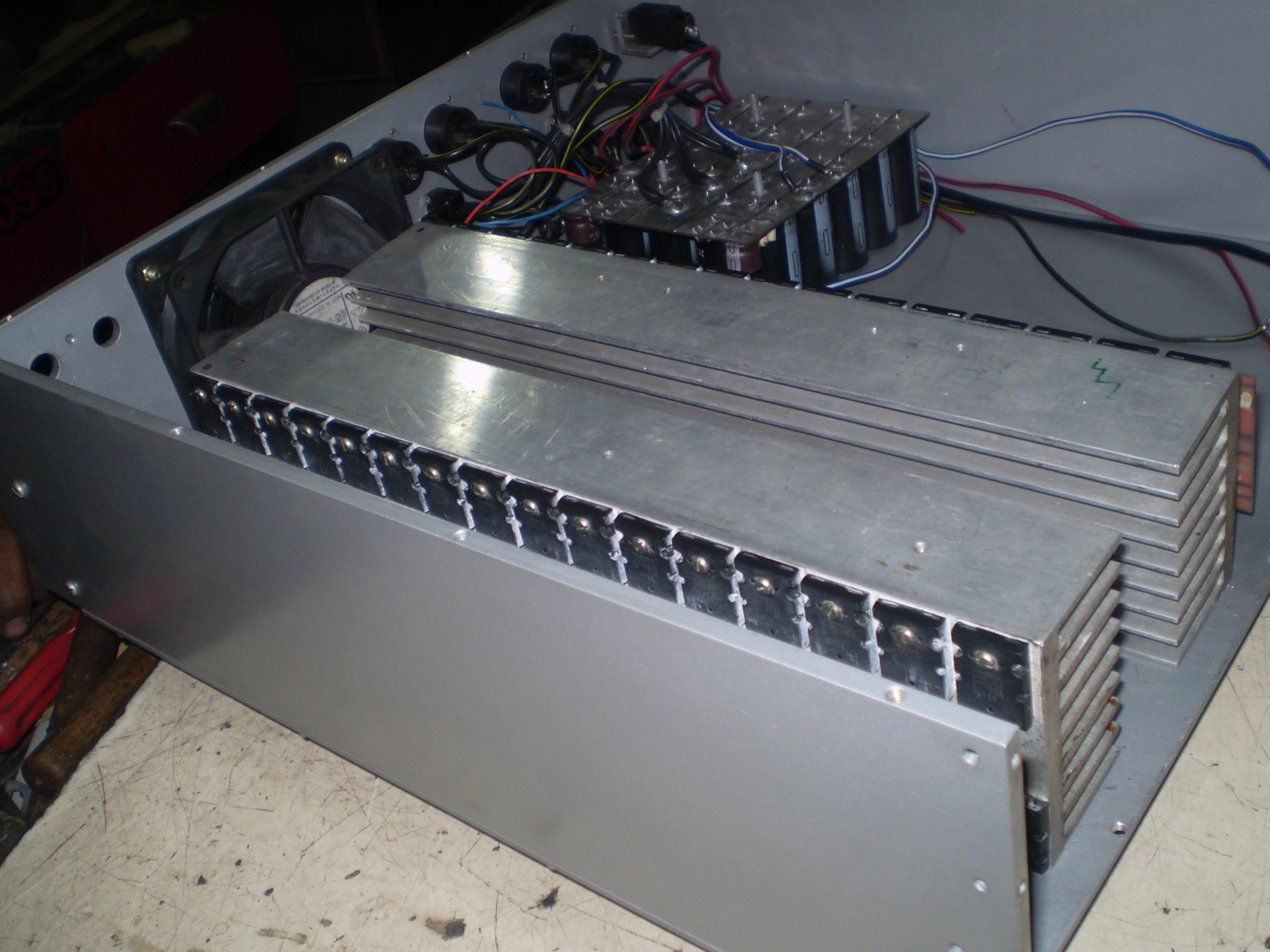

btw now I want to prepare the heat sink
just thinking how to make it good looking
any suggestion?

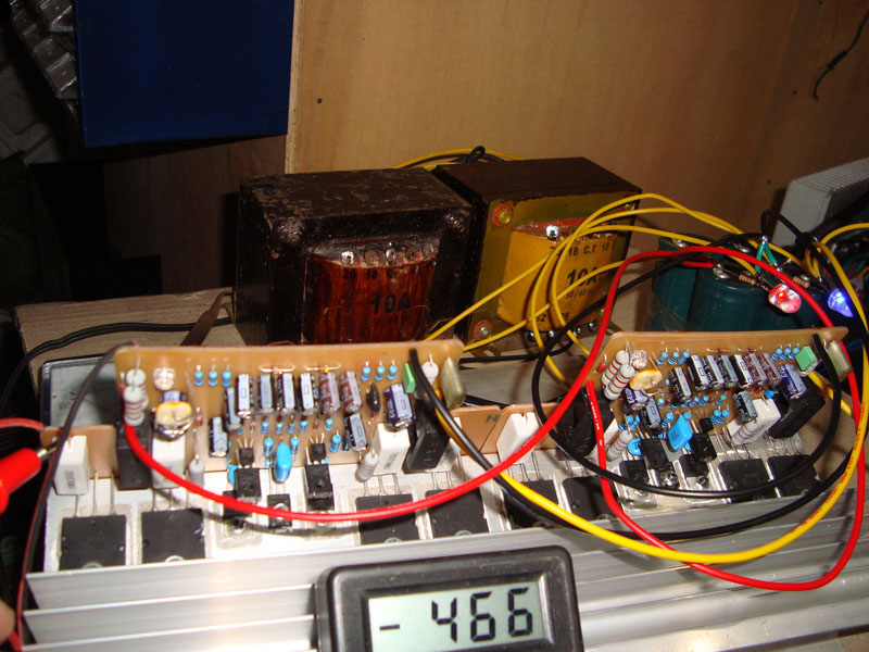

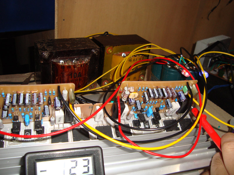

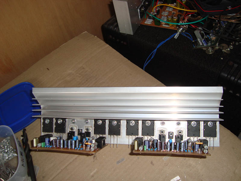

I made it, my B500
already on the heatsink & hope not too small
But:
1. Why offset just to high
as recommended 20mV or less, my B500 is
-466mV & -123mV
& the voltage
on 100ohm resistor is little below 0,5V
on base emitter KSE340(bias) is little below 2V
2. use 2 x transformer 50Vac but
DC after rectifier is 61VDC, should be 65-66VDC
(Vac is drop to 46Vac because test is at night)
Maybe bad caps or something?
Anyone please help, where do I start to check it out?

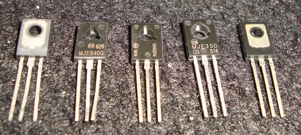

about the offset KSE350 is the problem, but still not below 20mV
maybe must use good MJE340/350 because lot of them are fake here
MJE340 are fake but MJE350 look genuine

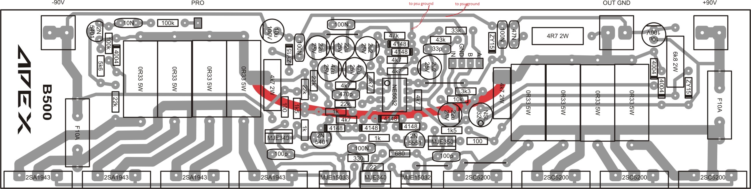

This is my new pcb design, change of 43k with 10k + 33k
another one is on page http://www.diyaudio.com/forums/solid-state/164208-500w-pa-amplifier-limiter-176.html
enjoy

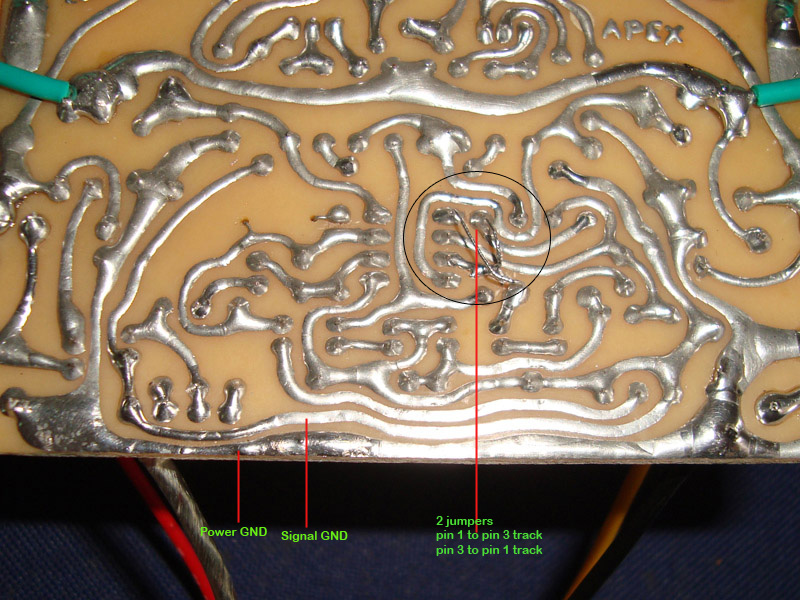

I'm sorry there was a mistake to my design...
pin of IC is split
pin 1 & pin 3 :eek:
now there is two jumper on the back side of my PCB
that was make the amp not working...
I feel so sorry if there was anybody made it too
Now this couple amp I made has 8mV & 9mV offset
I will post picture soon

try to separate S ground and main ground
on your PCB main and s ground is joined it should be separated
mark red should be on separate wire going to ground of psu
