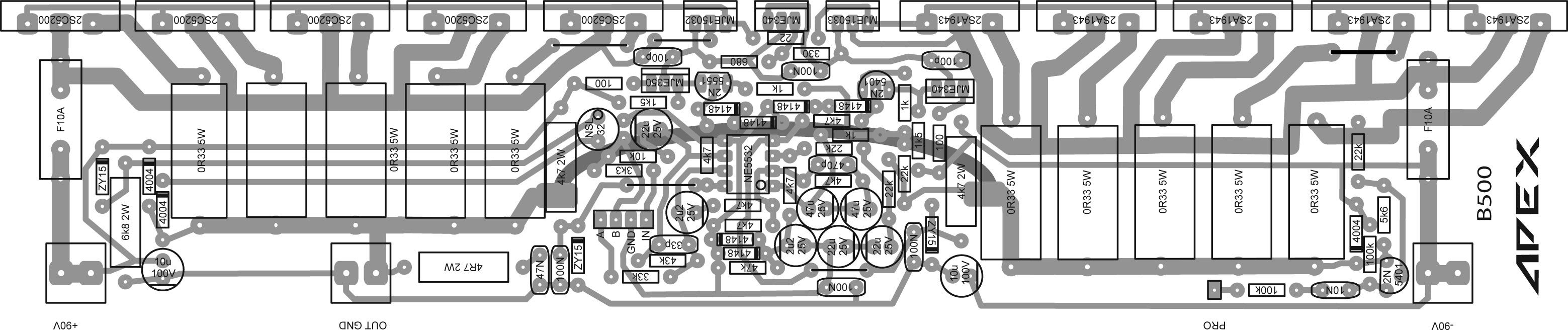

hi guys,
here is the b500 5 pair board.
any mistakes pls inform.

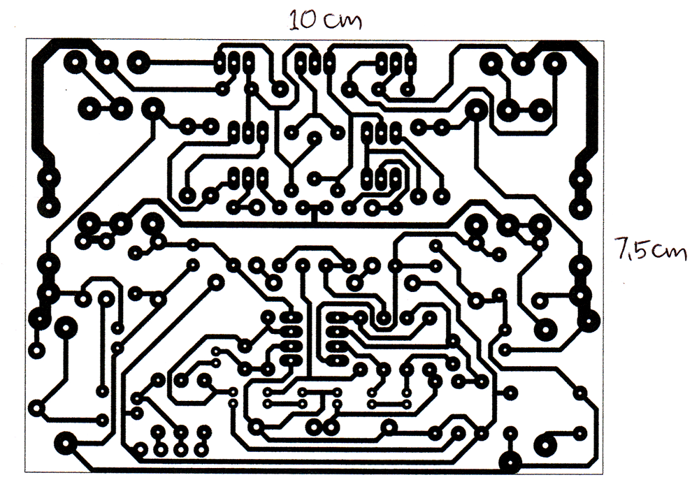

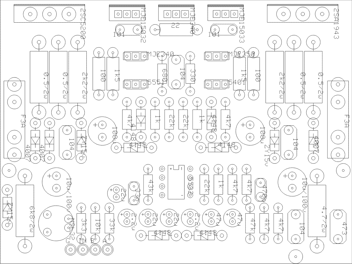

SINGLE PAIR PCB
hi Sir Apex,
hi everyone,
i'm also interesting to make this amplifier
here my pcb design
please help me to check
i'm using ExpressPCB
for beginer like Sir Apex said
thanks

I have some problems with my B500, there is high voltage on pin B driver TR. So, i dont dare connecting to final TR.
I try to measure B to B driver TR, there isn't voltage on it.
I try to measure at pin 1 NE5532, when power turn ON the voltage is increase from 0V to 13Vdc slowly. is it true....????
I have a little question, when normal conditions without input signal,
1. how the voltage at pin 1 NE5532?
2. how the voltage at R15 (1k)?
3. how the voltage at R16 (1k)?
Sorry with my bad english...
Thanks before...
