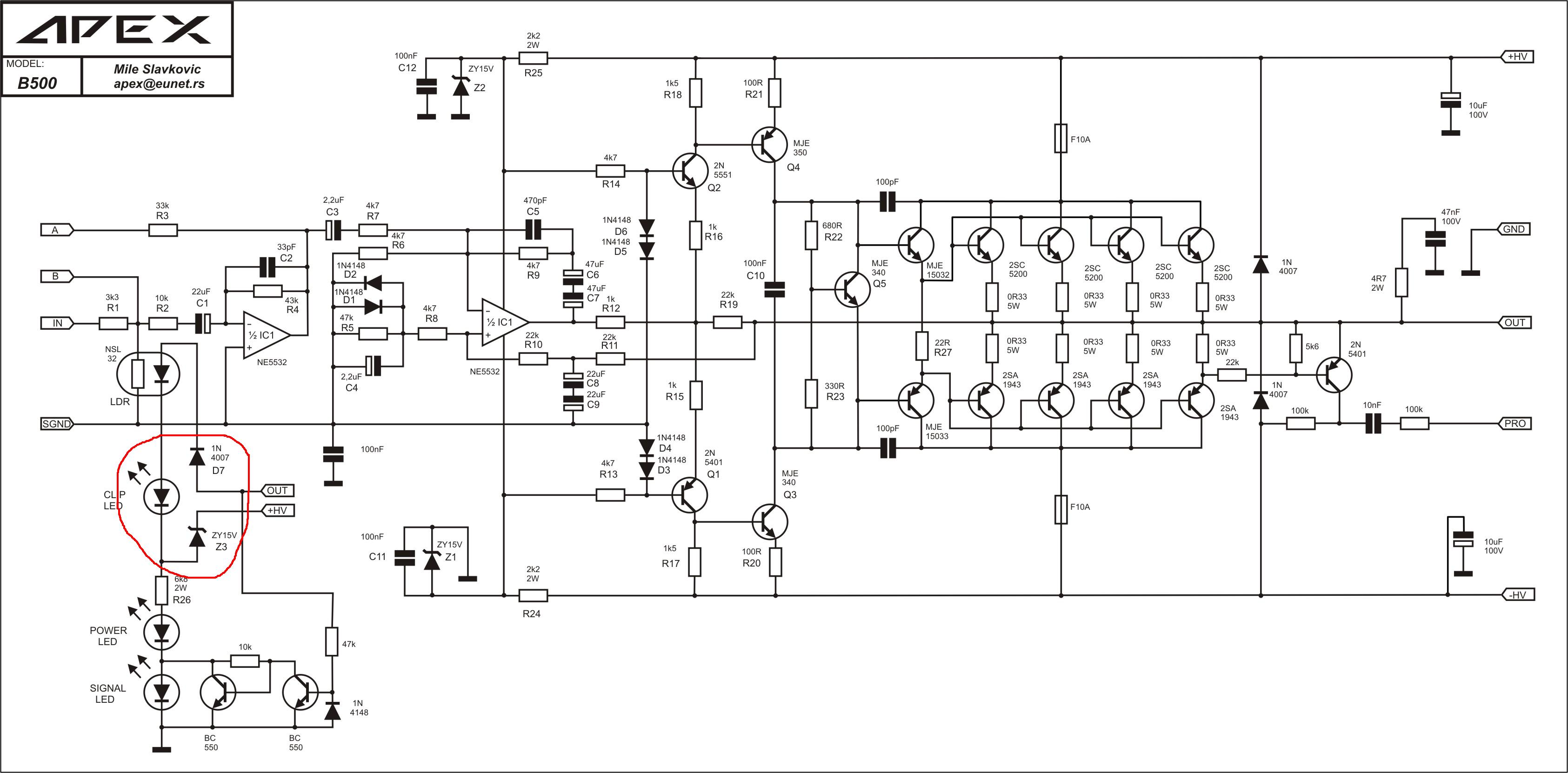

Can you share to me and all of diyers schematic triple darlington
sorry mr .mile i mean is the lay out.......on pcb.....
Ask mile :This circuit can be use to switch any stereo amplifier to bridge mono mode.
BX500 have balanced input, but without bridge option, use this circuit if you want use BX500 in bridge mono.
if me will implementation with apex b500 stereo bridge to mono,share wiring more detail....
thanks

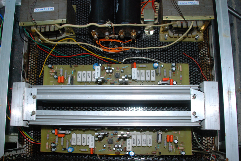

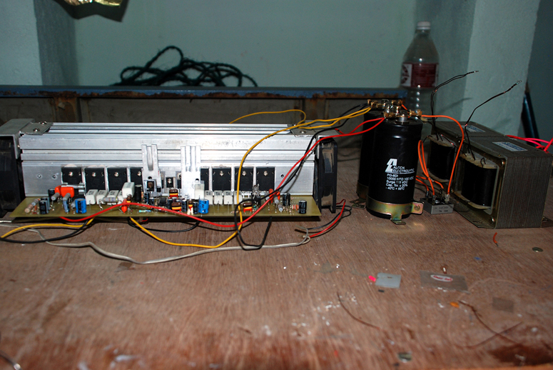

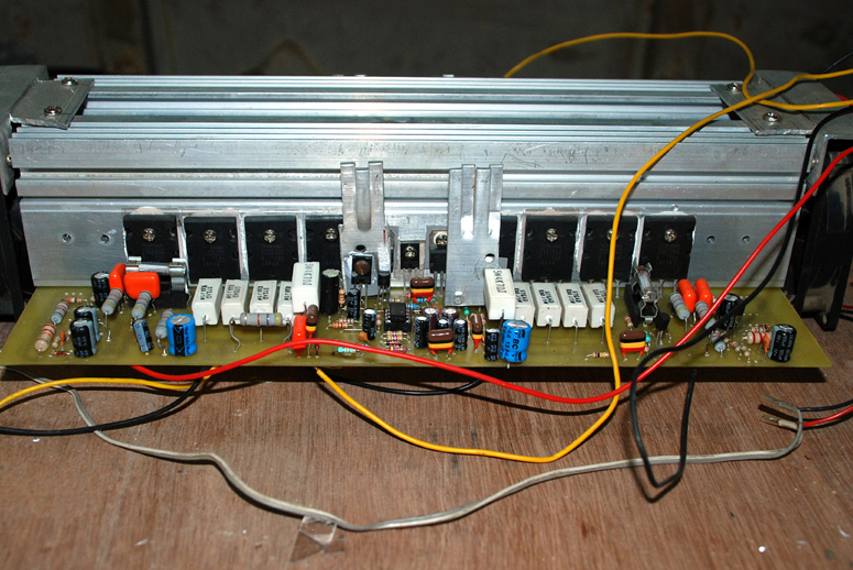

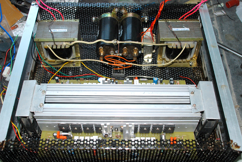

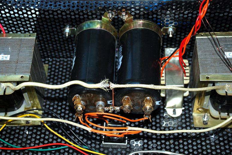

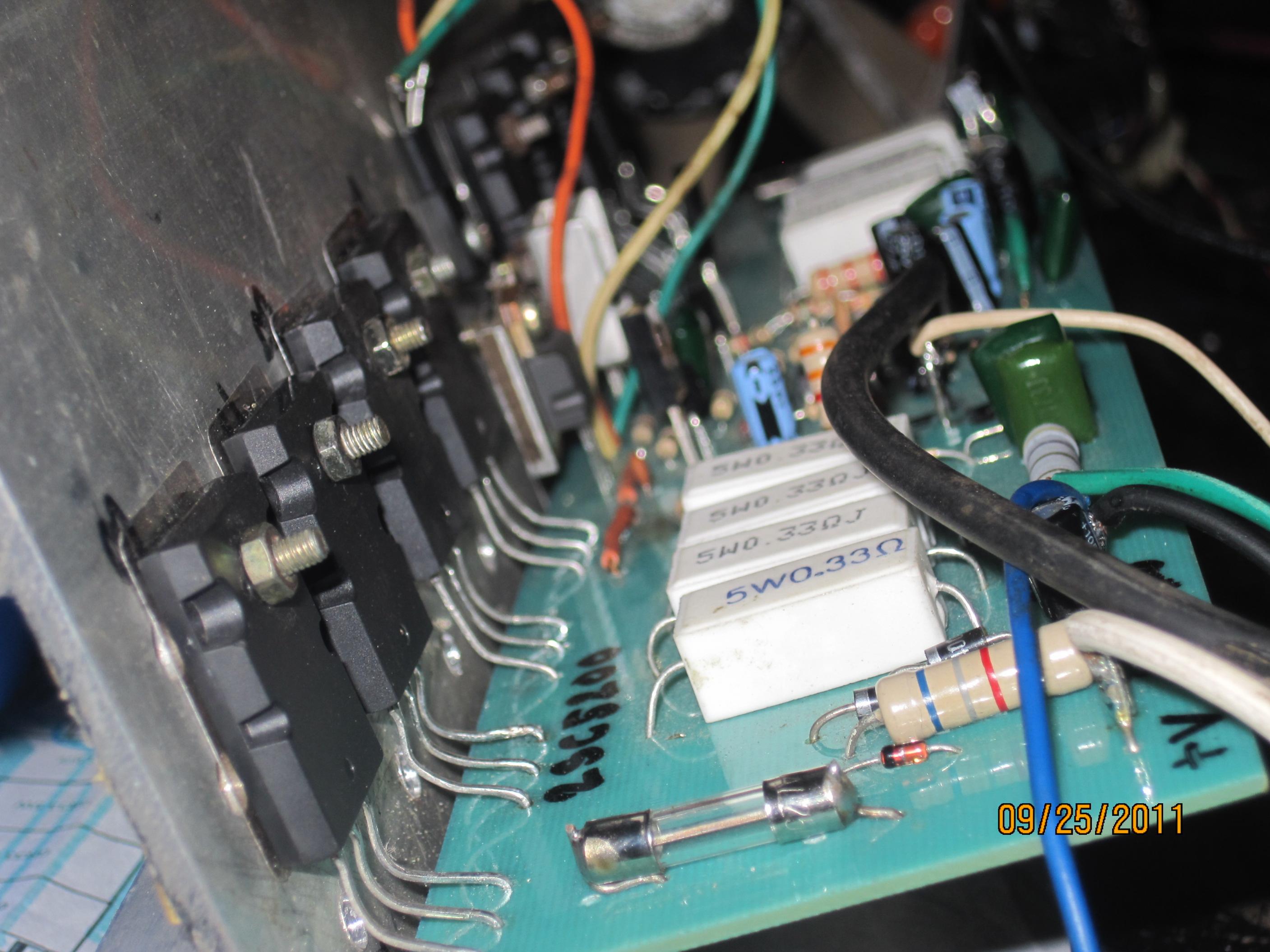

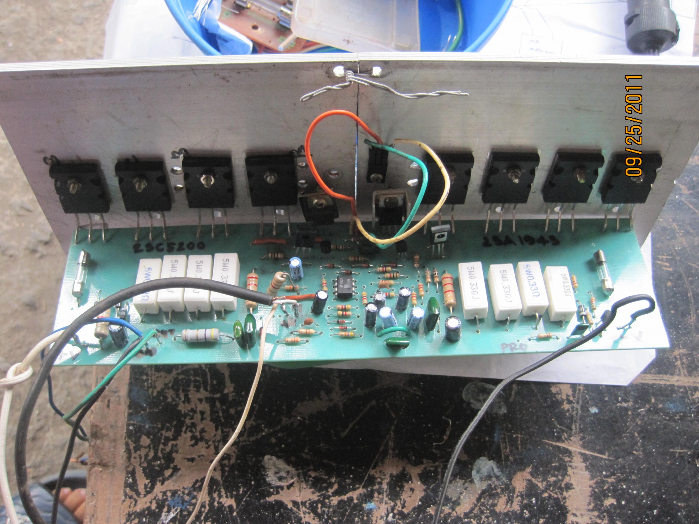

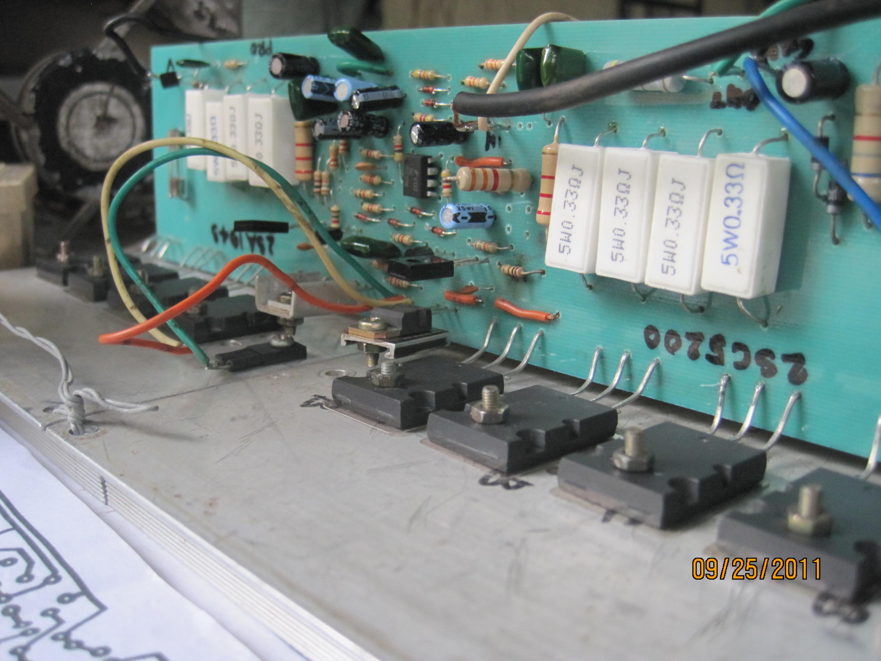

my first b500 experiment.... its nice good sound quality thanks to sir apex....i had encounter trouble when i turn on my b500 1st the the circuit was shorted fuse of the psu burnout i check all the connection and the parts i notice that some parts interchange like the transistor 340 & 350.... affected damage transistor was mje 15033 15032 and resistor 100 ohms... what i did what i did place the 340 350 to the exact place and im using tip41 and tip 42 is okey sir apex its working fine and good quality sound i like it......

mile where are you...i need result abaout my question (about apex B500 routing BTL )
regard
Azka...Mr.Mile haved sharing schema BTL or layout PCB a long time ago. You can find its on title Apex B500 or Apex H900..
