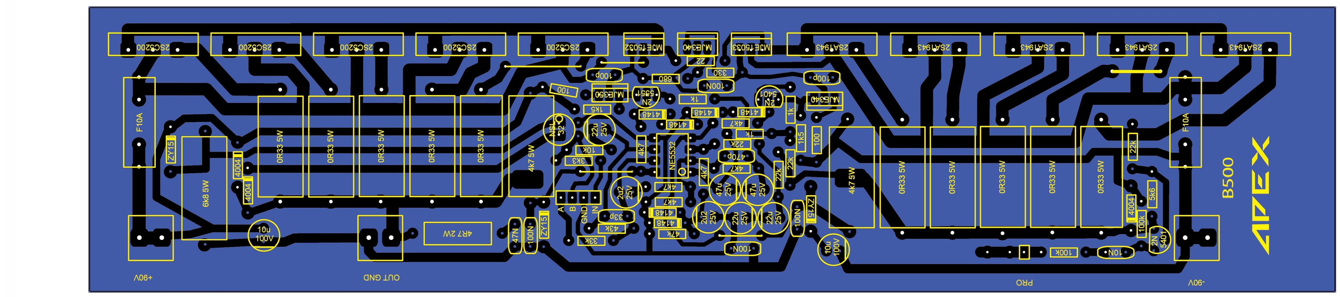

hi apex sir,
b500 with 5 pair output. any mistakes pls let me know.

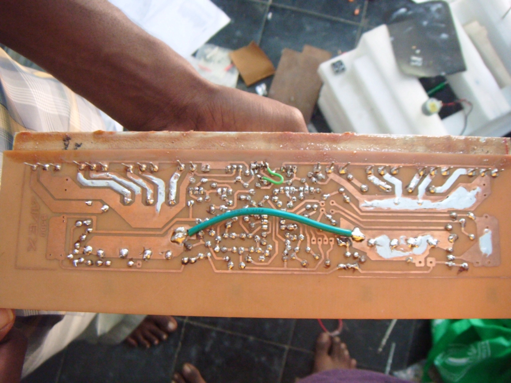

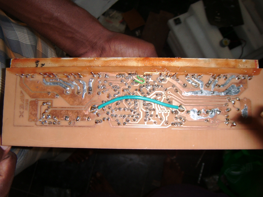

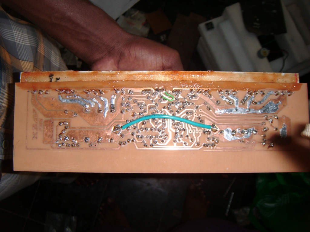

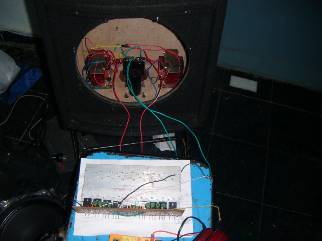

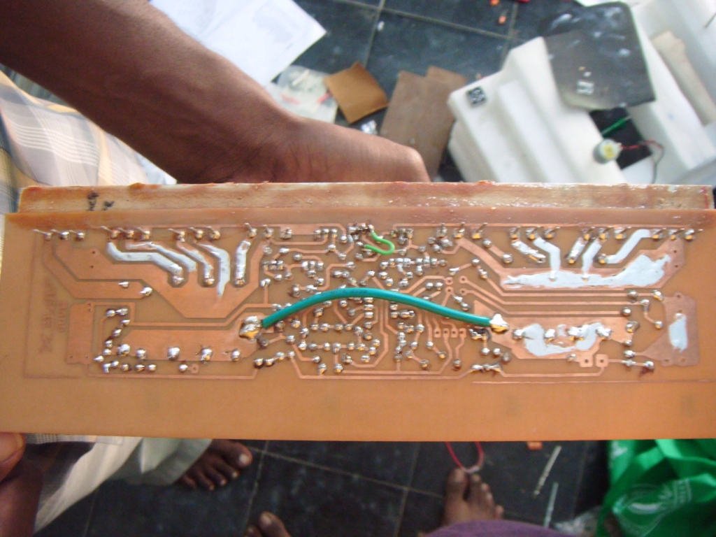

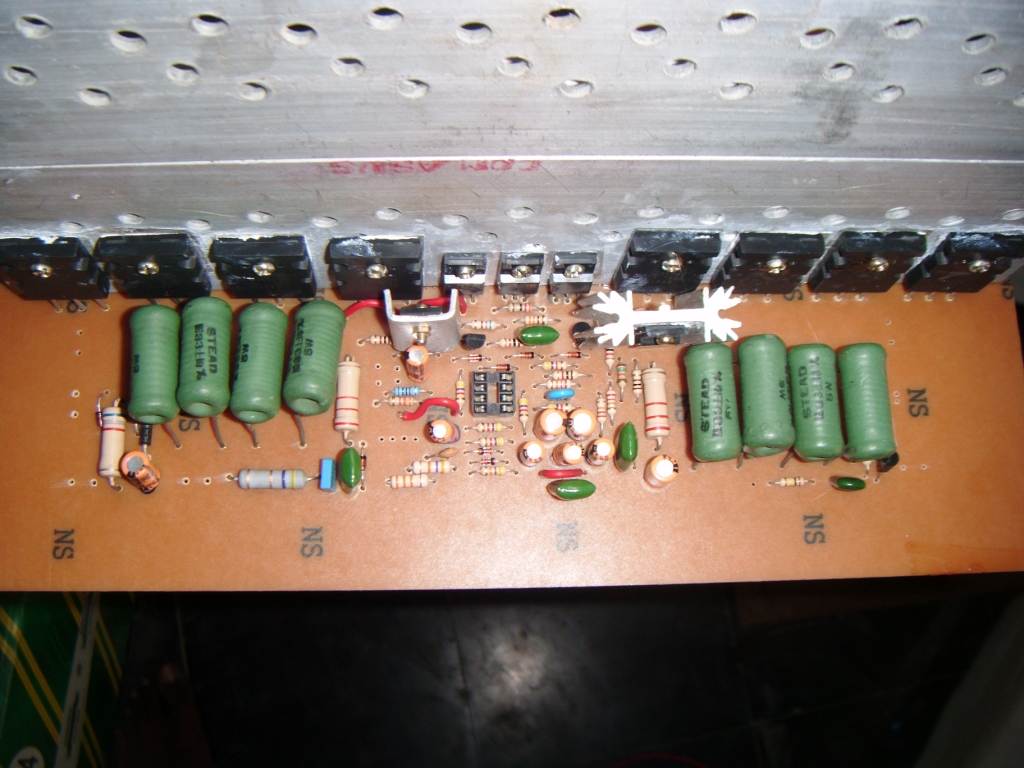

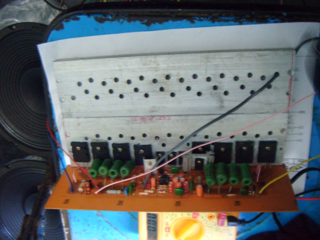

APEX B500
Sound is nice,no noise but getting very low sound
Bias is 4.5mv at 0.33R may be 13mA each output
DC offset is 5mv
I have used 2sc4793 2sa1943 instead of all mje's and R4-47K,R22-1k

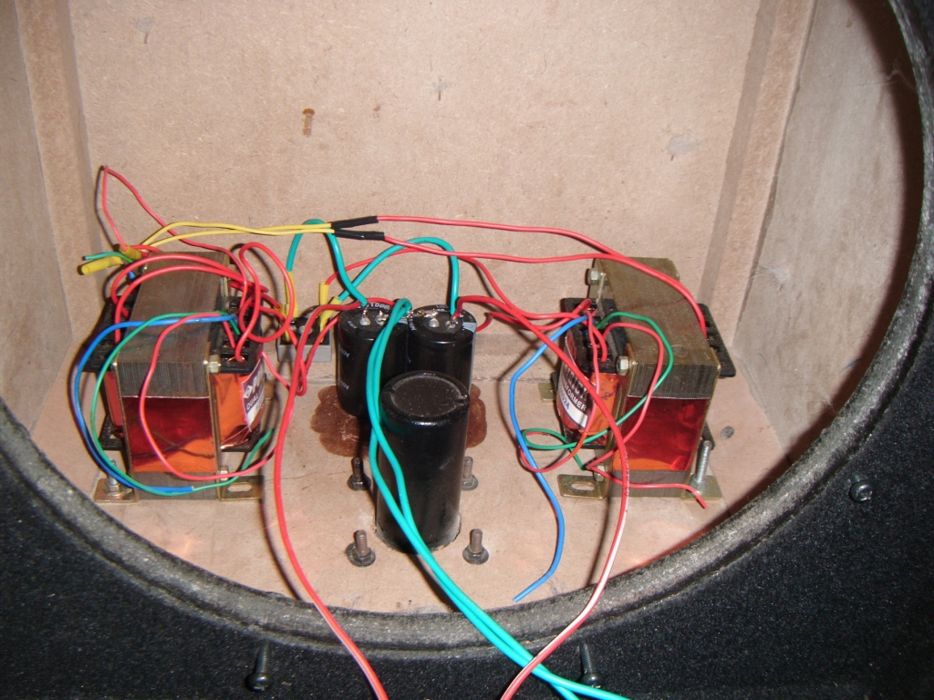

PSU: 50-0-50 AC (two 25-0-25 in series) 10A=====72-0-72 dc at 20,000uf total
I have used mobile phone as input (350mV)
but sound is very low,when i measured output with multimeter its getting 16v RMS only
Is this normal?

You need preamp (5X gain), 350mV is to low for full power.

yes, you have a gain of x45, a 1volt input should drive your amp to almost clipping.
