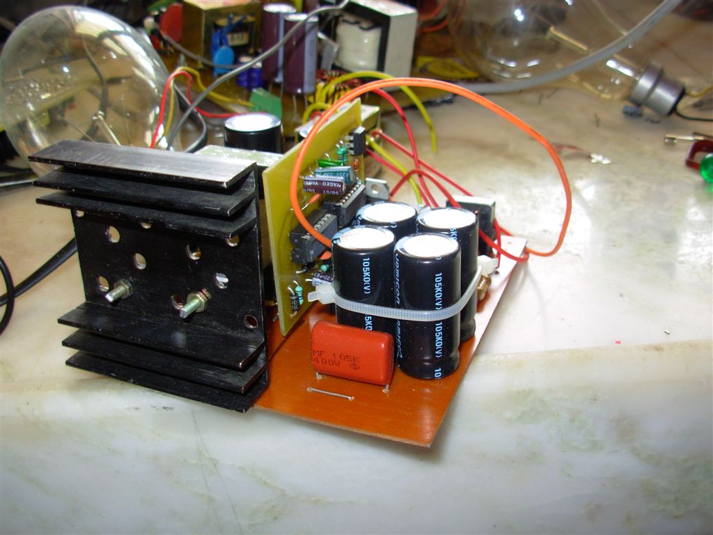

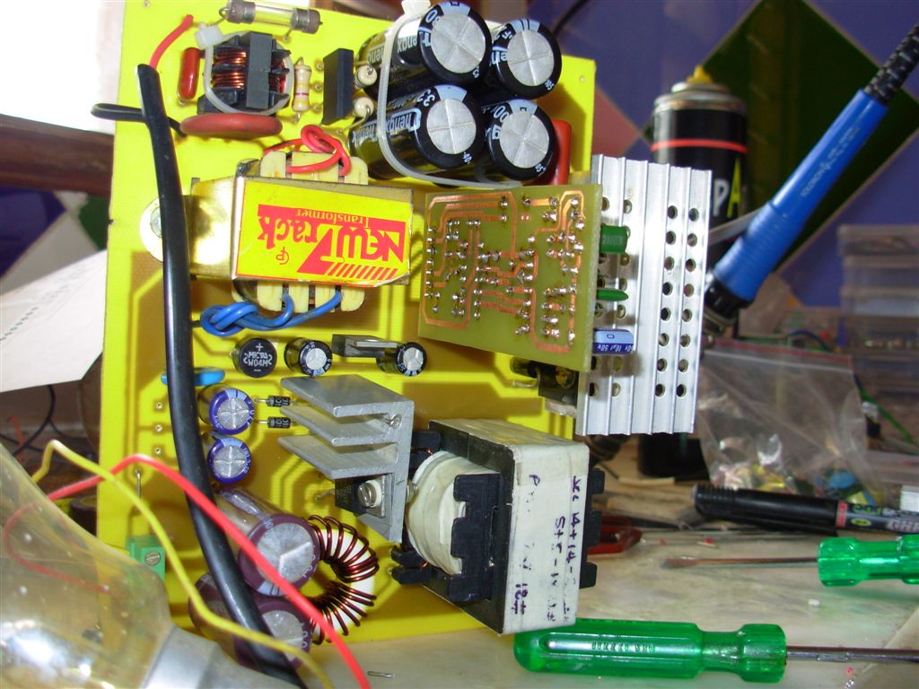

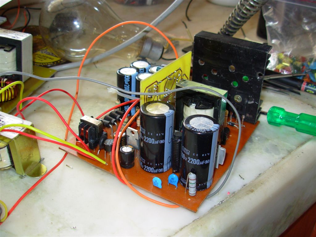

Few actual photographs of the two prototypes
