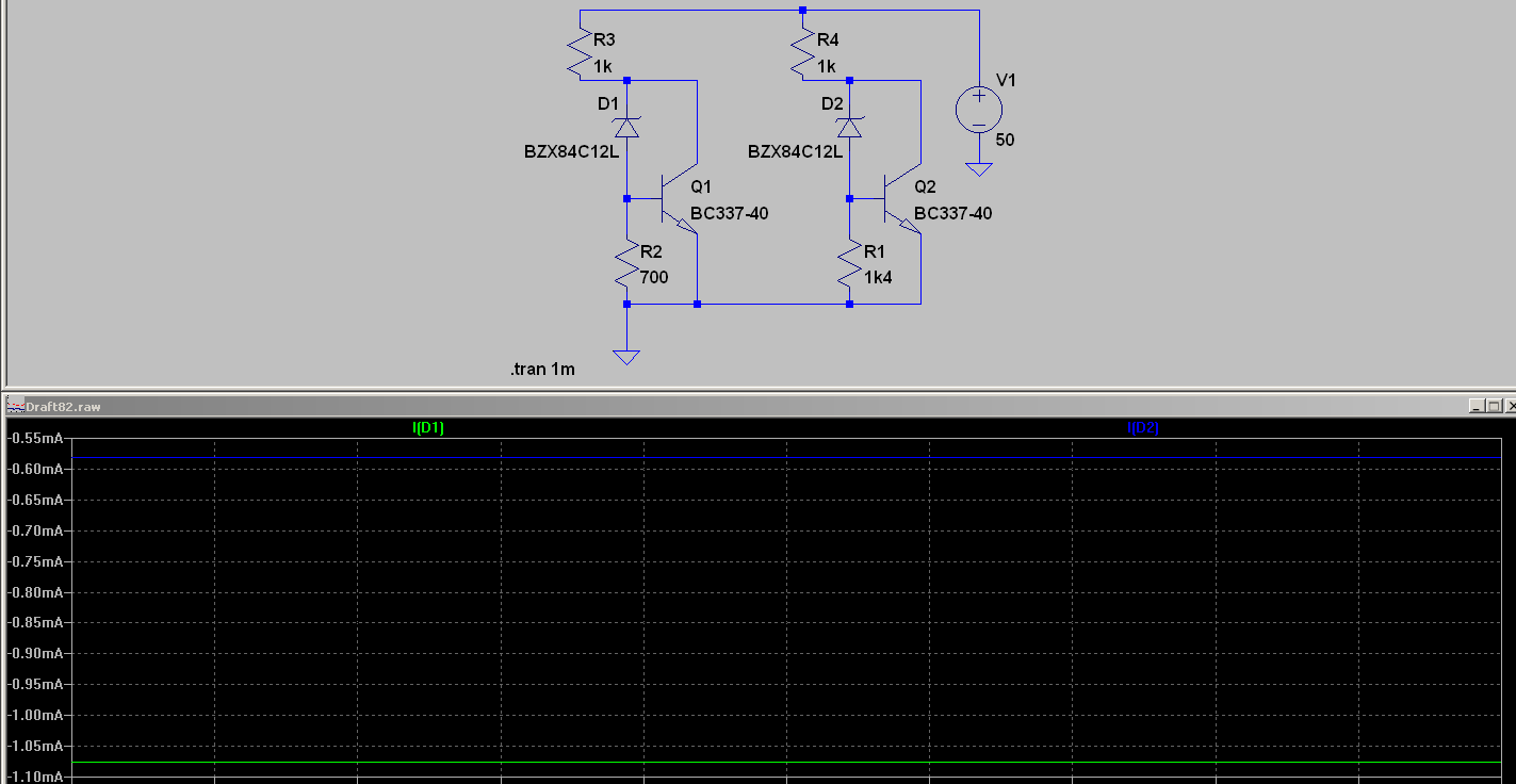

Shunting opto's LED will increase Zener current. That happens due to negative feedback *loop*. You can easily analyze the feedback loop going "backwards" assuming SMPS is in steady state.
I'm attaching a pic to illustrate that. In steady state Vbe would be ca. 0.65v, assuming the base current is much less than zener current we can easily calculate zener current for both cases: it would ba ca. 1mA and 0.5 mA.
It works just like that with the opto's LED & Zener current.

I did it first with the known schematic, and based on that I told no serious problem with the design. But the built circuit didn't work. So it must be different. So you can't analise it, because you don't know it, you don't know the difference. But I proposed a reason with a single error that can explain the experienced problem. Did you understand it?
This has no relevance to zener. Please note I perfectly know how feedback work. But you talked about zeners. Did you measure zener voltages in your simulation? Do they differ significantly? Are they much lower then specified? I bet not. Then your remedy is not working. The diagnosis was already false. You should have calculated opto current, as I did.

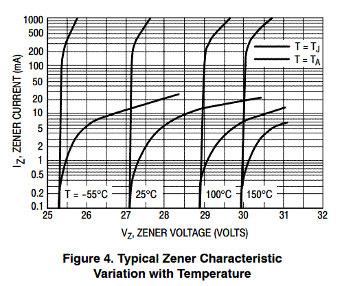

If a current flowing through Zener is less than the knee current you wont get "stable" voltage drop (please learn how to read Current-Voltage curves, see https://en.wikipedia.org/wiki/Current–voltage_characteristic )
I'm not going to "Proove" anything to a person who can't read I/V curves and have issues with NFB loop analysis. I already spent too much time explaining very basic stuff (with no luck).
And what do you think knee current is? 10 uA? 100 uA? Over 4 mA? Have you ever measured one? I did, many times. Do you think ignorance overrides experience? Have you ever checked leakage current specification of zeners?

You have no right and you have no ability to judge my skills. And you have nothing to base it on. You haven't linked any real I/V curves, only some intentionally distorted simplifications. You are misdirected (...by yourself actually).
If you think I lie, read it from ONsemi:
http://www.onsemi.com/pub_link/Collateral/HBD854-D.PDF Figure4. You can clearly see that zener voltage is at least as stable at 0.1 mA as at 10 mA, or much stable depending on temperature changes.
