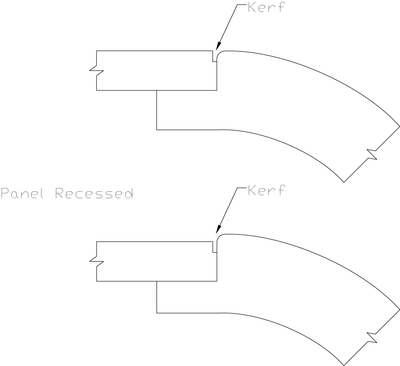

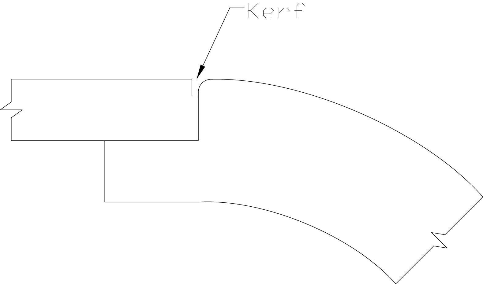

Even plywood will move a bit. What WHG proposes is a way to keep the attractive aspects of the corner(s). The quirk doesn't have to be physically large ... just enough to look like it belongs there. Nothing like checked filler to ruin a paint job ... as I'm sure you know. ....and you've doubled the chances (two joints per corner).

Today screwed around with the front corners today made a mess of one so that will be used on the spare pair of cabs .
I'ved screwed together the sides to the base to see how it all fits ,thank god for filler and polyester spray filler ;):) .
Theres about 2mm extra in the radius to be sanded flush with the side panels .
Cheers
