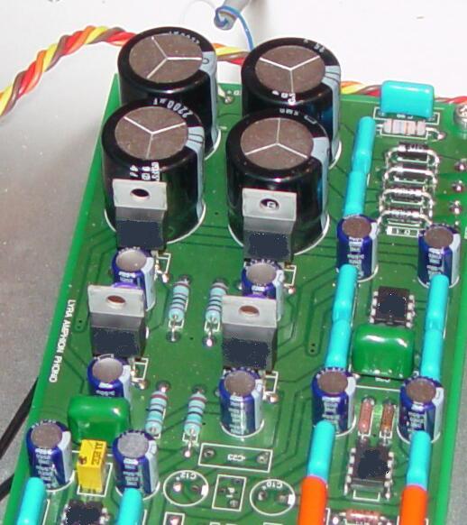

I don't think he is bluffing since he designes some very eleborate discreet transistor regulators. Shown here with phono preamp, with carefully selected three terminal regulators. I have seen a closer up picture, its hard to see here.

Dear Fred:
The power supply of the prototype unit in the photo that you posted consists of R-core transformers with dual secondaries, dual-bridge rectification, industrial-grade filter capacitors, and low-dropout adjustable regulators, with composite electrolytic and stacked-film bypasses at every load. But I did put a reasonable amount of effort into the board layout and harness design, and I can state with a reasonable degree of confidence that much of the sonic performance can be credited to this, rather than the components or topology (neither of which I consider particularly remarkable).
BTW Fred, I appreciate the masking gesture, but I already took the liberty of placing the really fun stuff _underneath_ the board, where it would be hidden from view. ;)
OTOH, for the production version, I am either going to put in a super-shunt regulation scheme, or a linear pre-reg and shunt reg combo. Yes, there has been the occasional daft discrete regulator or two (or 48), but not this time :).
I will probably also incorporate a variant of the following flyingcap circuit (Fred and Andy are both familiar with this one), although if previous experiences are anything to go by, I may want to multiply the total amount of capacitance that goes into the power supply by a factor of two or three over what I would normally use.

"I already took the liberty of placing the really fun stuff _underneath_ the board"
Well maybe not all the fun....... I cropped what might have been a **d* ****a* out the the photo and bet there a could few more ****a*s hiding on the bottom of the PCB. Those sound very good in that circuit location and is one of the most important places to use **d* ****a* if you are going to use **d* ****a*s. Of course I could be completely mistaken, like I was about the 48 volt relay......
John Drake

Hi Fred,
And so we all have are little secrets.......
:lock:
