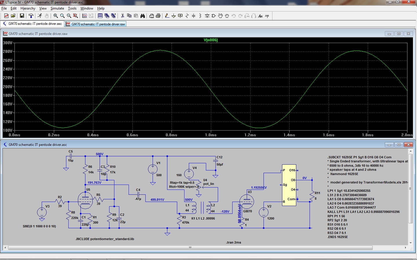

Hows this look for some voltage swing?
Don't pay attention to the remaining circuit (its a cut and paste), but seems to do about 18 watts.

deafbykhorns, a properly implemented pentode driver can sound excellent. I have used a variant of the posted C3g driver schematic with gas tube regulated screen and can vouch for its ability.
The g-k voltage on the schematic you posted is a whopping 128V, so you would be aiming at being able to generate at LEAST 150V clean swing each way. You would therefore be looking at a Vp of around 250V for a C3m driver, which would limit you to around 16-17mA current (I am looking at the Vg2=150V curves here btw).
The advantage with using a pentode in this application is that you only need the one tube and can also dispense with the costly interstage iron.
Other candidates that come to mind are the D3a, C3g, EL84 or perhaps the Russian 6P15-EV. A 12AX7 simply won't work in this application.

I would ditch the cap from B+ to screen and keep the one from screen to ground. Two caps form a voltage divider for any ripple on the B+ to the screen. Not a good implimentation.
Your right, it didn't seem to do anything for the circuit after running the sim.
However, my bandwidth is really bad after the pentode, almost a 5 db drop at 20hz.

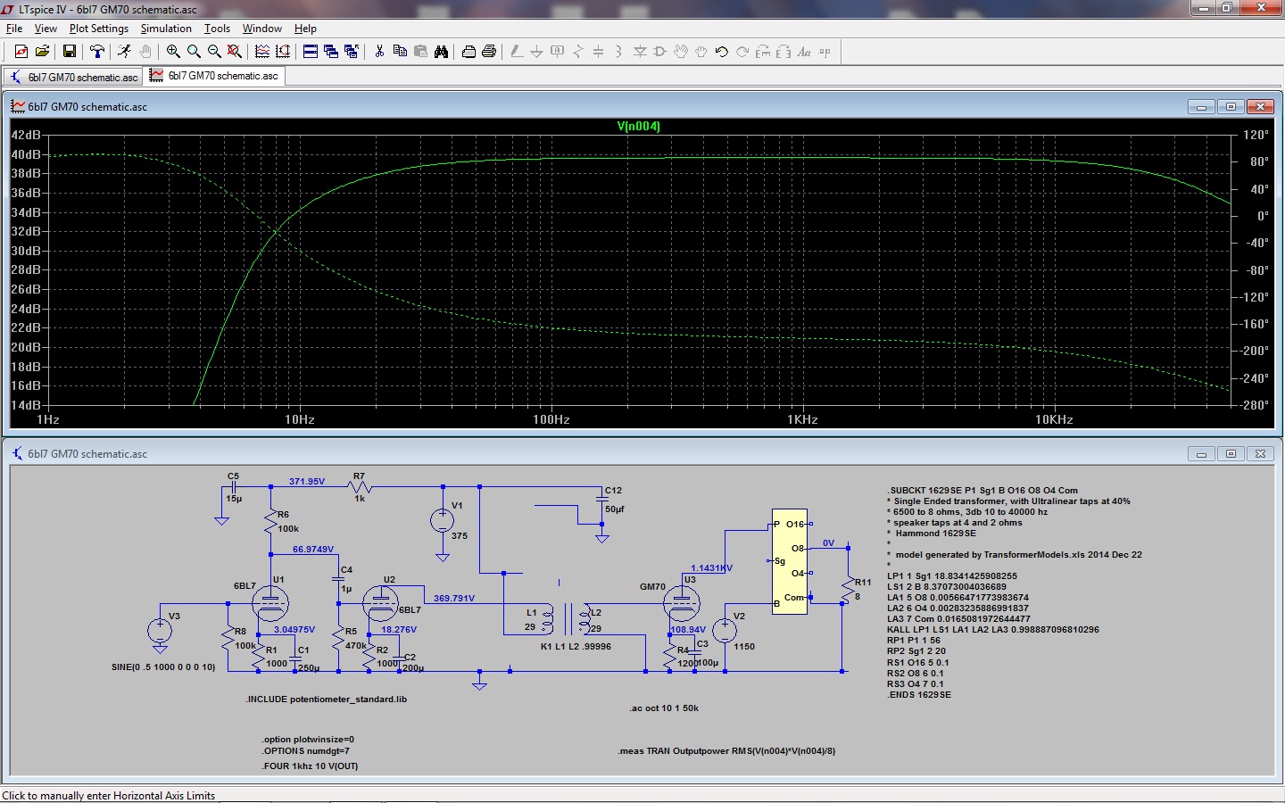

I like my SIM of the 6BL7 better, it seems to drive the GM 70 into A2 slightly when needed.

Yes, I simmed 124
The plot is after the pentode before the cap, that's were I read the drop in freq. response(which of course carried thru the IT and OPT).
IT is 5k, is that bad to use this with a 6bl7? I thought it would be better if the grid starts pulling some current on peaks. Plots look pretty good or am I missing something?
