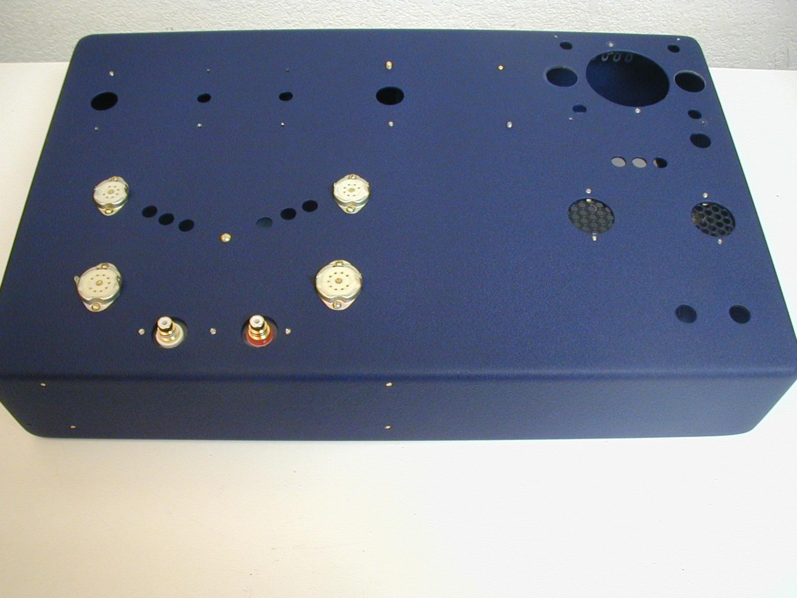

Nice !!

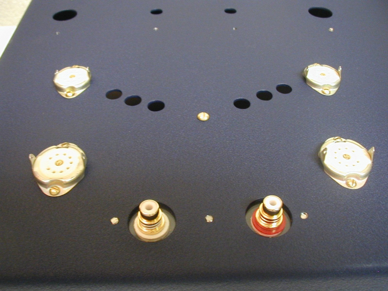

You might put your RCA jacks on the topside of the chassis, such that there is 2 inches or less wire span, between the RCA jack and the grid of the D3A !! It is a better design practice, and will usually sound better. Cheers.
Jeff Medwin
i know what you are saying...have done that too...
the preamp on the left have input and output jacks very close to the 6H8c tubes....while this amp is not nice to look at, it is the quietest line amp i have done so far...
Way to go !! On the contrary, I think it is beautiful to look at..." form follows function ".
Next, consider punching a 3/4 to 1 inch hole for RCA jacks, and mount them on clear plastic, or bakelite, so that they are even one step further removed from the various EDDY CURRENTs circulating in the metal chassis, it becomes a double insulation. Looks cool too.

On your question of short ( 2 inches or less ) leads between the RCA jack and the grid of the tube: I will "attempt" a reply.
The signal at the RCA jack input is the lowest level signal in the amp, and it is subject to degradation on its way to the input tube's grid for amplification. There are two types of losses that come to mind off the top of my head ( 1 ) losses in the signal wire itself and (2) losses due to "outside fields", magnetic, etc. interacting with the music signal's propagation down the wire.
I DIY try to counter (1) above, wire losses, by using not one, but two runs of 19 AWG solid silver wire, or perhaps one run of Kimber multi stranded AGSS silver wire to the input tube's control grid. I try to counter (2) above, contamination by extraneous fields, by making the lead length as short as practical, which is 2 inches maximum from RCA jack.
I hope that makes sense to you. I could envision someone trying to "flame" me for this post. Oh well...

This blue chassis ( where I am showing RCA jacks' proximity to input tube ) deserves a brief description.
It is to be one section of a 12AT7 input tube, directly coupled to a triode-connected 6AQ5 finals tube, into Magnequest DS-050 SE Outputs. I imagine about 1.3 Watts output, destined as one of two or three SE DC amps for my new Altec A7-800 modified speaker system.
The 6AQ5, triode-connected, is a "firecracker" of a tube in my opinion. A sleeper. YMMV, etc etc etc.
I also am building for myself two other DIY amps, one with the final tube being a JJ 2A3-40 and a third stereo SE amp using a 6AH4-GT final tube. Three (re) builds ... at one time !!

Jeff, with the additional care going into choice of chassis materials - do you recommend steel or aluminium - or would a non-metal chassis be better ?
Is there a sonic penalty for placing a metal cage over the amp (safety) ?
Well, IMHO, Stainless steel is the best, but impossible to work with on a DIY basis by 99.5% of the DIYers!!!
Regular mild steel has been my favorite choice for DIY builds. Nix on Aluminum.
Mild steel shields well, and is reasonable to Greenlee chassis punch through. Steel however, is magnetic, so all power supply and magnetic parts ( power transformer, chokes, transformers for output ) MUST be raised off of the steel chassis. I use all brass hardware and multiple flat brass washers to space magnetic parts in air, so their own magnetic fields don't couple heavily into the chassis.
I don't mess with non magnetic chassis. Some people do !! Usually prefer to do 14 gauge steel with welded corners for smaller amps, 12 gauge for massive ones. I LOVE powder coating amps. YMMV !!!
As for tube cages, do as you need to, I use none, all VDCs are below deck.

Where does the 2-inch rule originate from for input wire length from a RCA jack to the input grid? Also, AGSS stranded wire is 19ga... how does a single run of this equal two runs of 19ga solid silver? Also, what about the interconnect cable that feeds the amplifier?
If you (drlowmu) want to be taken seriously, at least try to come up with a gram of fact to accompany your kilo(gram) of fiction on your pontifications on how to build anything. Simple question arises... have you ever made any actual measurements on your builds?
