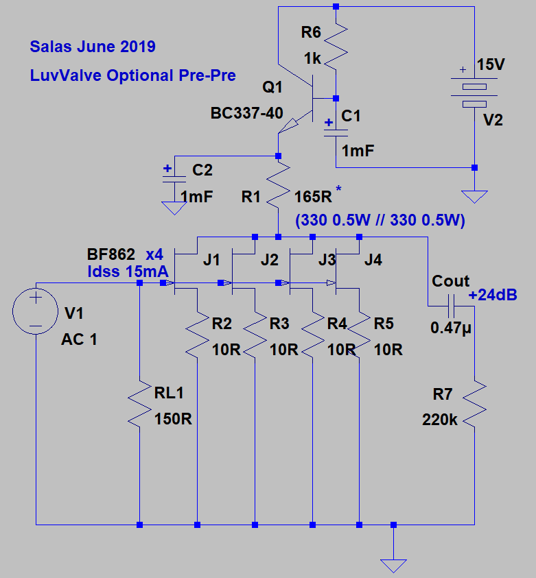

You made the two JFET pre-pre? More semiconductors also bring more junctions and more parasitic capacitance, not only extra transconductance. If your cartridge has so low output that you still have relatively weak signal with this circuit, and hiss is intrusive, then consider changes. Because subjectively everybody seems happy with it in this thread. Not to unbalance it with tweaks if avoidable. Link me the technical suggestions post please.
If you make R1 430R with 7815 chip reg and 20V raw DC input in post#2 circuit, you will get 28dB gain.

That's easy to do. Replace the 180 Ohm resistor (R1) with 250 Ohm. No other changes. Will give you 24dB gain. Judge the result and let me know.
I don't have 250 ohm resistor, I replaced R1 with 270 ohm instead. It sounds all right, gain is increased a bit from what I can feel.
Voltage across R1 now is 4.6V, the other end of R1 is 7.4V. is the drain voltage 2.8V too low now?
Also, my MM tube phono stage has around 0.5mv noise level, now with the this pre-pre it is around 1.5mv. No hum, all I can hear is hiss. It's not too bad to me, but can this be improved by replacing eBay 2Sk170 with BF826?

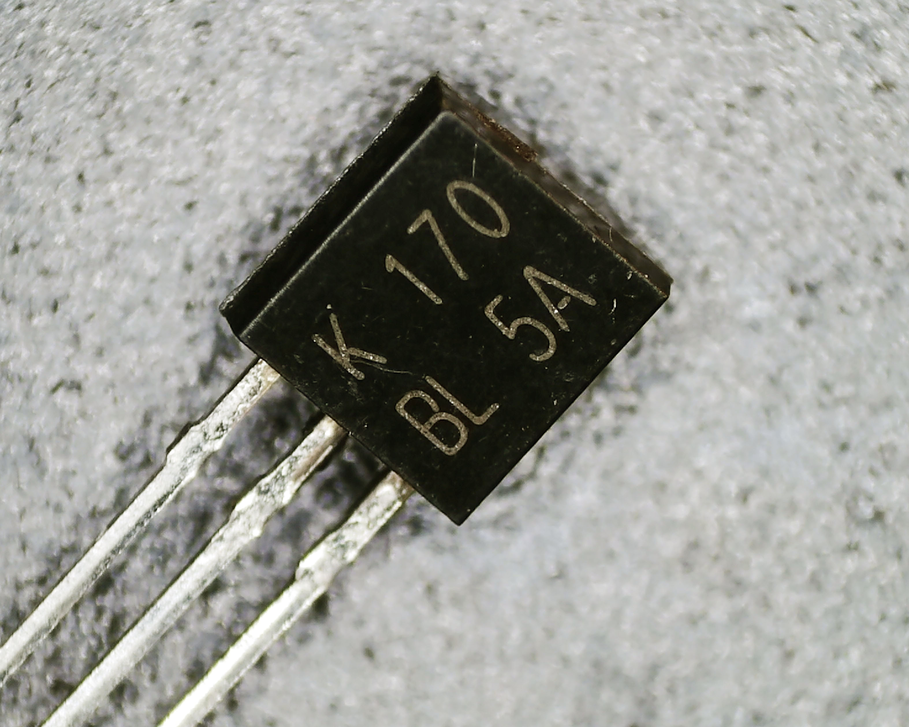

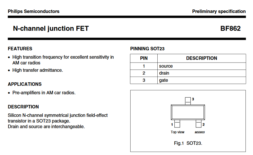

Better to have 12V regulator now. For more VDS. Can you post a close up picture of those 2SK170s you used? I want to check their originality clues. BF862 isn't much better and usually has much IDSS in a little SMD package so bit difficult to use without degeneration resistors for best noise without heat. Except you must, in case the 2SK170s are fake so the gain is not as expected and the hiss higher. Do you have any 2SK369s by the way?
Try with four BF862 in parallel but with independent 10 Ohm resistors for each one's source pin. Those most possibly can't be fakes.

I replaced 9V reg with 12V one, it sounds much better now.
I will try 4X BF862 in parallel and see. But R1 still 250ohm if I need 24db gain? how about reg voltage ?
I have 50-100 BF862s and a test socket but I can't readily breadboard them as a pre-pre to answer you for sure. Because SMD I would need to make an etched test board for that. I'll see if I can simulate the whole configuration instead.
Will reply later. You put the thing together to see how it works. Even with the simplest circuits you never know before actually building them. Their gates may tune with the incoming signal wire and you could hear the AM radio for instance. They were originally designed for that.

Paralleled BF862's can sometimes oscillate at 100's of MHz without gate stoppers, depends on careful attention to layout.
