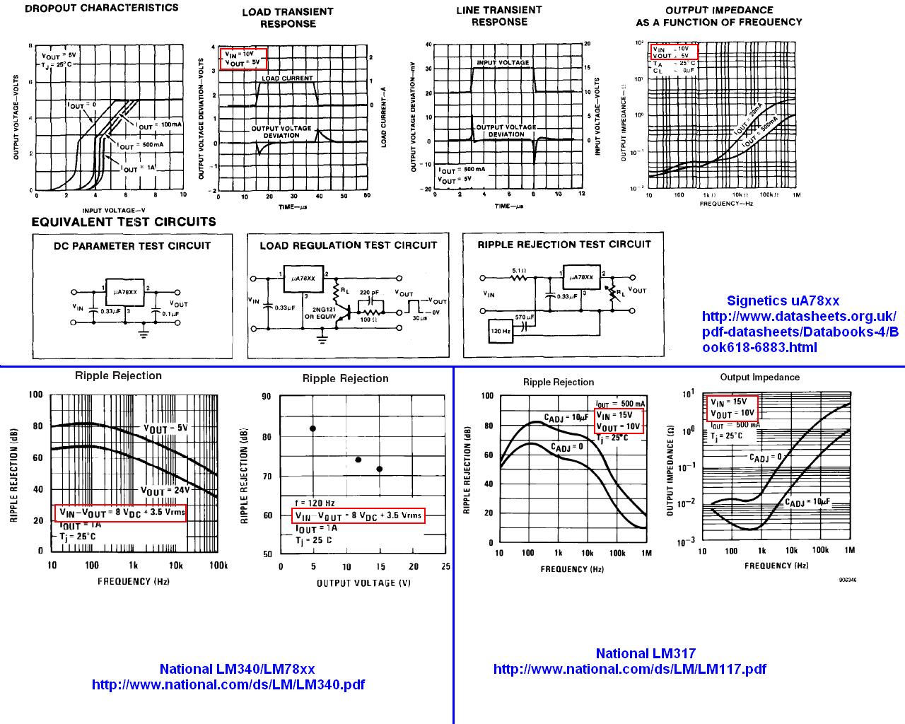

http://www.diyaudio.com/forums/power-supplies/184068-psu-rc-multistage-filtering-2.html#post2486919
Tony suggests having a minimum of 5Vdc difference between input-output on LM 317.
It is my observation in praxis that this holds true for fixed voltage 3 leg regulators as well. It garantees specified regulation action from the chip.
This 5V difference is hidden in many of the performance curves supplied by the manufacturers of the voltage regulators.
Joined 2002
Dear Salas
With 35V in and 9Vout, Vdrop is 26V. This, times 15mA makes a 390mW.
Still not too high, but 35Vin is according to some manufacturers above from what they allow.

I did not suggest he uses 35V input. He asked what is the max input. 35V absolute max is on the datasheet. 18VDC adaptor is OK.
