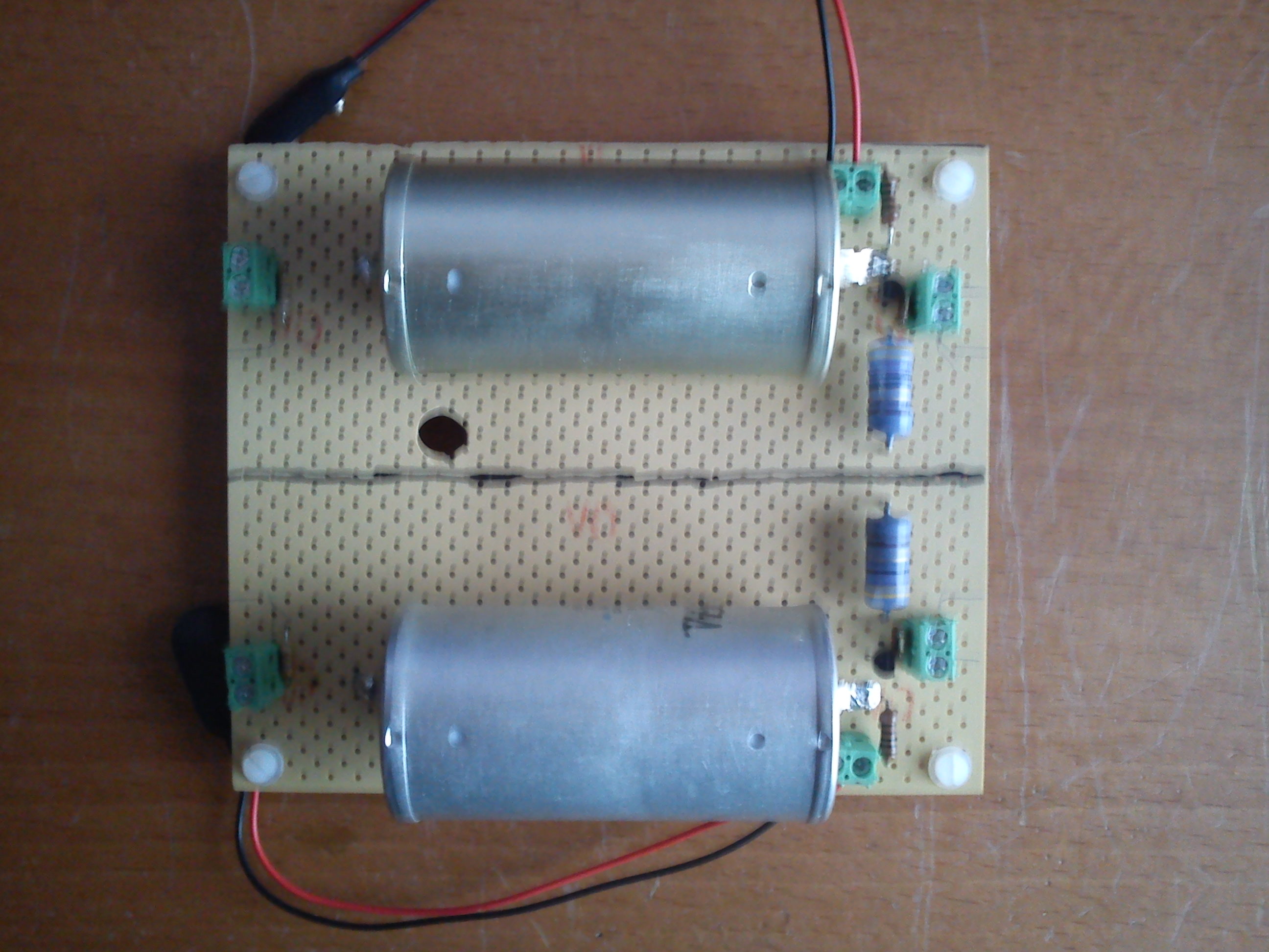

If I remember well Salas posted 20dBs but for a newbie like me the only reason to have same gain it's the double njfet Idss is 7mA & the single njfet is higher Idss but I'm not sure I only want to know Idss range for single njfet & if the gain it's the same because for me it's more easy one single njfet powered with alkaline 9V.

Wich gain have this schematic MC pre-pre, wich Idss something 7,5-9mA?
That one is not this thread's pre-pre. Its a single fet 20dB to work off a 9V battery for low enough consumption due to one degenerated fet and easy PSU, but hissier than two fets with no source resistor.

Anyway battery powered I don't hear any hiss and sounds very very good remind me Simplistic njfet mc RIAA, thanks again Salas. Next step I'll try with two 2SK170BL 7809 regulated to compare vs single 2SK170BL battery powered

I prefer single SK170BL battery powered vs Jim Hagerman Piccolo mc pre-pre, also I prefer single SK170BL battery powered vs Partridge 977 step up.

What cart does it step up to what MM stage? If you will judge battery life long enough and you hear no hiss plus liking the sound, no need to make a pre pre collection.
How many current spends the single 2SK170BL per channel?
Don't know, depends on battery quality. Say 30 hours to 75% of nominal voltage? Maybe. You will see by using it.

If you make R1 430R with 7815 chip reg and 20V raw DC input in post#2 circuit, you will get 28dB gain.
