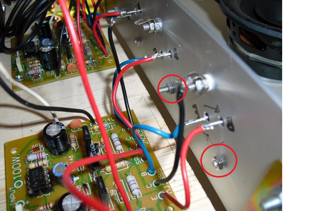

ok, something starts to go the right way, I put two resistors of 100 hom (the first ones that have happened to me)
I changed the two diodes 1N4148 to 1N4007 (I had those ...)
I have the positive 18v and negative 32v! possible? of course after the two resistors
up trimmer I have respectively 8 and 9 v
I still have no heat or burn the speaker wires disconnected and unplugged for collectors.

this is the end ....
I removed the two resistors 100 hom
I connected the collectors
and ... the lamp is on, I have noise from speaker
and the bias that is not responding!
I have left to put the two capacitors between B and C of the two transistors ponso pilot but that will solve .....
I finished the ideas .....

You have put insulators under the output transistors, but it doesnt look like youve put insulators under both fixing screws for these. See pic

The circuit is missing a couple resistors. There should be emitter resistors for 3055/2955, 0.2 - 0.5 Ohm. How can you determain how much current is flowing in the outputs without this resistor or an amp-meter in series with the output transistor emitter? Due to the high transconductance of BJTs this resistor is necessary to maintaining a stable bias.
Figure from the datasheet, Hfe for this device is 50 @ 50mA bias, then 1mA of base current is required. The BD139/140 bias is, or must be greater than 1mA so the outputs saturate. A resistor is needed from the base to the rails of the 3055/2955 in order to prevent them from saturation and smoke. Voltage across this resistor will be ~0.7V. Figure the value by whatever current you want to bias in BD139/140 drivers.
There are two types of compensation needed for stable CFP amp with BJTs. Frequency compensation to prevent oscillation instability and thermal compensation to prevent thermal run-away. In the CPF it is the drivers that need to be thermally compensated not the outputs. The BD139/140 should be mounted on a small piece of metal along with the biasing diodes. Due to the proximity of the places on the PCB for these components it should be an easy modification. Adding the missing resistors shouldn't be that hard either. I would not expect spectaular perfomance form such a simplistic design but it should at least work with a few mods.

as already mentioned the isolation of two transisto TO3 compared to aluminum plate is isolated.
I checked with the tester and between EBC and the aluminum plate is isolated.
maybe you can not see well, but I'm sure it's right. in any case, tomorrow I will do the following changes and again the following tests:
1) change the resistance from pin 6 of the 741 goes to the two diodes from 47 to 5 hom hom.
2) change the resistance from 12-15k or 10k
3) I put two condensers 680 pF between B and C of the two driver transistors.
I have already changed in the two diodes 1N4148 and 1N4007 1k trimmer to 4.7 k
I will do readings without connecting collectors with two resistors from 220 to hom 5W + / - supply and without connecting the speaker and see ...

I agree that two resistor are missing, but unfortunately I have not designed this ampli.
for other explanations, I agree that if the polarization of the transistor must be a specific value, and it would be nice to check and verify certain values and currents.
But unfortunately now I'm at a stage when I turn there's something burning ....
