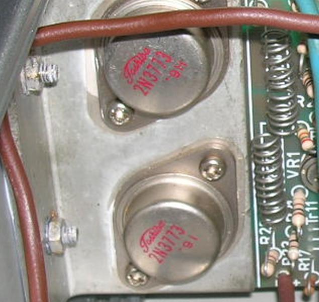

Toshiba did make 2N numbered TO3 transistors
Yes, here's a 35 year old pair of Tosh 2N3773
ok, didn't think they did, but i guess they actually did make some.... i'll make a note of that.... those look like steel covers on a steel heat spreader... not aluminum covers.... i'm keeping track of such details
and, yes the toshiba logo is script not block letters....

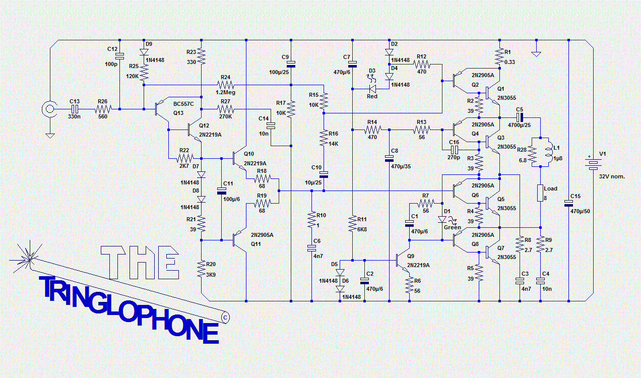

Just to show that the 3055 can work well for audio, here's a pair of new amplifiers with 3055's (and similar!).
Not currently in production, as far as I know.
Tringlophone, Class A, from Elvee
Tringlophone can use most output devices--the compensation will merely roll back a modern output device to approximately a 3055 speed anyway. There's no switching going on in class A, so really, the spec to look for in an output device for it, is linearity, such as the highly linear MJ21194.
The covers are taller than average and the top is domed. If I get a reason to go inside that amp I'll get you a better shot.
I did find a mention somewhere on here that the Toshiba 2N3773 was actually a relabled 2SD873.
if they are genuine toshiba devices (which they look to be) relabeling them from a 2SD number to an equivalent 2N number would have opened up a US military market for toshiba.... one thing about Toshiba is that they have a very comprehensive reliability tracking program, which mirrors reliability programs required for supplying US government contracts.
Yes one, the circlo has better dynamics than anything else, but tringlophone is more accurate. Tringlophone will best that jlh due to power circuit. I had minor tone trouble with my circlo although it did everything else optimally.Have you any thoughts on the sound comparison between the JLH 10W Class A and the Circlophone based on 2N3055 outputs ?
