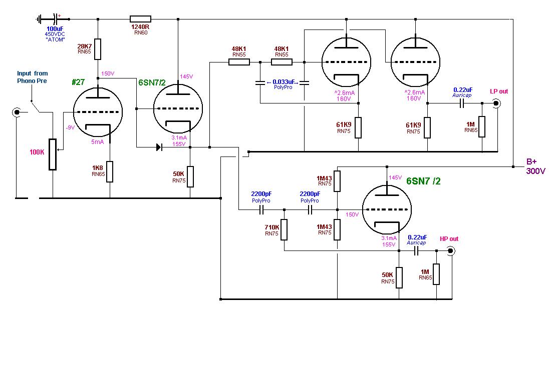

Kevin - Jacques,
I have NO experience with Spice modeling at all. I can work with Ohm's law (backwards and forwards), use plate curves, calc gain, miller, etc...all the usual calculator and paper type math.
I "think" I have my hands around the issue. The 33nF cap and the Output Z of the follower form a Pole with F3 of about 12Khz. You are saying somehow this affects the crossover total "blocking"? So at say 93hz we are down 7 octaves so 42dB?
Am I understanding this correctly or am I off base? Theoretically getting the output Z down to 10R would put the F3 at 480Khz so at 93 we are down about 12 octaves so 72dB?
I read the attached info, could I use a SS Op-amp somehow?
Or an additional tube?
How would I do this?
I don't think that's quite it. Take look at the EDN article, esp Figure 3 which shows the shunt path.
Anyway, there are primarily two ways to address this. One is to decrease the cathode follower Zout and/or increase Rfb. It is primarily the ratio of Zout to Rfb that determines the stopband attenuation. The other way is to provide an additional buffer for the feedback cap. This could be solid state, which I am assuming you would like to avoid Or it could be another cathode follower. If you add another buffer then the output impedance of the buffer becomes less important.
Let me model this and get back to you. Unless Kevin beats me to it .

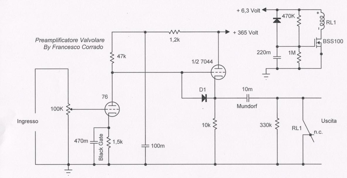

hi Coldcathode, many years ago i have realized a preamp tube much similar to your last attachment.
The second stage employes a 7044, that is equivalent of the 5687, but it's specifically suitable as follower, because it can support double cathode-filament voltage (200 V) against 100 V of 5687.
Regards, Francesco.

Francesco,
I see why you would want that high spec on the heater-cathode voltage. I am now "PUSHING the ENVELOPE" with the cathode at 111V.
What Plate voltage and current is the 76 running at?
How was the sound.
Did you try it with unbypassed Rk? or did you need the greater gain?
I think I have some 7044's (IBM maybe?)
I prefer the Octals but since the 76/56 are St shape I guess the followers do not really matter anyway. LOL

Hi, for maximize the linearity of the 76 tube, the supply voltage is better higher in value: in this case is 365V. So the cathode voltage of 7044 is near 180 V.
76 tube is a very low mu triode, but if you not need much gain, you can omit the 470mF bypass cap
Francesco.

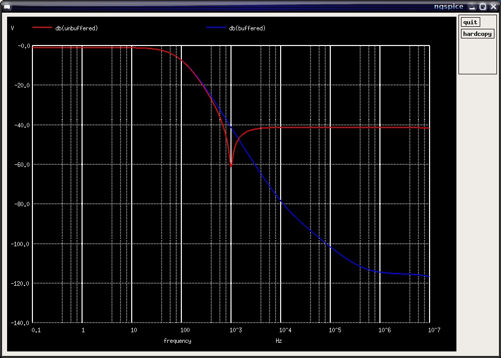

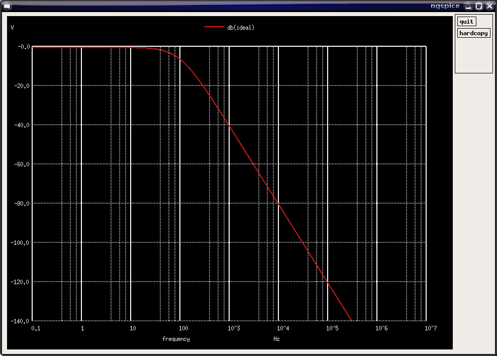

Here are the results of the simulation. The first plot (ideal.jpg) shows the ideal response of the low pass section (i.e. zero output impedeance of the output buffer). The second plot (actual.jpg) shows the response of the low pass section as you have drawn it (about 41 dB stopband attenuation), and with an additional buffer isolating the feedback capacitor from the filter output. The version with the additional buffer follows the ideal response pretty closely down to about -80 dB or so, after which point it deviates more significantly.
Reducing the output impedance of the buffer is another approach. In that case it would take about a 10 fold increase in transconductance of your output tube to effect a 20 dB improvement in stopband attenuation.
Hope this helps.
Jacque,
Suppose I would "accept" using an Opamp? What would the circuit look like and which Opamp do you reccomend?
I would recommend that you consider something like this with an additional cathode follower rather than use an op-amp. This is the configuration of the "buffered" circuit I ran the simulation on.
Jacques,
Something like this?
I might change the tubes a bit, 6BX7 have a higher Heater-cathode voltage tolerance lower Rp and higher Gm. If I have enough of them in my drawers I might go that way.
More concerned with the topology right now the specifics can wait.
I thank you very much for your assistance.

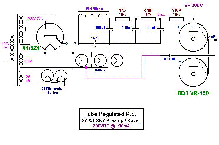

All,
Attached is a quick schematic of a PS for the Xover project. I would like to "lift" the 6SN7 follower's Heaters since the cathodes are at 155+V. (Vintage NOS Tung-Sol 6SN7WGTA's).
The heater winding on the Power Xformer does not have a CT.
In pink on the schematic I show a "tap off" of +150V from between the (2) VR tubes. Is this "OK", do I need a current limiting resistor? a small cap?
Should I just use a Voltage Divider from B+?
Lifting heaters is new to me.
Can't upload picture???

Yes, that's what I meant. Bear in mind that this does not address the issue raised by SY, which should be taken seriously. That particular issue is new to me and I will be spending some time to get my head around it.
Good luck,

Please comment also on the Heater Lifting.
I do think that lifting the 6SN7 cathode follower heater supply to +100V is a good idea. In your sketch it appears that the 6SN7 heater supply is still connected to ground. I would probably use a separate 6.3 volt CT transformer for the 6SN7s. I would connect the heater CT to a resistive divider between B+ output and ground. Two equal value resistors of 1 Megohm should be fine.
It is usually not a good idea to operate separate tube heaters in series other than for tubes which are specifically designed to be operated that way. IIRC, those were usually TV tubes spec'd as "designed for series-string operation". I would probably use a separate 2.5 Volt CT filament transformer for each 27, with the CT connected to the cathode, as described in the RCA datasheet.
