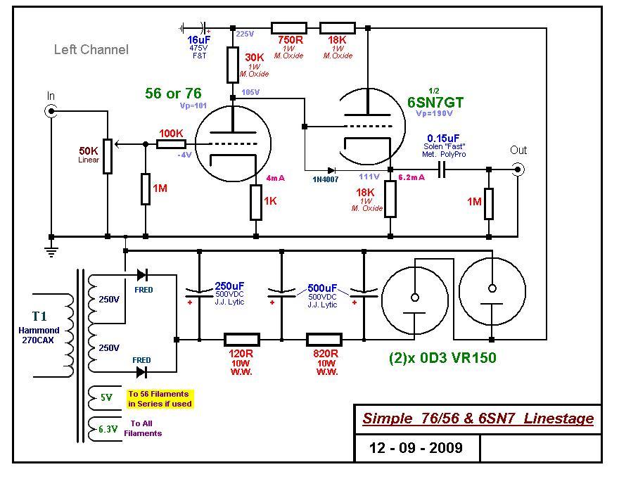

Update: A secondary project Schematic.
Hello All,
Updates:
1: I have gotten a new job! Will be working for Sikorsky Aircraft (makers of the Black Hawk and Super Stallion)
2: I put the 27 Xover pre project "on hold" while awaiting the PC boards for the subwoofer Tube/Chipamp Hybrid that goes with it.
I recently "inherited" a pair of old "high end" Ratshack (Radio Shack) speakers that were my Father In-Laws. These were very rarely played, they are very nice little book shelf type speaker with a high sensitivity. I am putting together a PP amp with 1625's (807's) "Triode Strapped". The "war dept." (WIFE) has approved them to go in the living room to amplify the Plasma TV and play CD's.
I was looking to build a simple linestage with nice aesthetics to give a little "push" of the CD/DVD player outputs.
I went thru my "tube collection" and happened across a few 56 and 76 tubes. Attached is the schematic for one channel.
Comments, suggestions, did I miss anything?
Hello All,
Updates:
Revised the two schematics, including a diode to protect the first 6SN7 from cathode stripping at turn on, but I can't come up with a way to protect the HP follower?
Also, made major changes to design of the Phono section but just now noticed that when in Phono mode the signal will be inverted relative to "normal" because of the odd number of gain stages. Any suggestions?
The only other idea I had was to bypass the Rk on the 2md phono gain stage (thus doubling gain) and recalc the RC values for that pole, then I could bring it's signal in at the junction of the 27 with the SN7 follower?

This is a comment about your 27 crossover. Have you modeled this circuit? If you do I think you will find that the stopband attenuation of the low pass section is only about -40dB. This occurs because the output buffer has a highish output impedance (400 ohms or so) and at high frequencies the feedback capacitor will shunt across the output buffer causing the input to appear (attenuated) across the output impedance. That can be addressed by providing a separate buffer for the feedback capacitor in the LP section.
This particular defect is present to some extent in all Sallen-Key implementations, but is reduced as the output impedance of the buffer gets closer to zero.
Here is a link to a post in a thread for a solid-state project with similar topology showing a solution.
For a more general discussion of the topic, refer to this article in EDN.

Jacque has a rather strong point about the importance of low output Z with VCVS (Sallen-Key) filter implementations.
Higher transconductance types than the 6SN7 will also help here, think 5842 for example. I would also check out the 5687 dual triode, it might also work well. (IIRC in spice models for an active x-o project I subsequently abandoned it seemed to be a significant improvement)
Other types worth further investigation include the following high transconductance pentodes: D3A, 6688, 7788 whether triode connected or operated as pentode connected cathode followers. IMO pentode followers could prove to be very interesting.. (Theoretically output Z should be much lower than achieved in triode connection.)

I have NO experience with Spice modeling at all. I can work with Ohm's law (backwards and forwards), use plate curves, calc gain, miller, etc...all the usual calculator and paper type math.
I "think" I have my hands around the issue. The 33nF cap and the Output Z of the follower form a Pole with F3 of about 12Khz. You are saying somehow this affects the crossover total "blocking"? So at say 93hz we are down 7 octaves so 42dB?
Am I understanding this correctly or am I off base? Theoretically getting the output Z down to 10R would put the F3 at 480Khz so at 93 we are down about 12 octaves so 72dB?
I read the attached info, could I use a SS Op-amp somehow?
Or an additional tube?
How would I do this?
