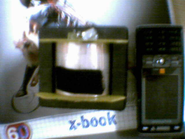

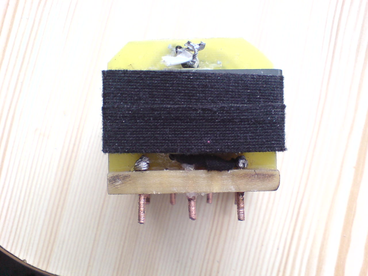

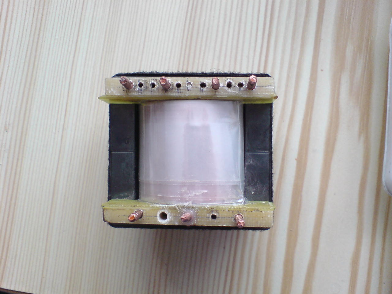

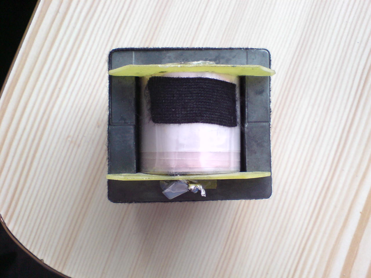

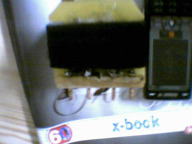

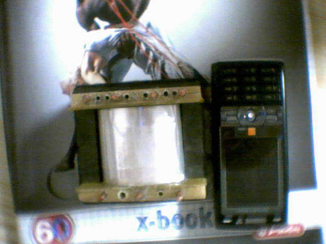

EE71 TRANSFORMER , DONE , THE pictures are poor , made by webcam
The transformer is wound with cooper foil 40mm wide and 0.1 mm thick

The transformer details :
Vin 390 (after PFC)
primary side 13 turs of 40mm*0.1mm
insulated with kapton tape 35um thick
actually the primary is spilted in two :each 6.5 turns, betwen them is the secondary made by 2*7 turn also with cooper foil , i expect 2*180 v at 40% Duty.
For 5 kw i need 13amps , and that is nothing for this tape , it can easily withstand at 20A
40*0.1=4mm^2
and at a current density of lat say 5 A => 20Amps
Luka if you visit Romania i can find you this cooper foil at 20 usd per 25 meters
The transformer ist's big , the material is 3F3 and the coil former (bobin ) it's made from sticlotextolit (pcb material ) , strong and durable , mounting points are from 3mm cooper wire , a little oversized

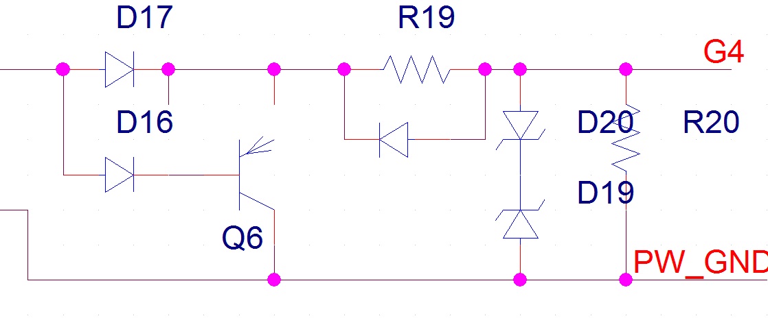

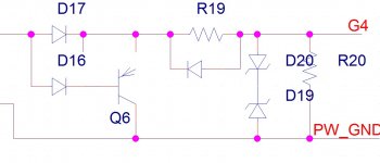

I have a problem , i need to switch two tranzistors in pararel irfp460 , each with 4nf gate capacitance ...that 8nf of total charge at 100khz , (without thincking at miller efect ) , so i did find some 9A ic's for those tranzistors , by using GDT , i will use this schematic for each pair of tranzistors, but i can't think on such PNP tranzistor (needs to be a digital one?) , can someone give me an ideea of what to find , the case is irelevant , sot 92 or anything else, and please comment about this circuit

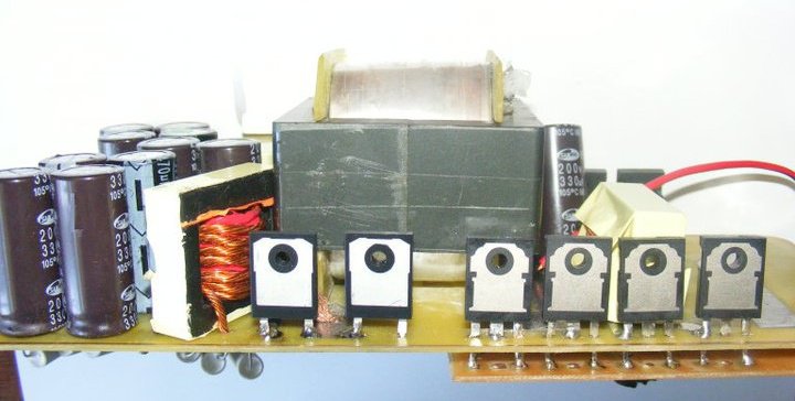

Tomorrow ill be in cluj , no i haven't tested yet @ full power , jut at 10% with 90V at input i have to make a snubber for the rectifier , so i'm limited at almost 100V . From simulations the maximum primary current is 22A , at 85%D
