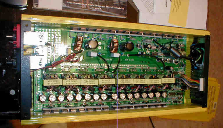

I recently bought a 1500 watt 12 volt to 120 mod sine inverter that appears to be built as the 2.5 kW supply described above in that my unit has 8 banks of two mosfets driving p-p xfmer primary with associated fuse. The mosfets on the transformers are heatsinked on the bottom side of the case as seen in this photo. I must say for a measly 1500 watt inverter this baby is really overbuilt!
In comparison I have a few Xantrex X-Power 1000 watt inverters and they contain only two such transformers of about the same size to make the 160 VDC rails for the output switches.
